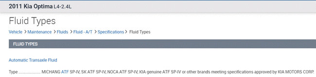

Flushed and replaced transmission fluid. Changed all solenoids. Restarted ECU by disconnecting battery and tapping negative and positive together. Typically, will work for a day or two after that with overdrive starting in first gear but then goes back to jerking with overdrive starting in fourth gear. Trying the speed sensor next. Does this car need specific Transmission fluid? Used Maxlife Valvoline ATF.

If you look at the attached pic below, it indicates the manufacturer's ATF requirements. You will need to check the label on the fluid you purchased to see if it indicates it can replace what is listed.

Let me know your thoughts. Also, let me know if the if the Maxlife indicates it can be used in place with the listing below.
See pic below.
Note: You didn't list the engine size, so I went with the 2.4L which is the most common. If it is different, let me know.
