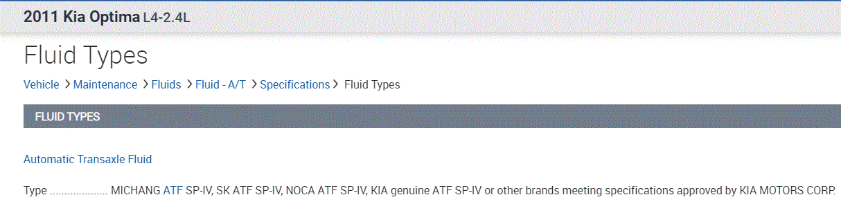

If you look at the attached pic below, it indicates the manufacturer's ATF requirements. You will need to check the label on the fluid you purchased to see if it indicates it can replace what is listed.

Let me know your thoughts. Also, let me know if the if the Maxlife indicates it can be used in place with the listing below.
See pic below.
Note: You didn't list the engine size, so I went with the 2.4L which is the most common. If it is different, let me know.
