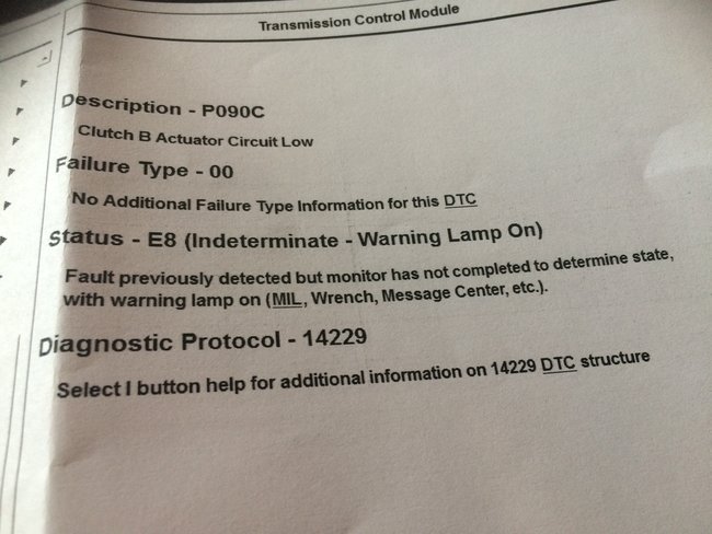

My car seems to struggle to change gear. It judders and will not go into reverse when it is doing this, if I turn the car off and leave it for a few hours it seems to correct itself but if I am stopping and starting in traffic it starts it again .

Hi Joe, thank you for your reply. Took it for a diagnostic and the result was; gearbox, code 090c clutch b actuator control circuit low. Would that still come under warranty?

Hi again. That should be covered under the power-train warranty. Contact a dealer and see what they say. If you have problems, let me know.

Hi Joe really could do with help. Will explain from the start; my car seemed to be struggling to go into gear paid for a diagnostic test and got code, gearbox code 090c . I know ford have a recall of transmission control module so took it in but after they did their diagnostics they are saying that it is code p090c clutch b actuator circuit low. Which does not come up with the recall and say it is the clutch that is going so want £1000 ($1,310.34 USD) to fix it. I do not have that kind of money. Is there anything I can do? Cheers, Maggie.

Should not be under the recall but it should still be covered under the five year 60,000 mile power train warranty.
