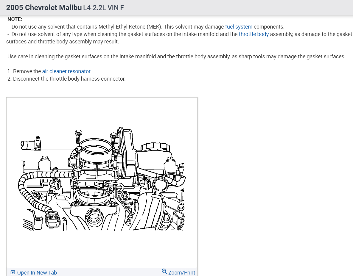

My vehicle will jerk when I'm driving with the A/C on, and it will also jerk when I am stopped at an intersection with the car in drive. if i put it in park or idle it does not do this.

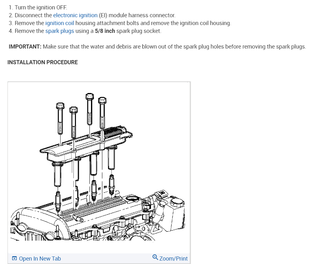

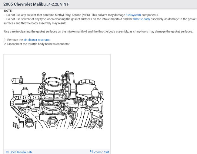

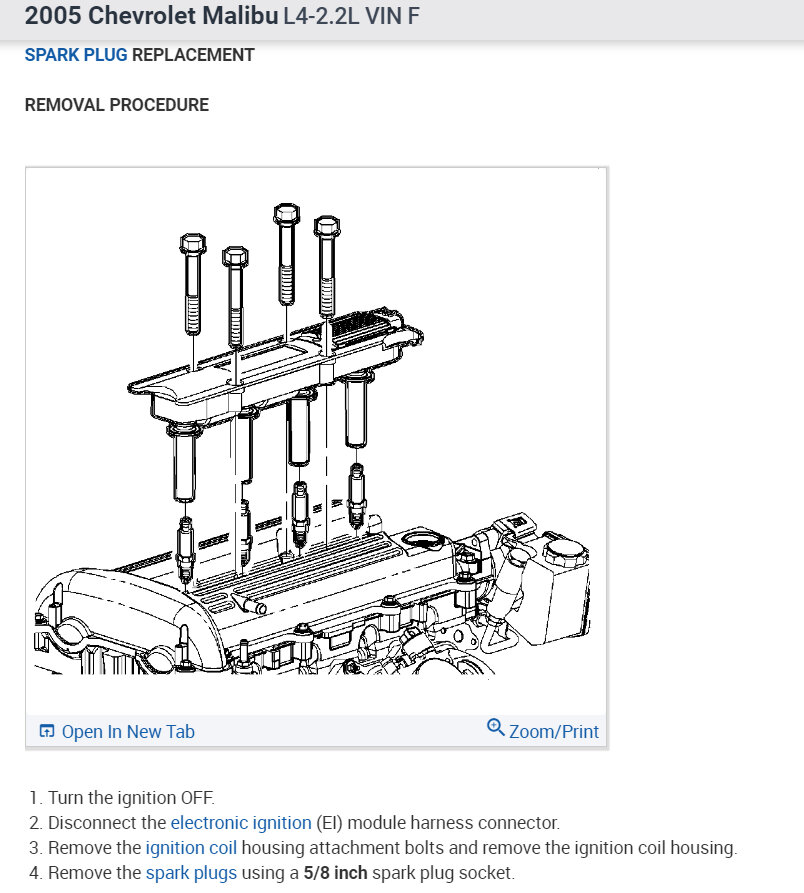

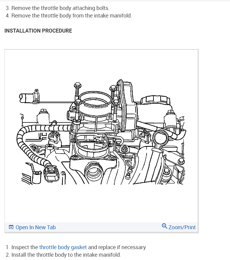

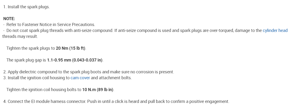

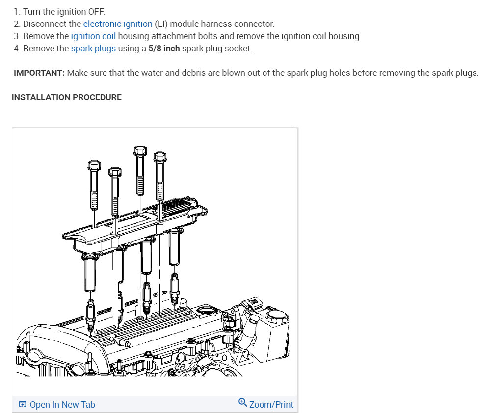

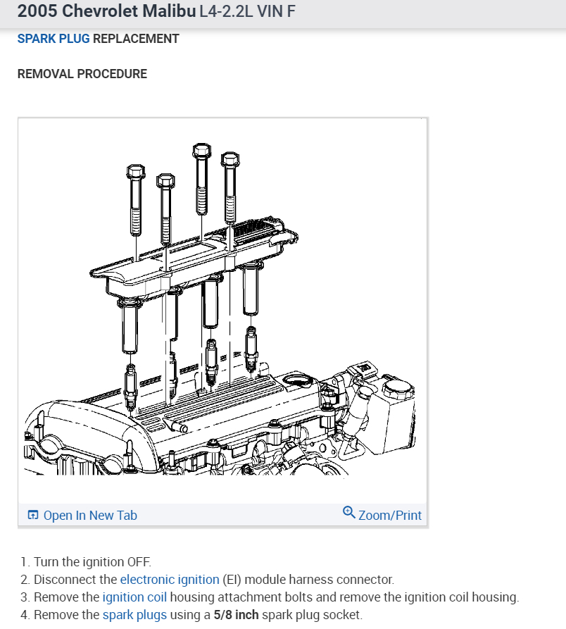

Do these jerks occur when the A/C is on only? If not, the engine sounds like it is misfiring, I would do a full tune up including serving the throttle body and replacing the coil module.
Here are two generic guides to help you fix the problem with instructions below for your car:
https://www.2carpros.com/articles/how-to-tune-up-a-car-engine
and
Spark Plug Type .................... GM P/N 12569190 (A/C DELCO P/N 41-981)
Gap 0.95 - 1.1 mm (0.037 - 0.043 in)
Torque 20 Nm (15 lb-ft)

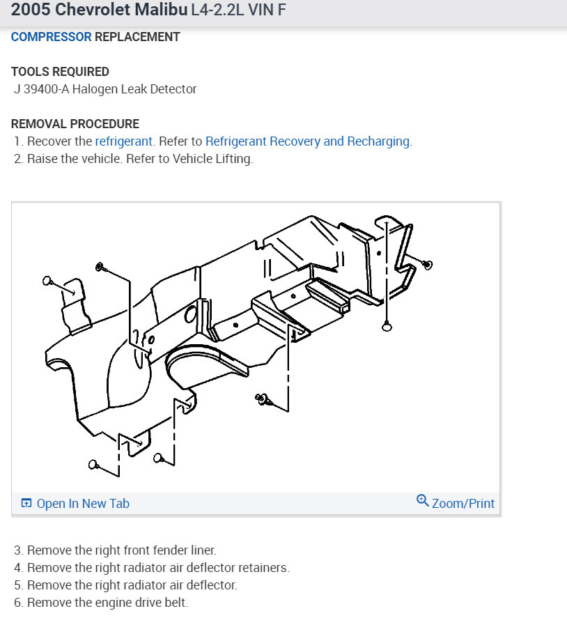

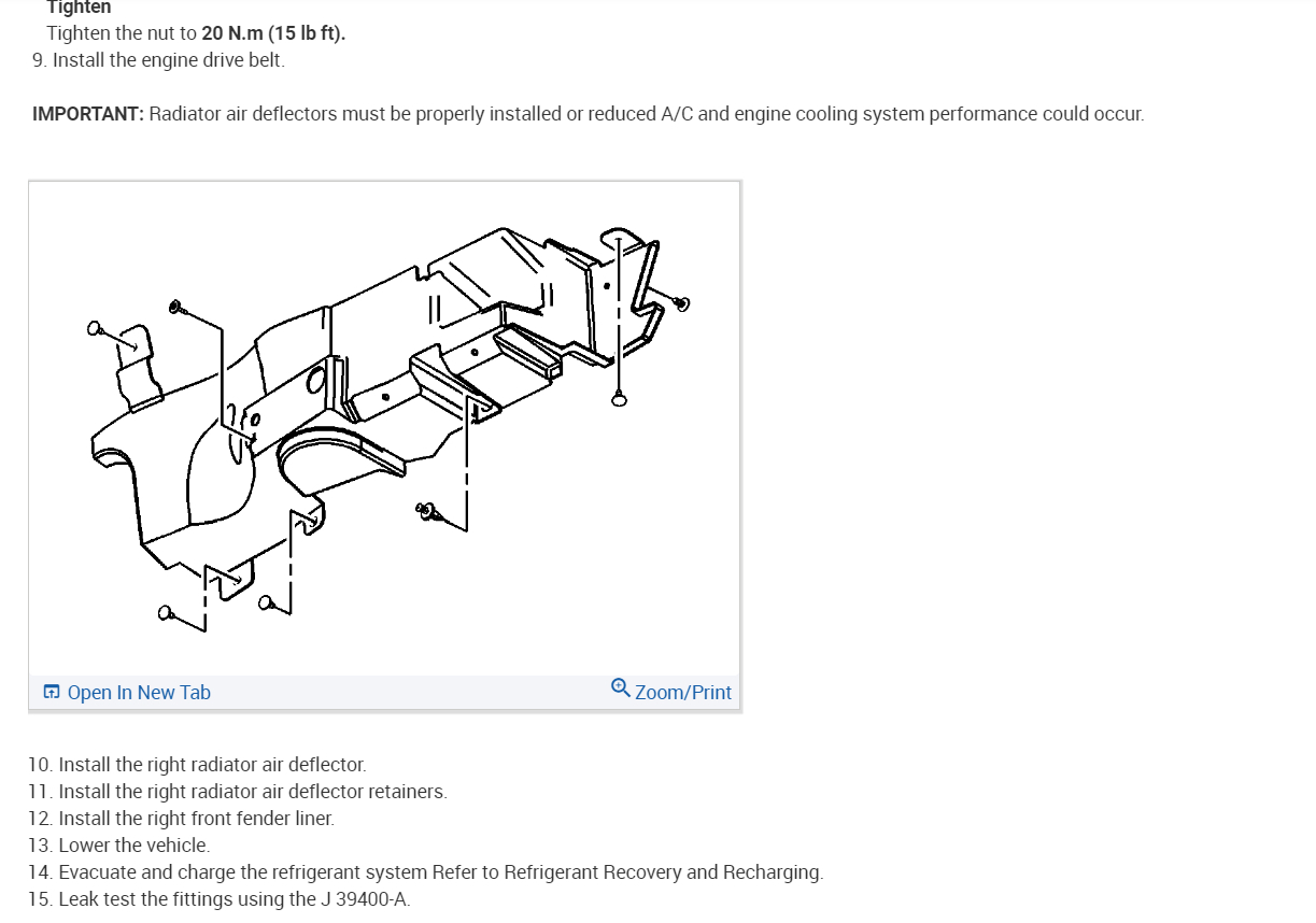

No, when the A/C is off it does not jerk at all. It runs nice and smoothly. only when i turn the A/C on, it will do it while I'm driving. and if i am parked at an intersection with the car in drive it will kick and sometimes shut off.
Jun 30, 2023 at 7:25 AM
  • 55,456 POSTS

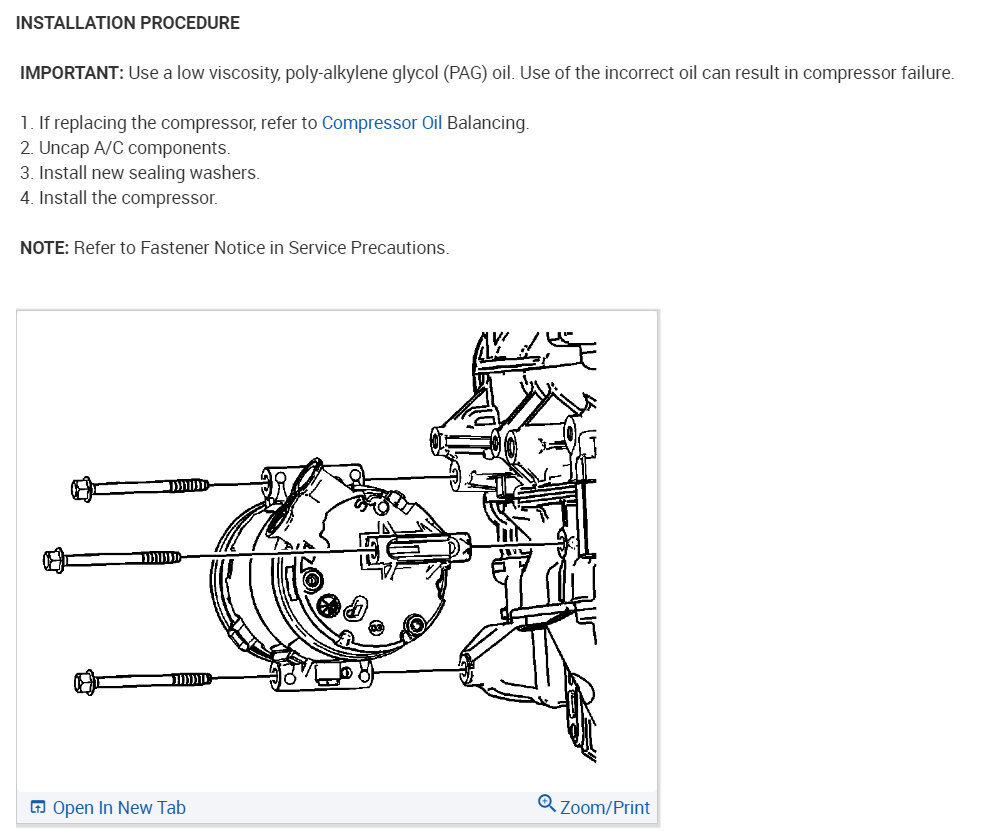

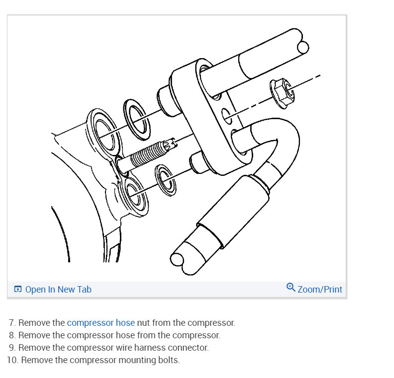

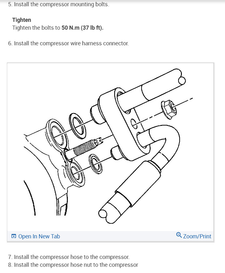

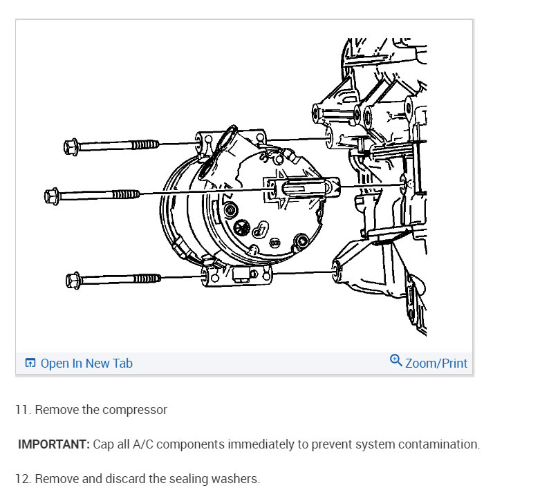

Okay, then the A/C compressor is starting to lock up, please don't run the A/C system anymore.
here is a guide to help change it out with instructions in the images below to help with your car:
https://www.2carpros.com/articles/replace-air-conditioner-compressor
and
https://youtu.be/4EqdrBVb0sY
Check out the images (below). Please let us know how it goes.
