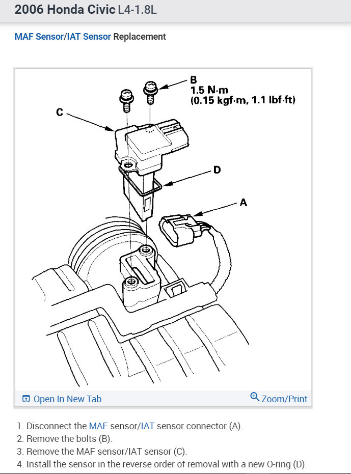

It sounds like it could be a lean issue due to leak of fuel which can be caused by a bad MAF sensor which should be replaced from time to time anyway. Here is the location so you can check it out and a guide that will walk you through the replacement:
https://www.2carpros.com/articles/how-to-replace-a-mass-air-flow-sensor-maf
