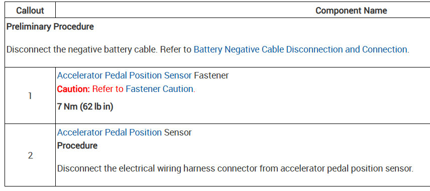

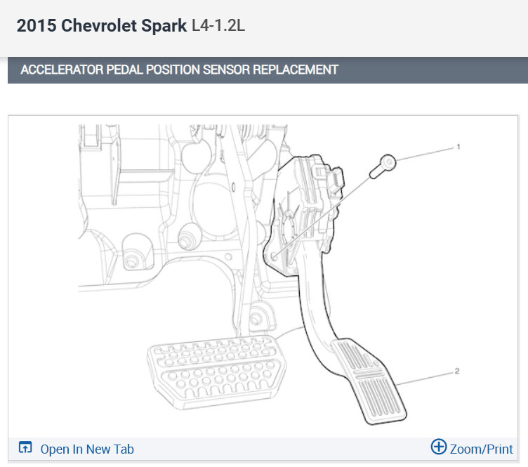

Yep, that is not a misfire, this sounds like the acceleration pedal or throttle body is bad, let runs the codes to see if any codes are stored.
Here is how to change the sensor out which is my thought, thanks for the video, it helps. Also, has this car been modified? Check out the images (below). Please let us know what happens.
