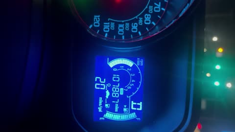

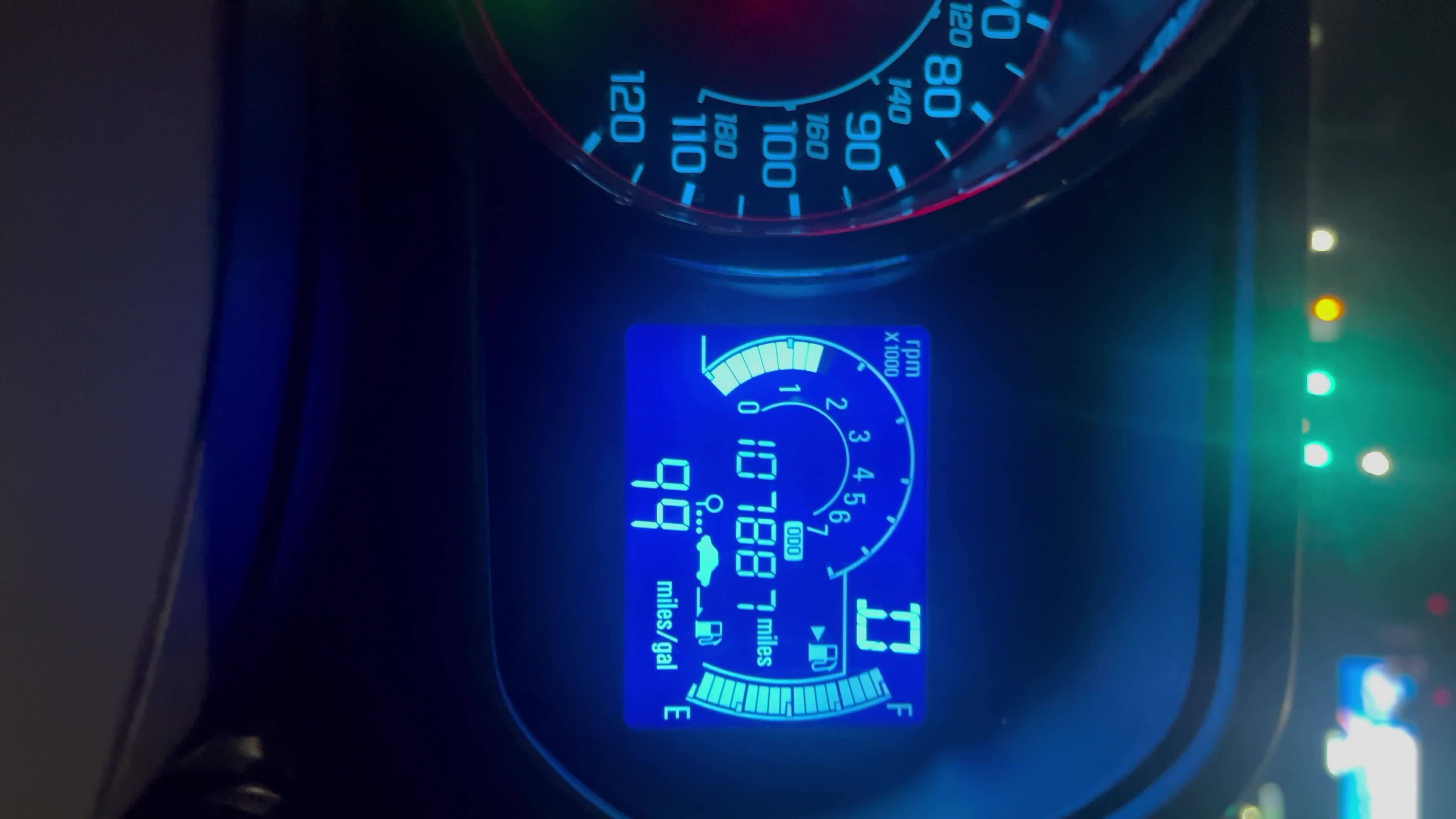

My car had recently started jerking upon an acceleration. My car had recently started jerking upon an acceleration with the engine light and traction control light turning on. I replaced the four spark plugs Which caused the lights to turn off. and cylinder one in ignition. I am still having issues with the car, jerking.

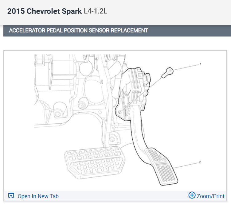

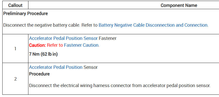

Yep, that is not a misfire, this sounds like the acceleration pedal or throttle body is bad, let runs the codes to see if any codes are stored.
Here is how to change the sensor out which is my thought, thanks for the video, it helps. Also, has this car been modified? Check out the images (below). Please let us know what happens.
