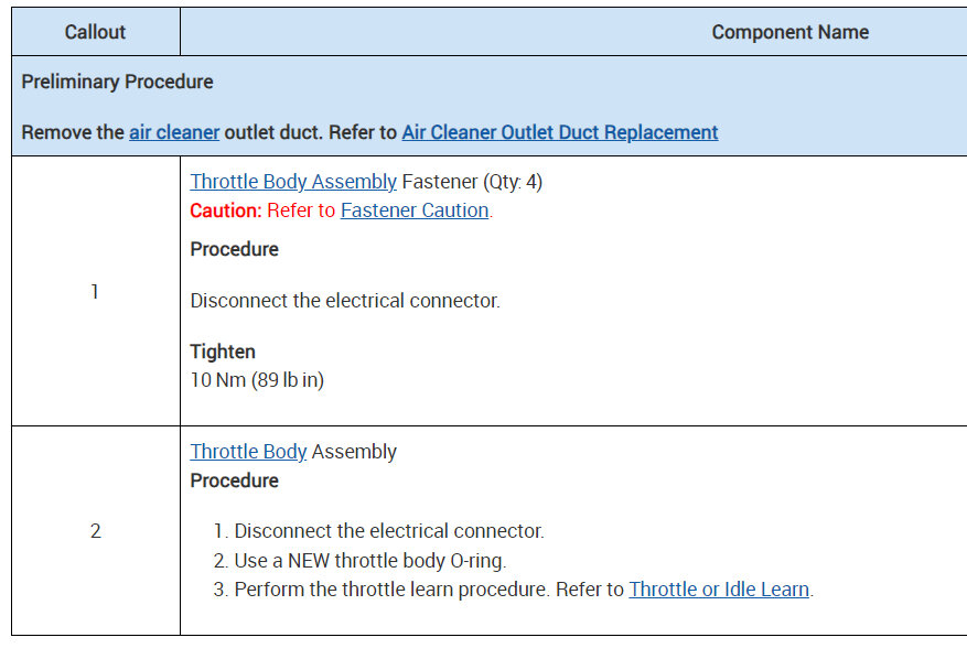

Car will cut off when letting off the gas and breaking for a stop.
Idles rough at red lights.
Headlights dimming with rough Idle.
Electric Windows (all 4) roll down fine but now will roll up an inch and stop. Then you let go of the button and press again and roll up an inch and stop rinse repeat util about midway then it rolls up normally.
I had the Battery and Alternator tested and both work.

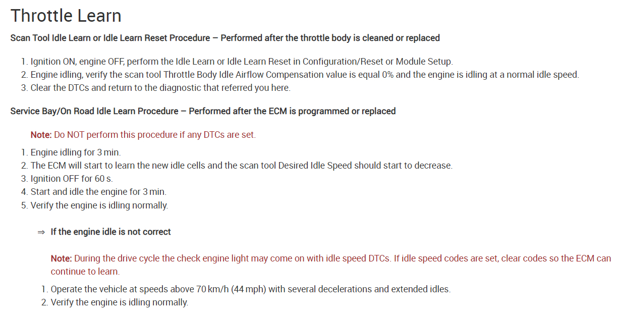

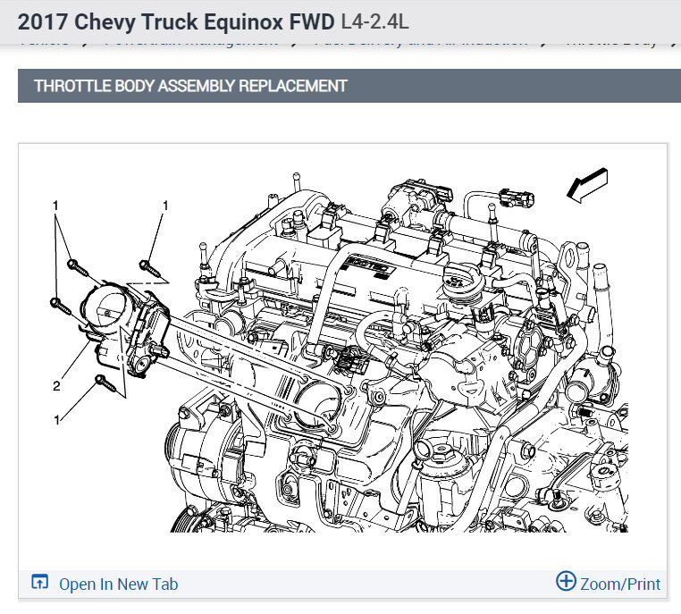

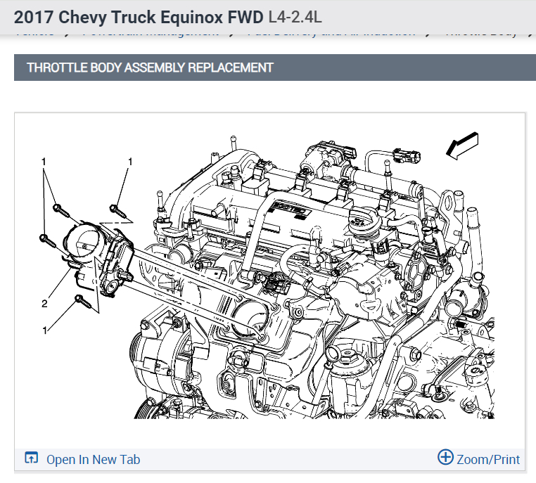

Please start a new thread for the window issue, we only handle one problem per thread. For the engine stalling at idle this is common when the throttle body needs to be serviced. Here are two guides to help us fix the problem and I have included images below to help you fix your car or see what needs to be done.
and
Can I ask if you have a check engine light on? If so, we should run the codes.
Please check the images below to see how to do the service. Check out the images (below). Please upload pictures or videos in your response to the problem so we can see what's going on. Please read the guides before you begin. And can I ask if the engine has been tuned up? (new spark plugs)?
