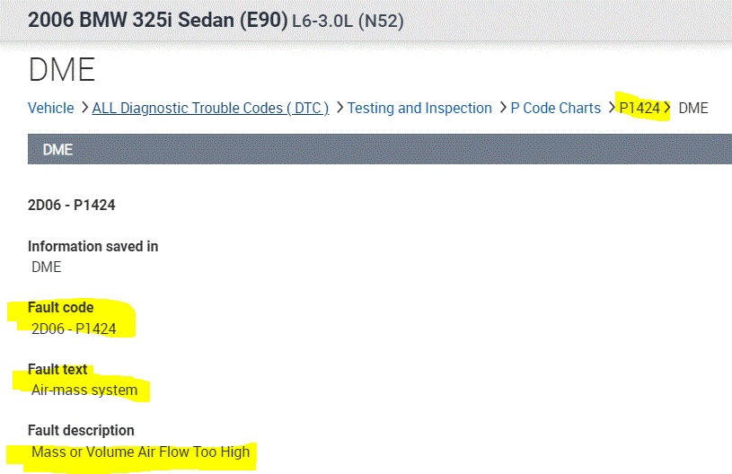

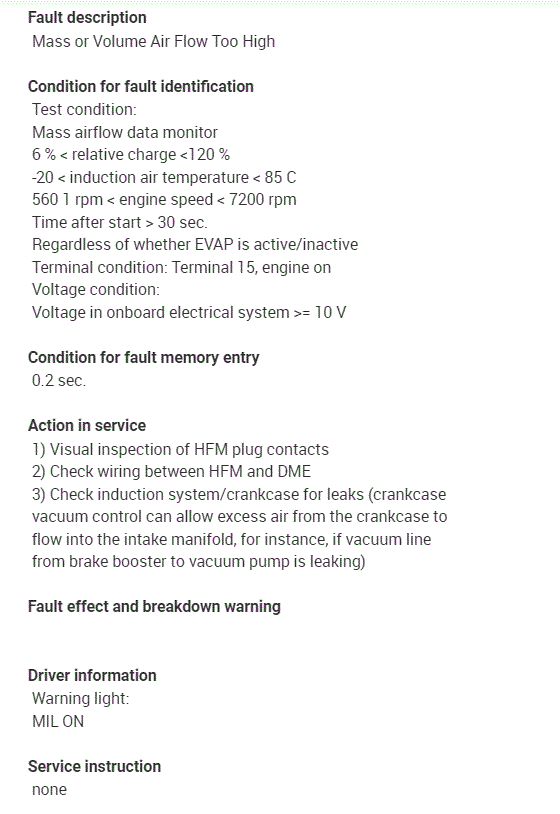

Car is reading code p1424, which I think is the MAF is bad. I'm trying to find out for sure.
Sunday, March 13th, 2022 AT 12:02 PM
MECHANIC
110,176 POSTS
The code you have is related to the MAF. You are correct. I attached the description below related to the code for your review.
Are you experiencing drivability issues? Is there anything specific happening?
