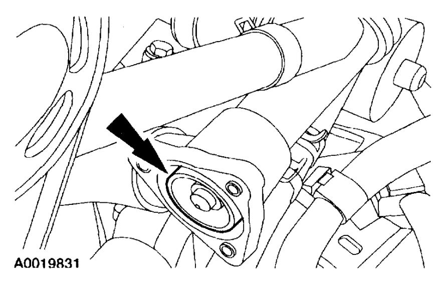

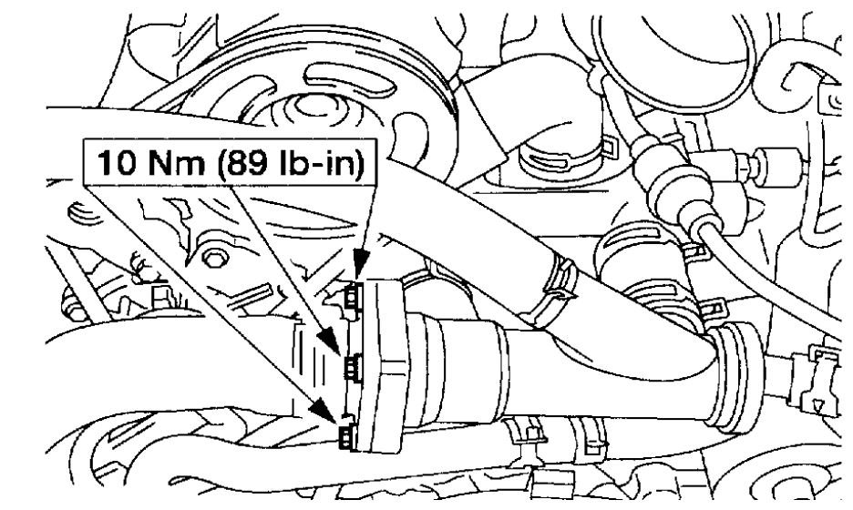

Thermostat-3.0L (4V)
Removal and Installation
1. Drain the engine cooling system.
2. NOTE: The appearance cover is shown removed for clarity. Separate the thermostat housing.
3. Remove the thermostat and the O-ring seal from the thermostat housing.
4. NOTE: Clean and inspect the sealing surfaces.
To install reverse the removal procedure.
