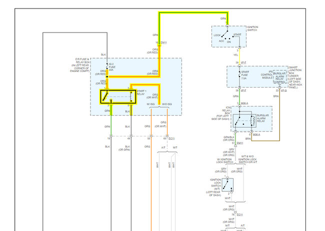

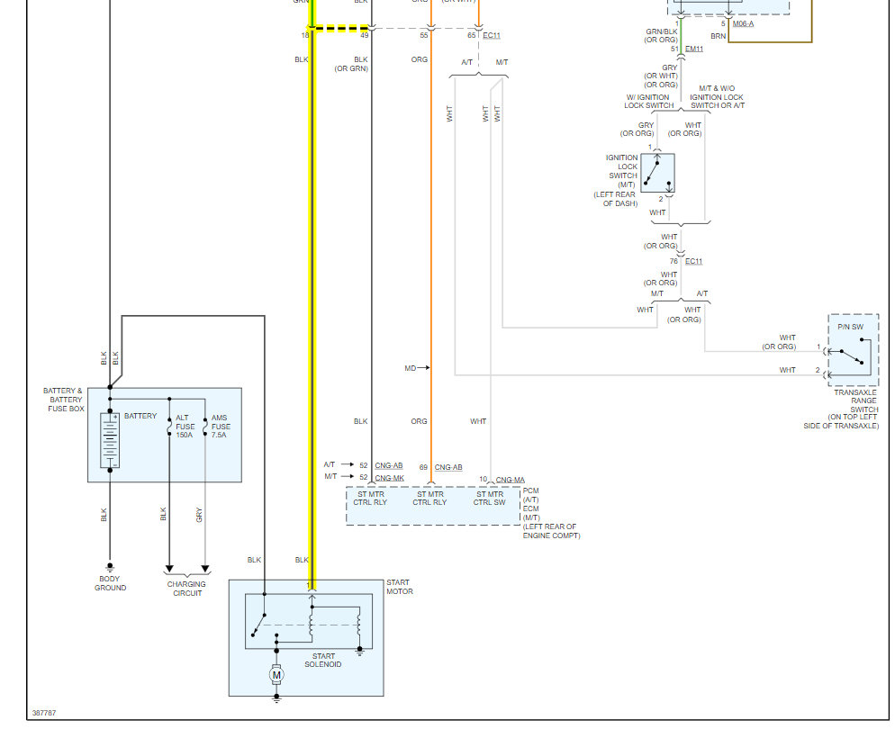

I attached a wiring diagram for you to view. You will need to verify power to the starter solenoid when in the start position.
You will need a voltmeter or test light for the testing.

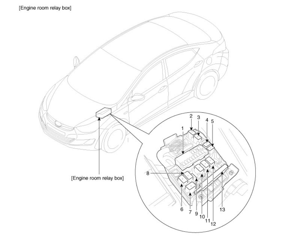

  • 375 POSTS

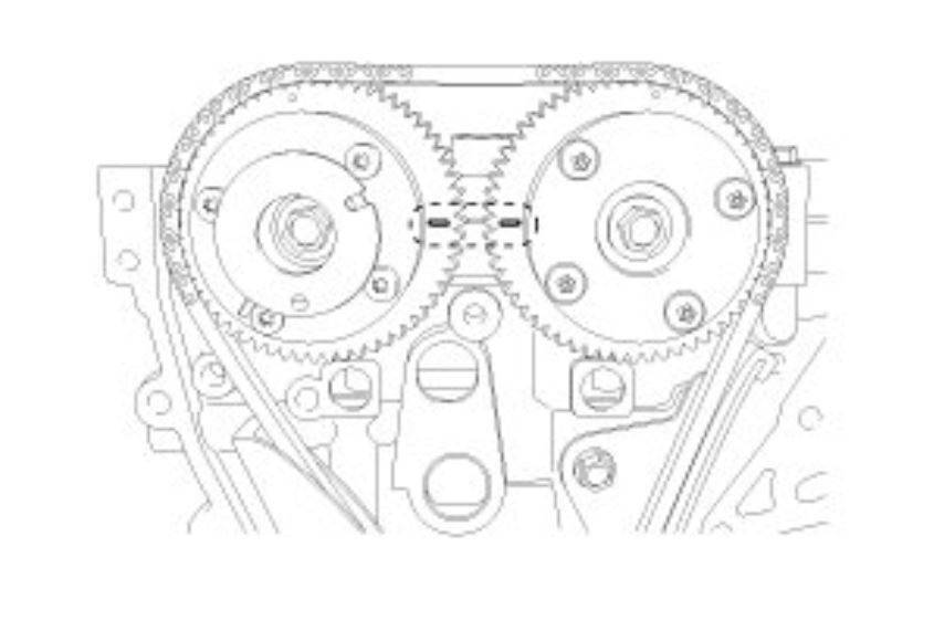

So far I checked the fuses and relays there fine. I even replaced the ECM relay and ECM used though and made sure the part number matched. Replaced the crankshaft sensor and whole distributor. But doesn't turn over. The cranking sounds a bit better but no start. I want to make sure I have the spark plug wires correct to the distributor cap. The firing order is 1324 and its counter clockwise on the distributor cap. From bottom right is number 1 spark plug wire starts. But since I can't start the car to use the timing light. How can I set the timing right?
Mar 20, 2021 at 11:56 AM

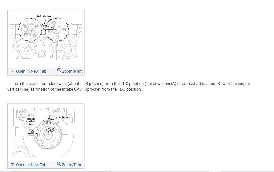

You do not use a timing light at all. You have to remove the front cover and inspect the marks.
You can check easier by doing a compression test. If the compression is low, it could be the timing belt.
https://www.2carpros.com/articles/how-a-timing-belt-works
The firing order is 1-3-4-2
Firing Order
Firing Order .................... 1-3-4-2
I attached pictures of the timing marks for you below.

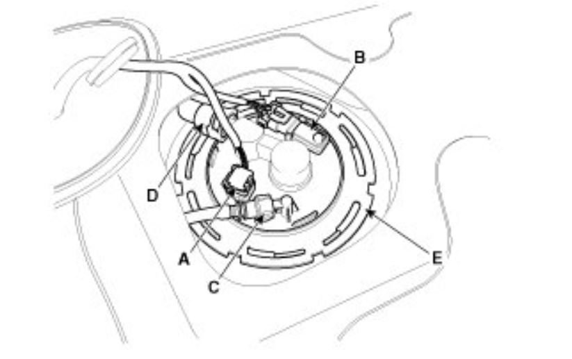

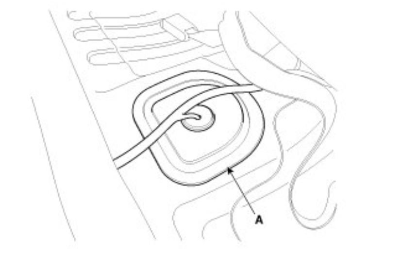

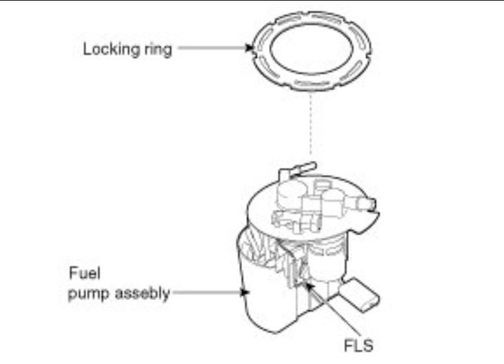

Did you check the fuel pressure to verify the pump is the failure? I attached a guide for you on checking the pressure.
https://www.2carpros.com/articles/how-to-replace-an-electric-fuel-pump
Also, if you spray some carb cleaner or starting fluid into the air filter, does it start and stall?
Removal
1. Release the residual pressure in fuel line .
2. Remove the rear seat .
3. Remove the fuel pump service cover (A).
4. Disconnect the fuel pump connector (A) and the fuel tank pressure sensor connector (B).
5. Disconnect the fuel feed tube quick connector (C) and the vapor tube quick-connector (D).
6. Remove locking ring (E) by using the service tool.
7. Remove the fuel pump from the fuel tank.
Installation
1. Installation is reverse of removal.
CAUTION:
Be careful of fuel pump direction when installing.
Fuel pump plate cover installation bolt [2DR LEV2]:
2.0 - 3.0 N.m (0.2 - 0.3 kgf.m, 1.4 - 2.2lb-ft)
Fuel Pump Plate Cover Installation [2DR SULEV]:
78.5 - 98.1 N.m (8.0 - 10.0 kgf.m, 57.9 - 72.4lb-ft)
Mar 22, 2021 at 9:48 AM

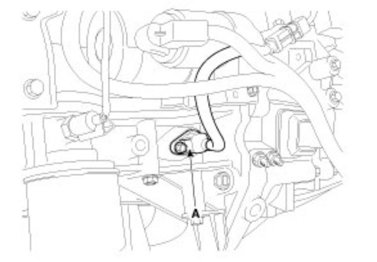

Okay, when you crank the engine, does the tachometer move up a little showing RPM? That will tell me if the crank sensor is working.
Inspection
1. Check signal waveform of CKPS and CMPS using a scan tool.
Specification:Refer to "Waveform"
Removal
1. Turn the ignition switch OFF and disconnect the battery negative (-) cable.
2. Disconnect the crankshaft position sensor connector (A) and remove the sensor after removing the installation bolt.
Installation
CAUTION:
- Install the component with the specified torques.
- Note that internal damage may occur when the component is dropped. If the component has been dropped, inspect before installing.
CAUTION:
- Apply the engine oil to the O-ring.
- Insert the sensor in the installation hole and be careful not to damage.
Crankshaft position sensor installation bolt:
9.8 - 11.8 N.m (1.0 - 1.2 kgf.m, 7.2 - 8.7 lb-ft)
Mar 22, 2021 at 9:23 PM
AZDANNO04
  • 375 POSTS
This is for the 1998 Nissan Sentra GXE 1.6 liter GA16DE. How do I input my VIN # into the ECM that I purchased used? I do not have a tach for Rpms on my dash. I replaced the crankshaft sensor. I noticed there wasn't an O-ring for it. Not even on the old part.
