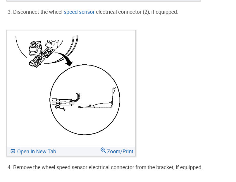

Okay, so I'm not sure how to describe this, I can make a video soon for it but from a stop my car will make a mildly loud creaking or heavy tapping noise this was before and after an oil change, brake, and tire change it seems every week it gets more noticeable. My other concern is I've had my ABS looked at and now the light comes on just before traction control and ABS just completely shut off.

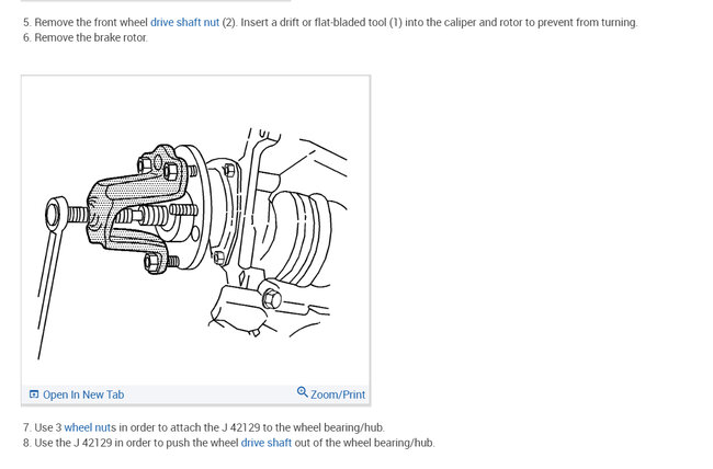

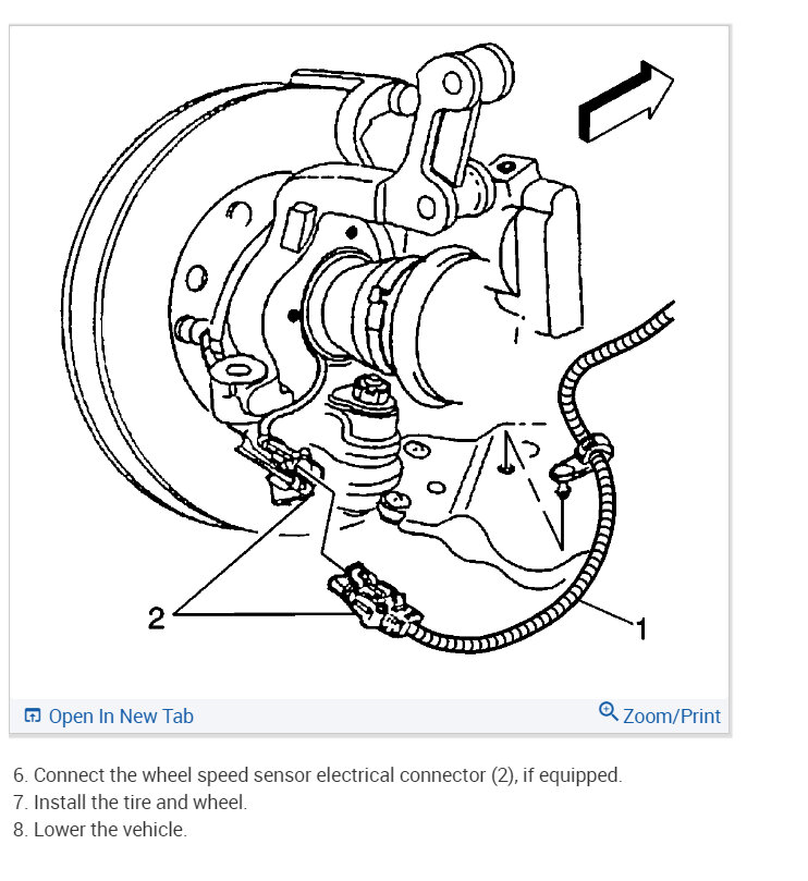

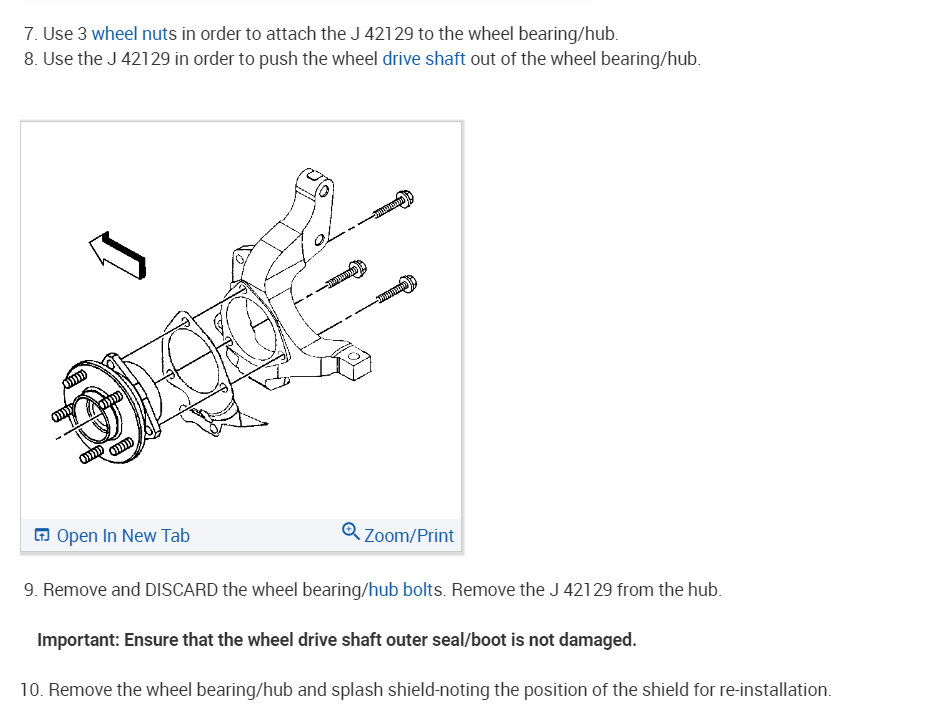

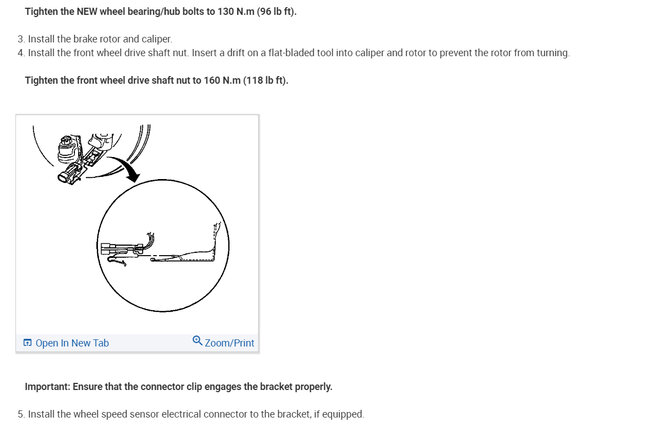

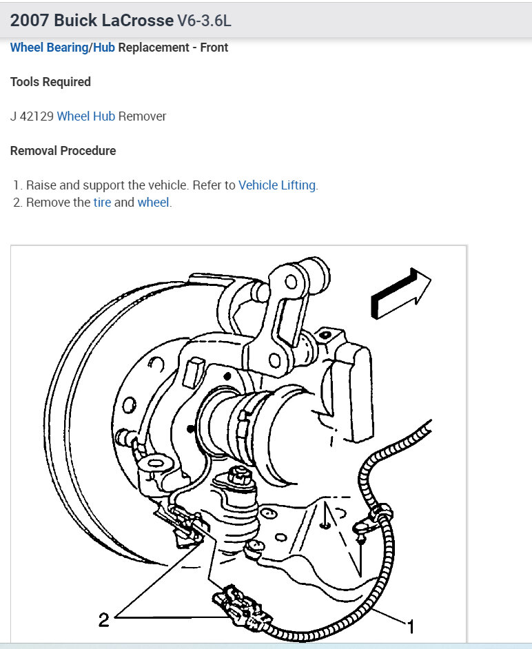

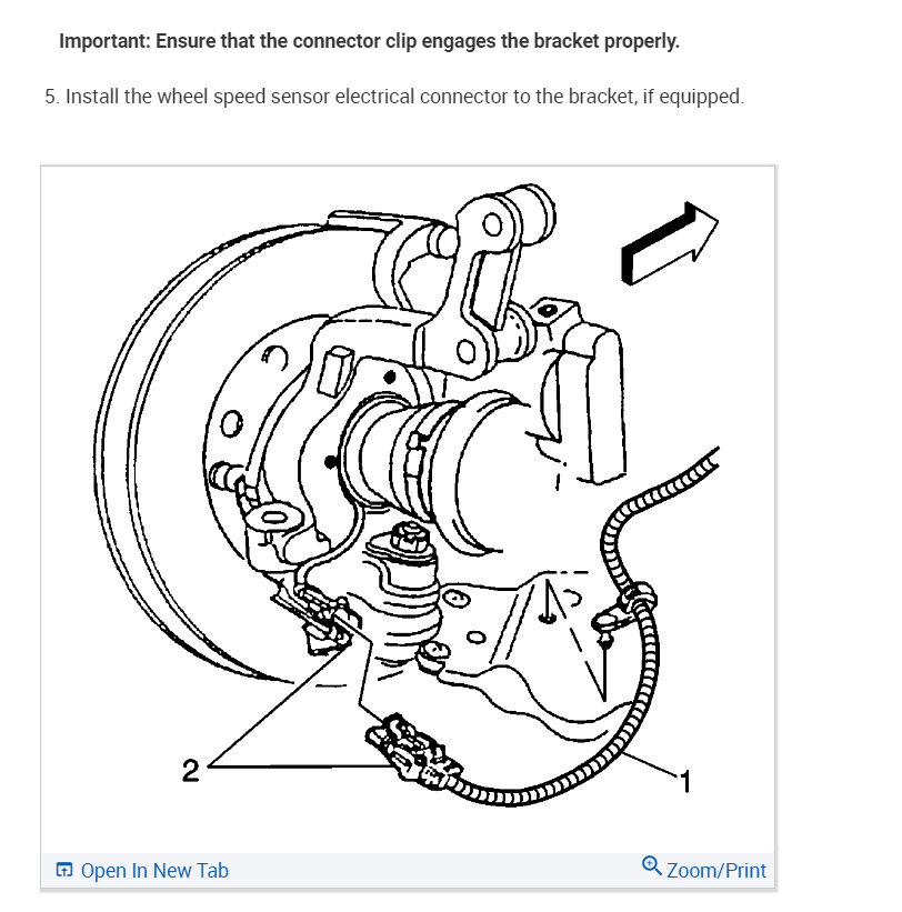

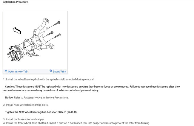

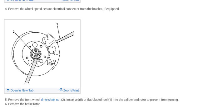

The ABS light is the clue, when a bearing hub is going out it will make a creaking noise, but to be sure please upload a short video of the noise. The ABS light goes on because the bearing hub holds the sensor, and it becomes misaligned. Tell you tell from the left or right of the car? Here is how to change the bearing hub out so you can see what needs to be down to fix the car. You can get the part from Rockauto or AutoZone.
