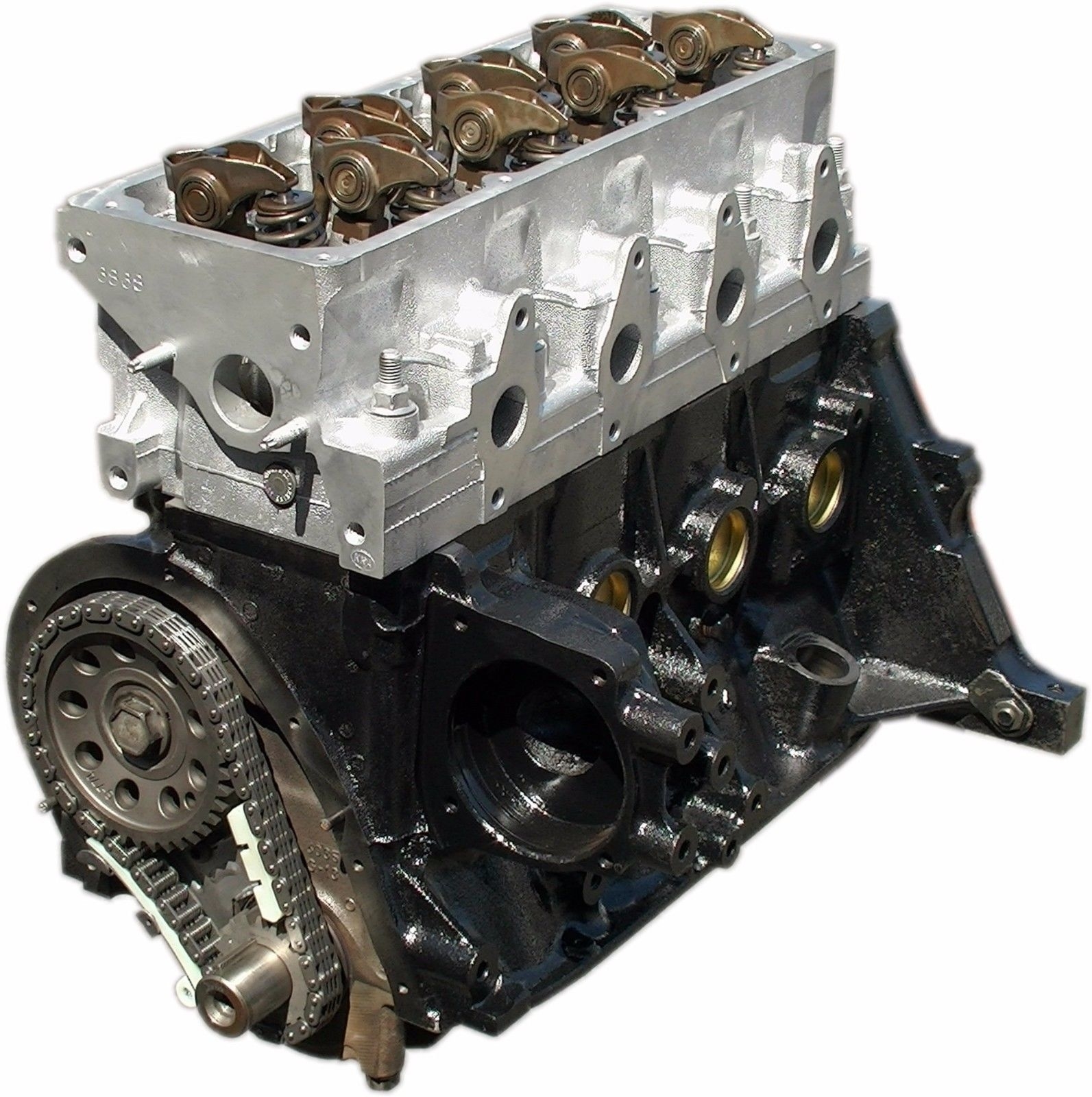

Okay, if you add coolant does it run back out with the engine off? Or do you have to start it? Is it forming a puddle under the car? If yes where is the puddle? If you do not see it there, run your hand over the passengers side carpet up in the foot well, if i is wet then you have a bad heater core.
There are core plugs in multiple locations on the cylinder block, three are in line with the water pump down the side of the engine, another is inside the bell housing in the rear of the block.
(The gold items in the picture)
