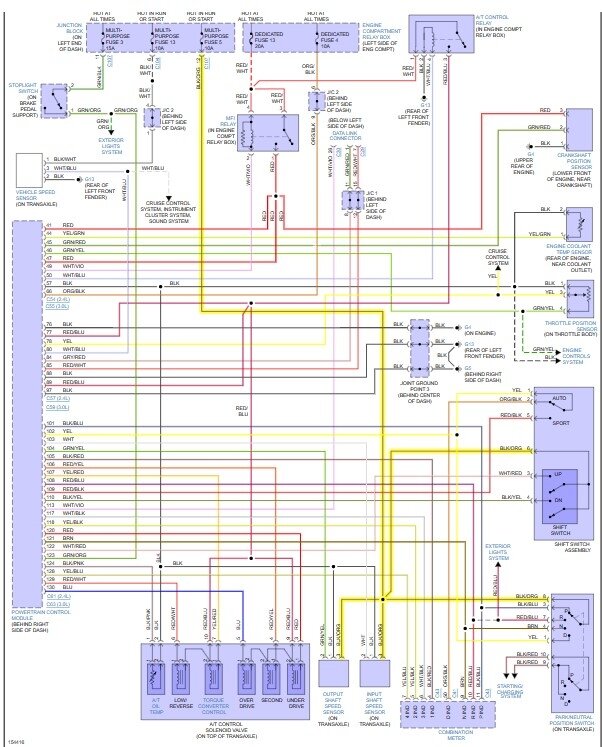

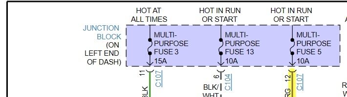

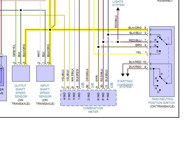

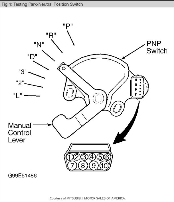

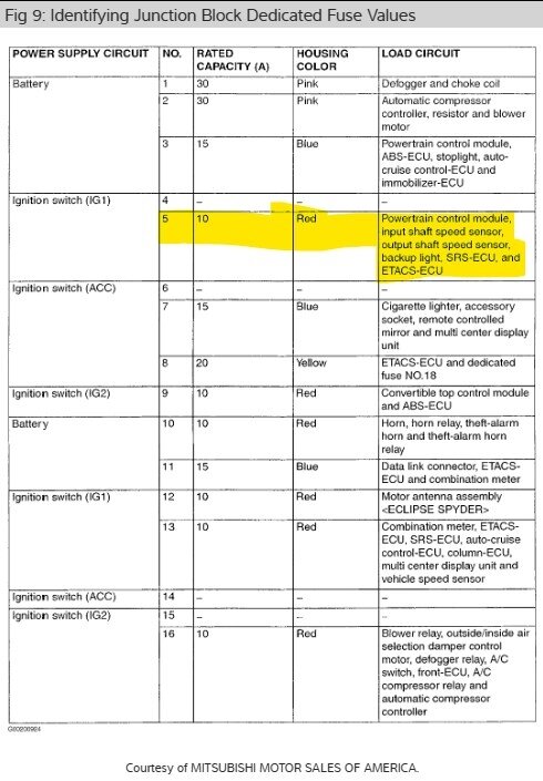

While looking at a wiring diagram for your vehicle I noticed that the Output Shaft Speed Sensor, Input Speed Sensor and the Park Neutral Position Switch all share one wire in particular. A black wire with an orange tracer/stripe. Then when I read you have nothing on the dash telling you what PRND mode you are in I was thinking more the PNP switch.

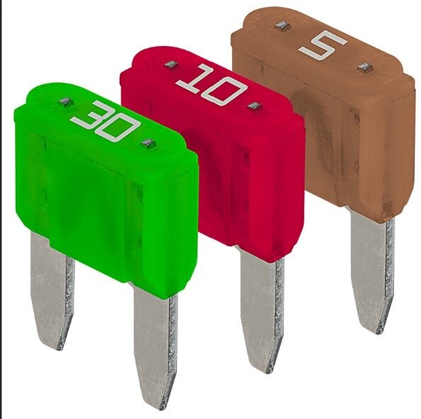

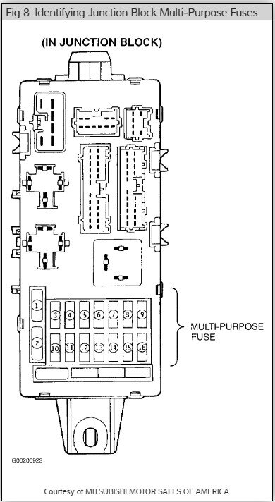

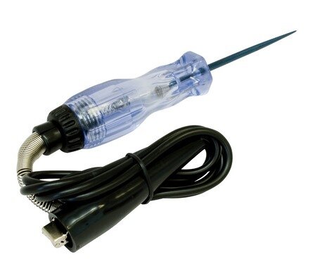

So, it may be the harness itself or the Park Neutral Position Switch. Both are very likely. A shorted harness should blow the fuse so I would start by checking the fuse with a test light. It should be fuse #5 will be a red 10 AMP. This panel is located in the passenger compartment on the left side of the dash.

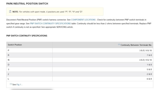

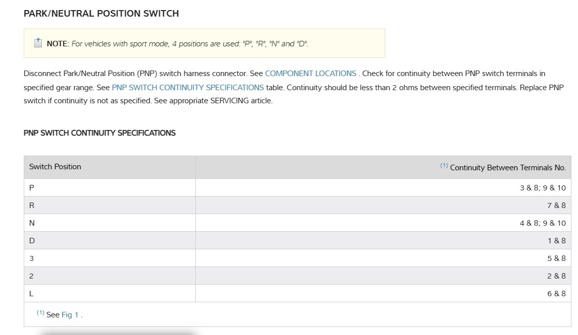

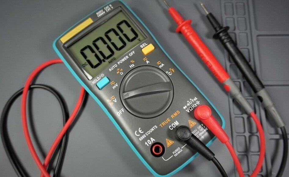

Since you mentioned that you think reverse hasn't been showing up for a while that may have been this PNP switch going. So next I would unplug the PNP switch. It is right on the transmission. I have included a diagnostic chart for this switch. I would chock the tires, so it doesn't roll on you and test continuity in each shift position. Do this with the switch unplugged instead of back probing the connector because a continuity test induces a voltage and can short things out like the PCM. You will also need a Digital Volt Ohm Meter to conduct this test. If you don't have one, you can find it at your local auto parts store. I will add a picture of this tool for you.

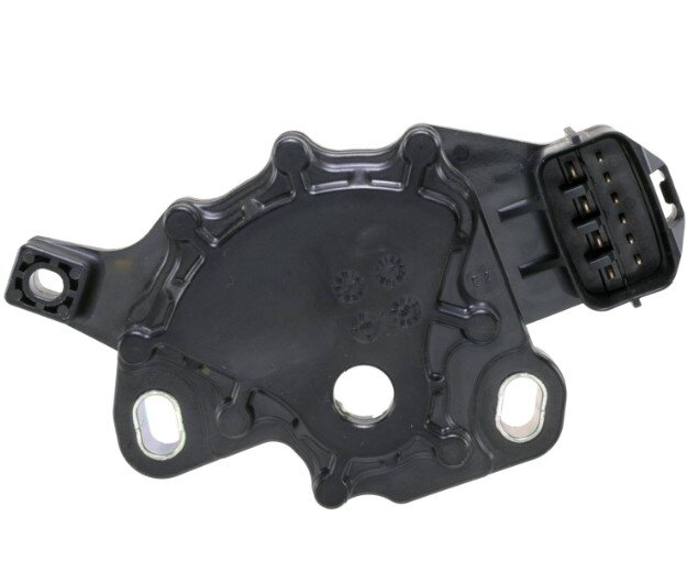

Thank you for the very helpful response, Brendon. Could you give me the part number and/or official name of the park neutral switch for my eclipse? From a quick search online, a Park Neutral Switch didn't come up for my vehicle. But a Neutral Safety Switch came up. I presume this is not the same thing though. Anyway, what you're saying makes sense. Based on the codes and behavior this seems to be a wiring or sensor issue rather than a bad transmission. After all I'm still able to drive the car, so the transmission isn't completely out.

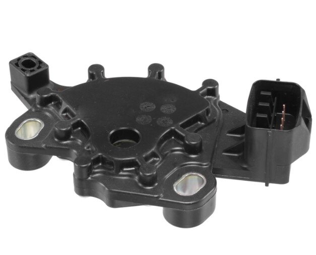

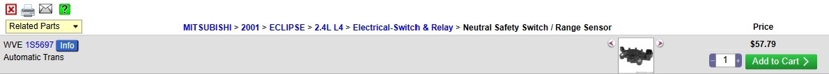

You are very welcome. Neutral Safety Switch might be built into this, but another name would be Range Switch. Some vehicles have a range switch on the transmission and the Neutral safety switch is built into the shifter itself. I found one on RockAuto for you I will add a couple of images for you.
Their part number is 1S5697.
I have never purchased this brand before so I can't speak on their behalf. It does come with a 3 year/36,000-mile warranty though. Price is $57.59 plus tax and shipping.
This is the Mitsubishi part number I found 8604A011
This is the part number my tech reference is giving me so it may not be up to date. If you want to go with Mitsubishi, I would call your local dealer and give them your VIN number. My information is telling me this part is around $103.00.

I appreciate the info, Brendon. I have found the part locally for $88.00 Duralast Neutral Safety Switch JA4312 at AutoZone. How difficult is it to replace this switch?

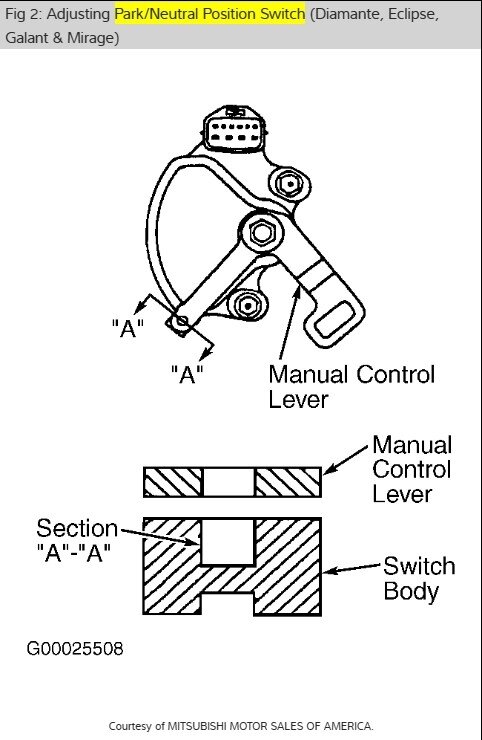

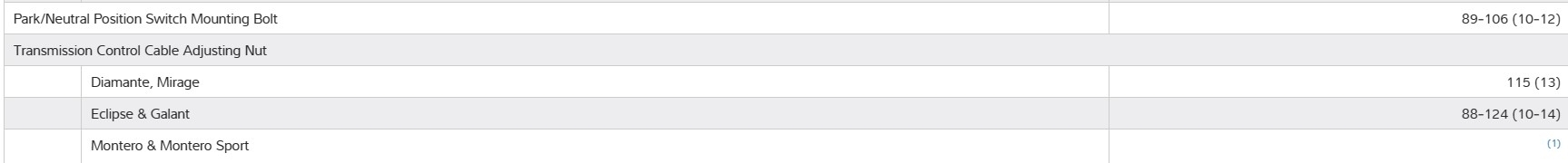

I would say it is an easy-moderate job. The biggest thing is making sure it is lined up. I would use a sharpie and mark as much as you can like bolt positions and maybe even trace around it if you can, so it lines up perfectly. I am adding the removal and installation procedure for you that should help as well as torque specs.
It is your choice, but I strongly advise doing some testing on it first before replacing it and I would definitely stay away from Duralast. Their parts have always given me nothing but issues but that is your choice as well. I recommend going to NAPA or the dealer. Dorman has come a long way and would be a good choice as well. The last thing you want is issues and have to replace the part again or it not actually be the issue and waste your money. Just my advice. Trying to help the best I can.
It might be a good idea to use some blue thread lock on the mounting bolts, so nothing loosens up on you down the road.
* Note the torque specs that are given are in inch pounds. *

Okay so here's an update: I inspected the wiring and the harnesses by the Neutral Safety Switch and didn't see any exposed wires or anything suspicious. I checked the #5 10 Amp fuse you mentioned, and it was indeed blown. So, I bought some new fuses and replaced it. Everything was working normally again for a little while after that. By the way, P R and N all display properly on the dash, it's D / Drive that's not displaying on the dash. So, it would seem it's gone out since it is the most used position on the shifter. Anyway, I drove it around a bit and when I got on the freeway when I hit about 60 mph and then had a really hard gear shift and I knew that the fuse had blown again, because the SRS airbag light came on again which happened before since it's on that same fuse. And the PRND lights stopped showing again on the dashboard and I was back in limp mode.
I ended up buying an OEM Neutral Safety Switch Product ID: 8604A011 from Mitsubishi Parts Warehouse for $85 shipped since you recommended against the Duralast brand. The part clearly needs replacing since it's nearly 250,000 miles old. Is it feasible that it's the Neutral Safety Switch that's sending out a voltage spike when switching to gear 3 or 4 at about 60mph? Perhaps the switch is shorting itself out due to age? You seemed to think it would be caused by a shorted wire or something, but I saw no evidence of that.

All 3 of these codes are for a short circuit or open for 3 different sensors that share a single wire that goes to a fuse that is blown.
It is definitely possible the switch is shorting out internally or has excessive resistance. Then popped the fuse and since that same fuse gives power to the other 2 sensors you have codes for, the PCM set codes for all 3 components in the circuit since all 3 now have no power.
