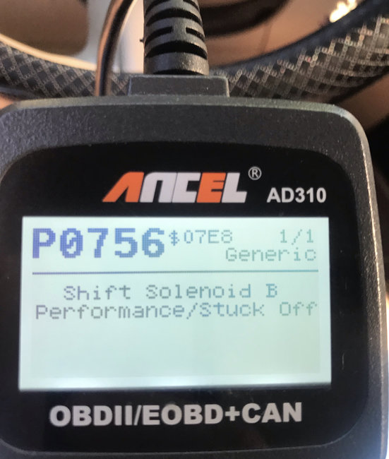

Code P0756 code says it’s Shift Solenoid B?
2010 FORD ESCAPE
150,000 MILES • 2.5L • 4 CYL • 2WD • AUTOMATIC
NAECO82
Hello, my vehicle listed above is not going into gear properly (delayed shifting) and then shifting very hard when it does go into gear. The mechanic flushed the transmission and put in new fluid, but this did not resolve the issue. The code says it’s Shift Solenoid B. I’m prepared to try and fix this myself, but I need diagrams as to where this part is located/how to service it. Thank you in advance for your help.

Yep, this is common, you should plan on doing a transmission service as well when you have the pan off, use ford parts when doing the repair. Also, you will need to raise the car up to do the job here are two guides that can help you with the solenoid B replacement instructions in the diagrams below.

Thank you, Ken. Do you know of any special tools this will require?
Jun 9, 2022 at 2:02 PM
  • 55,423 POSTS
You are welcome. Just the alignment pins for the valve body check out the first diagram in the post above. Please let us know how it goes.
