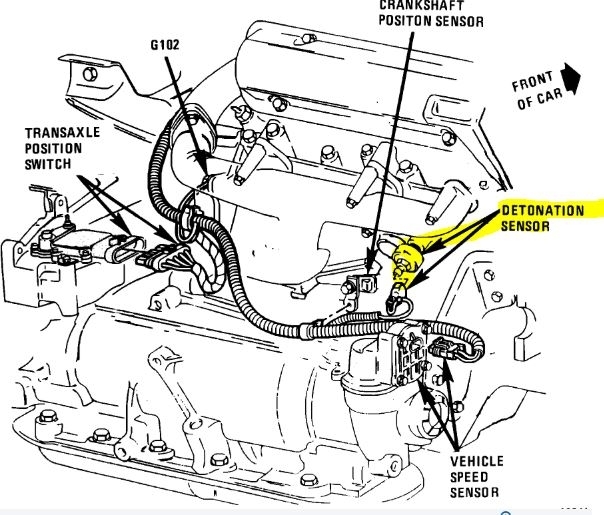

It begins when i start it up and while driving it bucks rough at 35 to 40 miles an hour. when i give it more gas it runs fine the car has stalled at stop sign when i pressed the gas pedal but starts right back up. the car will run fine without bucking at times. i have been told it could sensors, motor mounts,etc. the motor mount because car jerks when put in drive. thank you for any help Chyanne

Hi, i did the test and got codes 11 and 13. i don't see a code 11 but code 13 is oxygen sensor. where is that located on my car? Thank you for your help.

Hi, i forgot to add code 43. I know the knock sensor code would come up because i don't have a knock sensor on the car because my neighbor mistook it for another sensor and busted it off the car. i need to replace that too. how many 02 sensors are on the car and what should i ask for at the parts store?

I have a feeling the knock sensor is what is causing the problem. The computer uses the knock sensor to adjust ignition timing. If it isn't working, it is the most likely cause.
If you look at pic 1, it shows where the knock sensor (detonation sensor) is located. That needs done first. I say first because the knock sensor could be causing issues with the oxygen sensor.

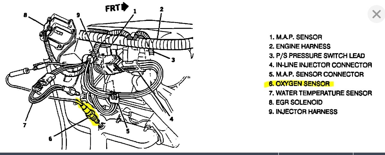

There is one o2 sensor and it is located on the exhaust manifold. See pic 2. These sensor can become corroded and very difficult to remove, so two things. First, there is a special socket designed for removing them because of the wiring harness that come off them. See if the parts store will lend you that tool. Second, when you install the new one, I recommend using anti-seize on the threads of the new sensor before installing it.
One last thing, the code 13 indicates an open circuit to the o2 sensor. That means there is no connection. Before replacement, make sure the connector is properly plugged in and no wires are broken. The sensor could be fine but disconnected. And now that I think of it, the knock sensor wouldn't cause that to happen.

hi, i had an estimate to check the 02 sensor and was told that my car has four 02 sensors. are they wrong? he said that it has two upstream and 2 downstream. thank you for your help.

You know, I just looked again at the manual and the only one indicated is the picture I sent. However, there should be one in each exhaust manifold. Those are the upstream and then there has to be two down stream. However, I checked two different manuals and they show one.
If you can, look at the picture I sent. That is the exhaust manifold. See if both exhaust manifolds have one. Then, the down stream should be after the catalytic converter.
I have to be honest, saying there are 4 makes sense to me, but the manuals say different. It's been awhile since I worked on one. See if you can locate the others he is referring to.
