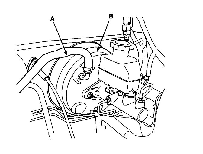

The car is shutdown after few minutes, or during when brake press.
And the car is not powerful .
Jul 22, 2023 at 4:32 AM
  • 110,236 POSTS

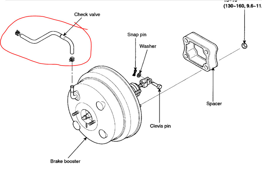

It sounds like you may have a vacuum leak at the vacuum brake booster. The booster is mounted directly behind the brake master cylinder.
Check to see if the vacuum hose is leaking or if you notice a hissing when the engine is running.
