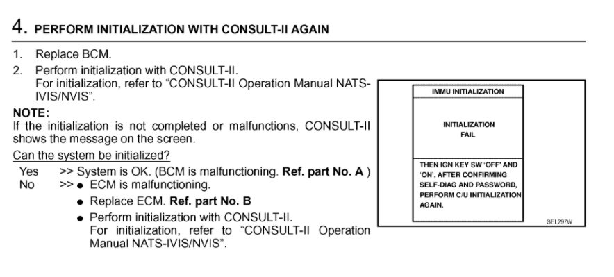

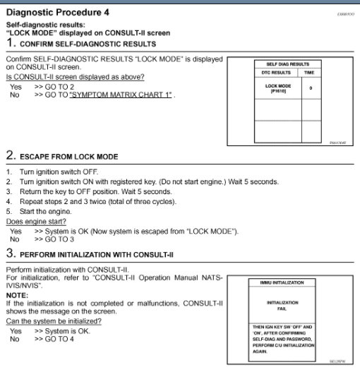

Car in lock mode code came up p1610.
Jul 30, 2017 at 4:55 AM
DANNY L
  • 5,648 POSTS
Hello, I'm Danny.
Apparently this 'lock' code affects the BCM- body control module and the ECM- engine control. I've attached 2 diagnostic step pictures below for you car. These steps should help you determine the fault. Hope this helps and thanks for using 2CarPros.
