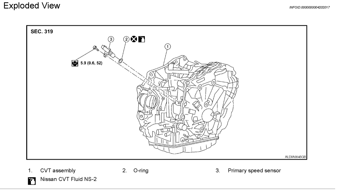

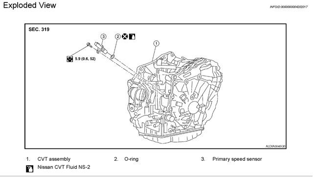

I just had the exact same problem with my 2009 Nissan Rogue. No alerts on dash. Felt it missing. Pulled right over. From there, it would not drive or reverse. So I installed a input shaft speeds sensor and it worked. Here is the sensor I replaced (below).

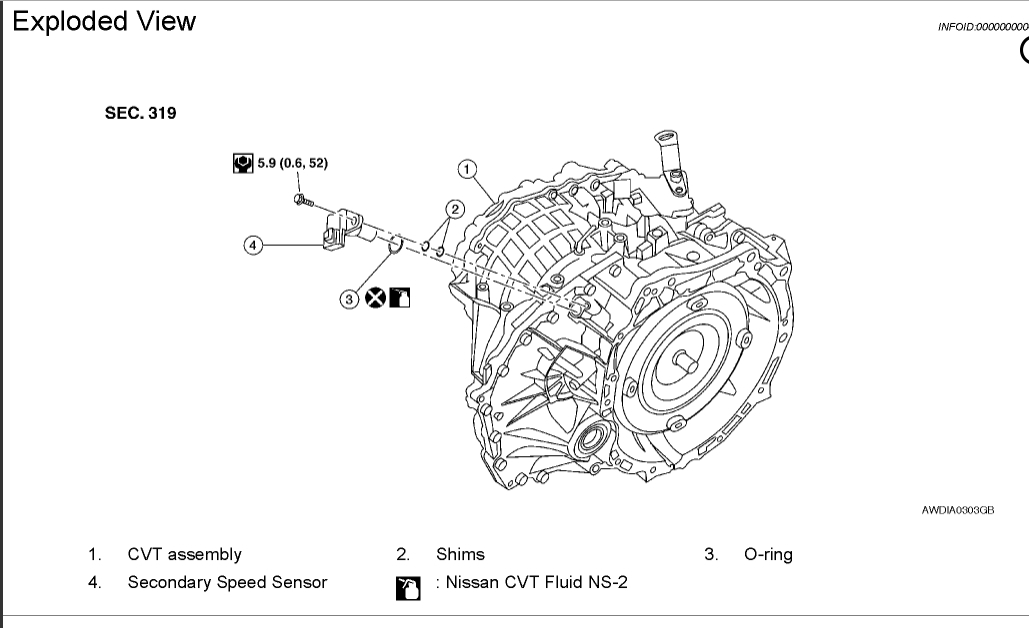

Hello.
This code is for the output speeds sensor issue which most of the time the sensor needs to be replaced here is a diagram of the location.
