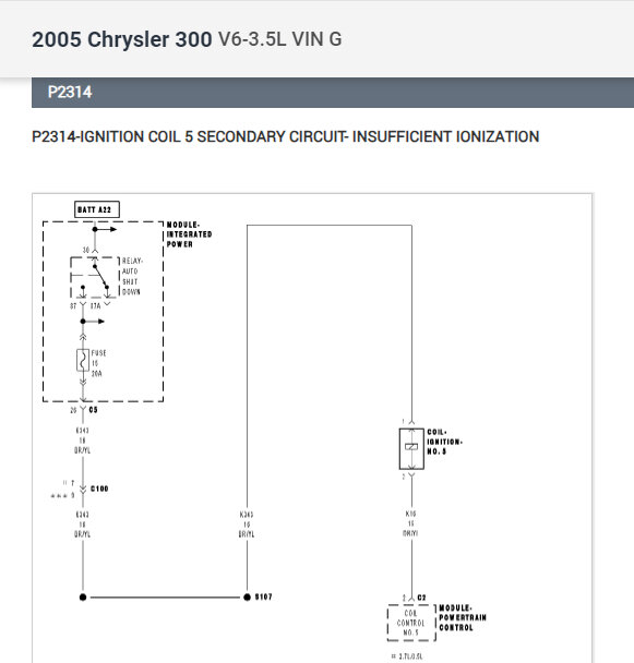

I checked the codes and i got one for p2314 but when i turn my engine on my check engine light goes off i checked the pulleys and all of them seemed to line up besides the crank a little bit i pushed it further back than i can and the belt is still slipping to the side of the tensioner and it gets really hot. i don't have any vacuum leaks as well.
Mar 14, 2024 at 3:02 PM

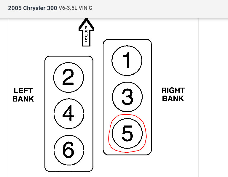

  • 110,194 POSTS
The code indicates an issue with the cylinder 5 ignition coil. Here is what I want you to do. Remove the ignition coil and switch it with a different one on the vehicle. If the coil itself is bad, the code will change to a different cylinder.
As far as the belt is concerned, how tight does it feel? The tensioner itself may be faulty.
See pic below for cylinder 5 location.

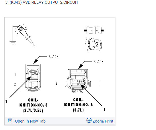

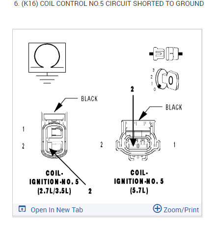

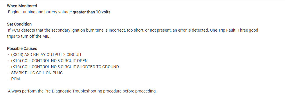

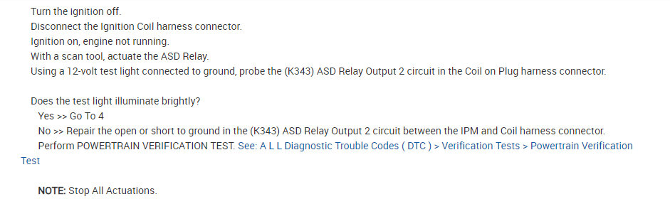

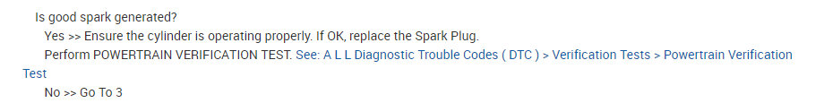

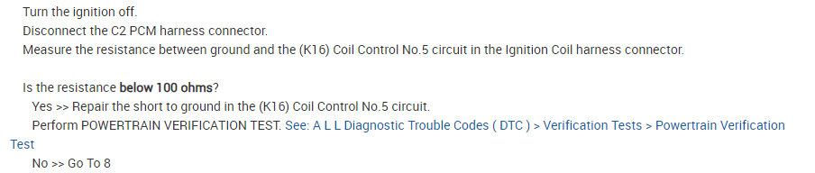

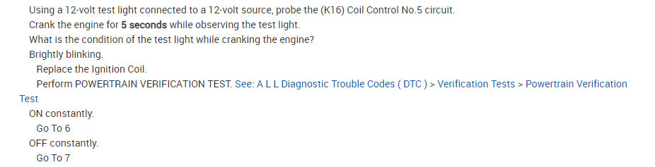

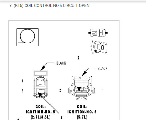

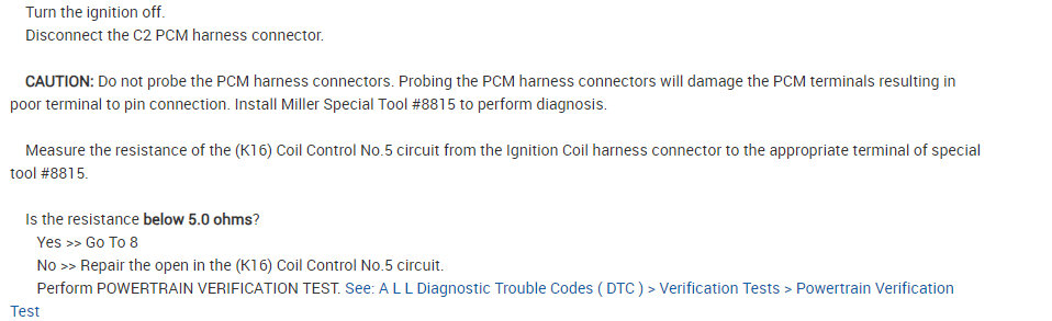

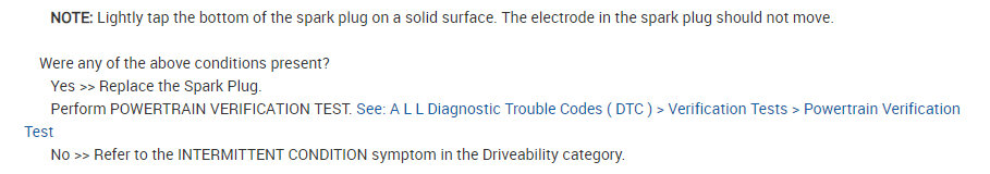

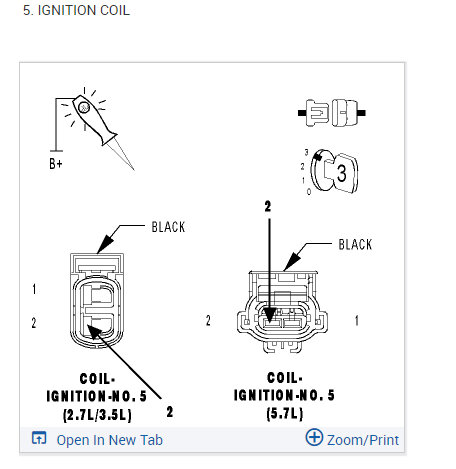

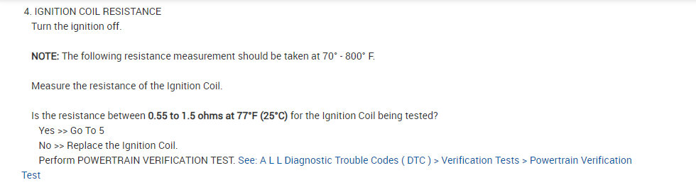

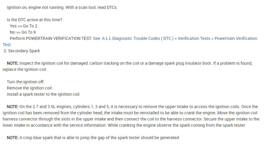

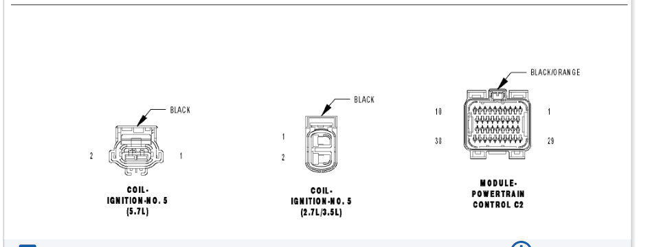

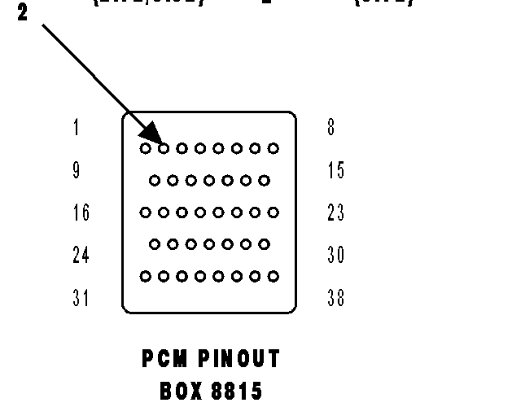

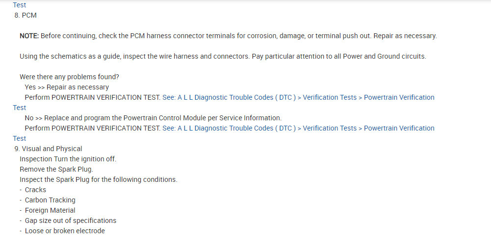

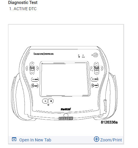

  • 110,194 POSTS
If the spark plugs are good, then we need to start chasing wires. If you look below, I attached diagnostics for the code. Take a look at them and let me know if you are comfortable performing them.
Also, I made the assumption that you cleared the code and then it returned. If that isn't the case, clear it and see if it comes back.
