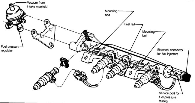

Car idles at a good smooth rpm but when I push the gas it chugs spits and sputters until i either let off the gas or it shuts off.
This car was running fine then I was on the freeway at a steady rpm and suddenly it was acting like I was running out of gas, until I got down to about 40 mph then it was okay. after i got the car home i started it and it seems to have gotten worse. now wont go much more above 1,000 rpm's.
Please help!
Thank you

Based on your description, it sounds like the fuel pump may be going bad or you may even have a plugged fuel filter. What I would do first is simply check fuel pressure.
Here is a link that explains how it is done:
Here are the directions specific to your vehicle for testing. The attached picture correlates with the directions.

Digifant Fuel Delivery Components
pic 1
- Wrap the fuel rail with a clean rag, then loosen and remove the screw from the fuel rail service port and connect a fuel pressure gauge.
- START the engine and allow it to idle. Fuel system pressure should be:
^ Specification: 36 psi (2.5 bar)
- Disconnect the vacuum hose from the top of the fuel pressure regulator. Fuel pressure should increase to:
^ Specification: 44 psi (3.0 bar)
- Turn the engine OFF. After ten (10) minutes, residual pressure should be at least:
^ Specification: 29 psi (2.0 bar)
- If the system pressure is too high, the pressure regulator is faulty and should be replaced. If the pressure is too low, RUN the engine briefly to build up fuel pressure, then turn the engine OFF and quickly pinch shut the blue fuel return line. If the pressure holds, then the pressure regulator is faulty and should be replaced.
- If the pressure still drops, check for leaks in the fuel system. If no leaks are found, the fault may be due to a leaky fuel injector, a faulty fuel injector O-ring, or a faulty fuel pump check valve.
- To finish the fuel pressure test, disconnect the gauge from the fuel rail service port and catch any spilling fuel with a clean rag. Install the sealing screw with a new seal.
Start with this and let me know what you find. I will watch for your reply. Also, I realize most people don't own a fuel pressure gauge, but most parts stores will lend or rent one to you.
