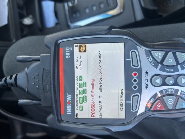

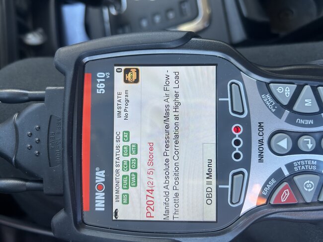

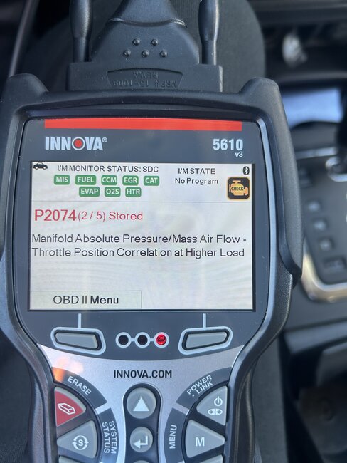

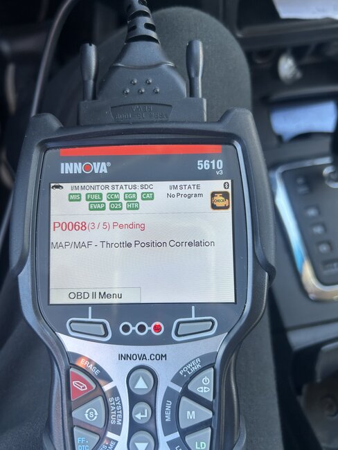

I started my vehicle up the other day and the RPMs shot up to about 3000 and then would fluctuate erratically. I have attached the codes that I pulled. I need to note that there is a pretty decent sized hole in the muffler. Would that have anything to do With the issue?

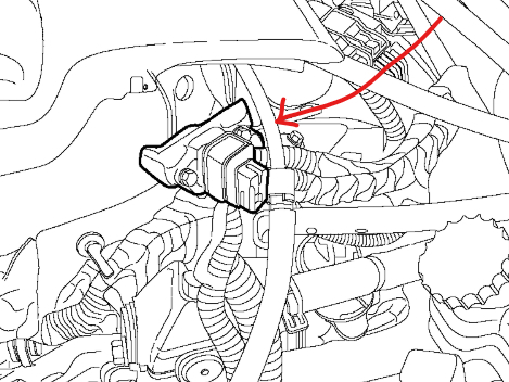

If you have a vacuum leak or the MAP sensor is dirty this will cause a lean condition which can cause high idle as well. I would remove it and clean it, here is the location. Check out the images (below). Let us know what you find, clear the codes once the repairs have been made.

It was the map sensor. Thank you so much for helping!
