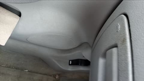

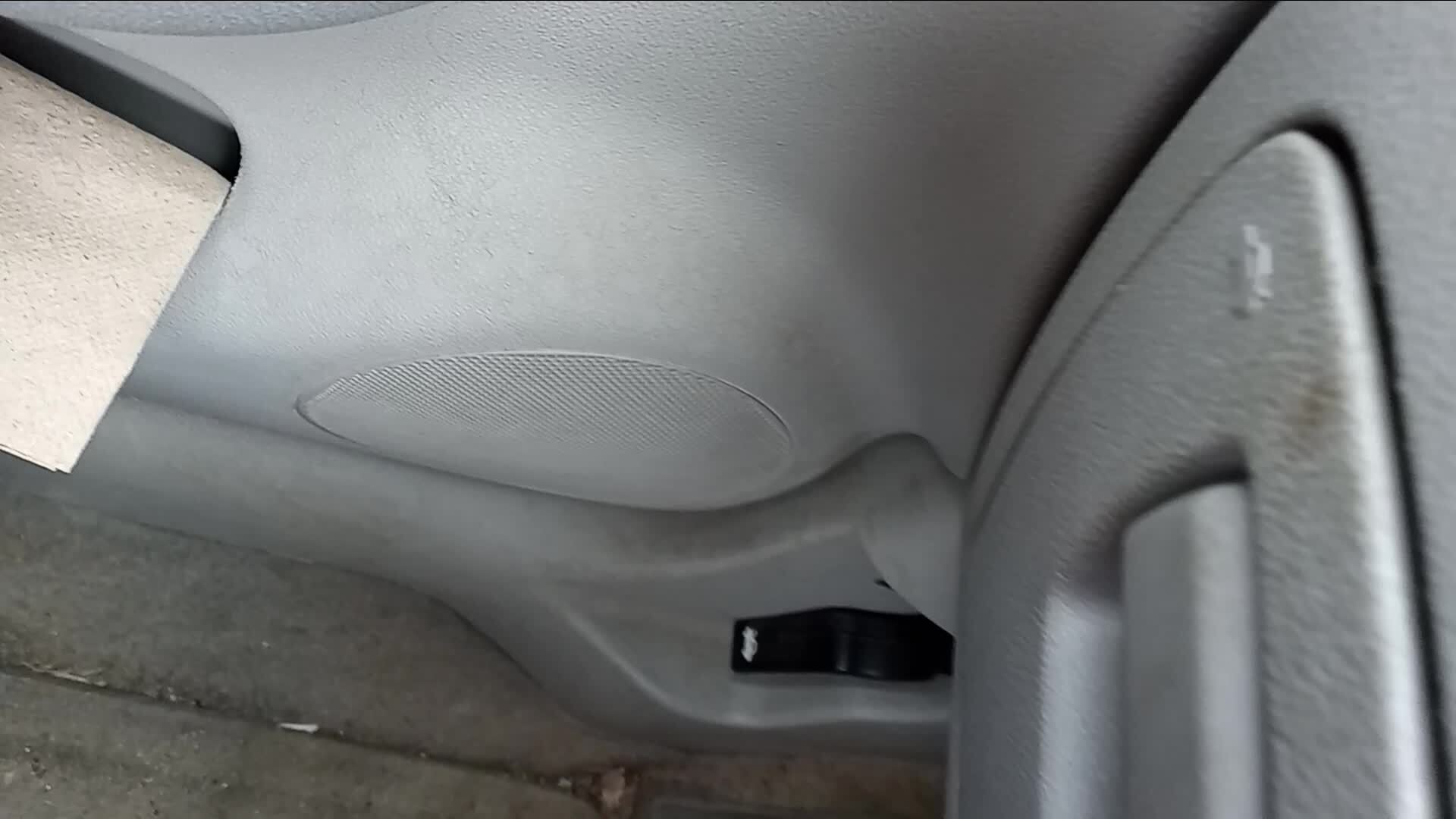

So, here is the new rundown: She let me bring it home where all my stuff is at. It definitely gets louder as I drive. I did try to record and will try to add those sounds in a bit. I ended up jacking up the front of the car, and removing the tires, calipers, and brackets. Figured I would spin the hub with nothing on it. I did notice the caliper brackets were kind of stuck. I know that can be the issue. I hear nothing while I have someone with the pedal down while all brake parts are off, but I noticed that when you take your foot off the gas after a short time the wheels stop spinning. I know at the very least, she will need new calipers and brackets. My concern at this time is since I have never done it like this before, is it okay, the drive wheels stop spinning after a short time with no brakes? I know a car has a natural "pull" so it automatically moves forward. Do they stop when they don't have the weight of the car to keep them moving? I only ask because I don't want to replace brake parts and find out there is still a bigger issue. I took it on the highway and the sound did get louder but sounds different on video than I hear.

Thanks for the update. I listened to the video, but really can't tell what I am hearing.
As far as the question, if you had the brakes removed and the wheels off the ground, I would have thought it would the wheel would slow down but still continue to turn slowly. Is that what you are asking?
As far as the brakes are concerned, I question if they would cause a howling sound. I wish I could hear it. The idea that it's a howling and changes with vehicle speed, it is more than likely a bearing issue.
