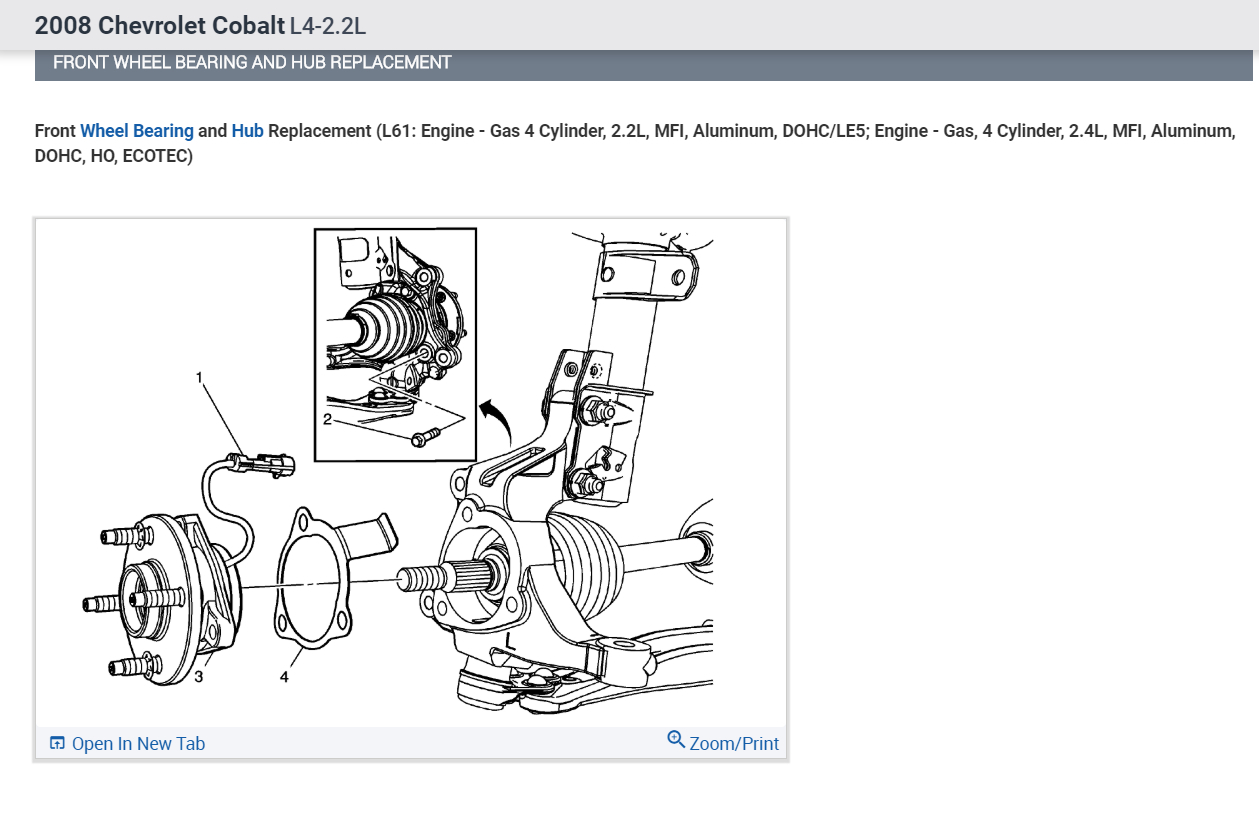

My car just recently started to make a humming noise while I accelerate. It is not loud sound, but it is noticeable.

So can you you hear the noise coasting in neutral? If not this can be a sign of the front bearing hubs going out here is a guide that will walk you through the repair with diagrams below to help you see how the job is done on your car.
https://www.2carpros.com/articles/bearing-hub-replacement
this guide can help as well
https://www.2carpros.com/articles/car-howling-noise
Check out the diagrams (Below). Please let us know what you find. We are interested to see what it is.

No only when I put my foot on the accelerator. it does not start to make the sound until 2000 rpm's, but it is not a very loud sound. I have seen posts about wheel bearing but from all the sounds that people described they did not fit the sound my car was giving off. it is not a whine, it is really like a vibration/humming sound and I have located it to the right of the car, and it is not the radio I have tested that.

I finally got a new hub for $154.00 and installed it on the passengers front and the noise is gone! Wish I did it earlier :)
