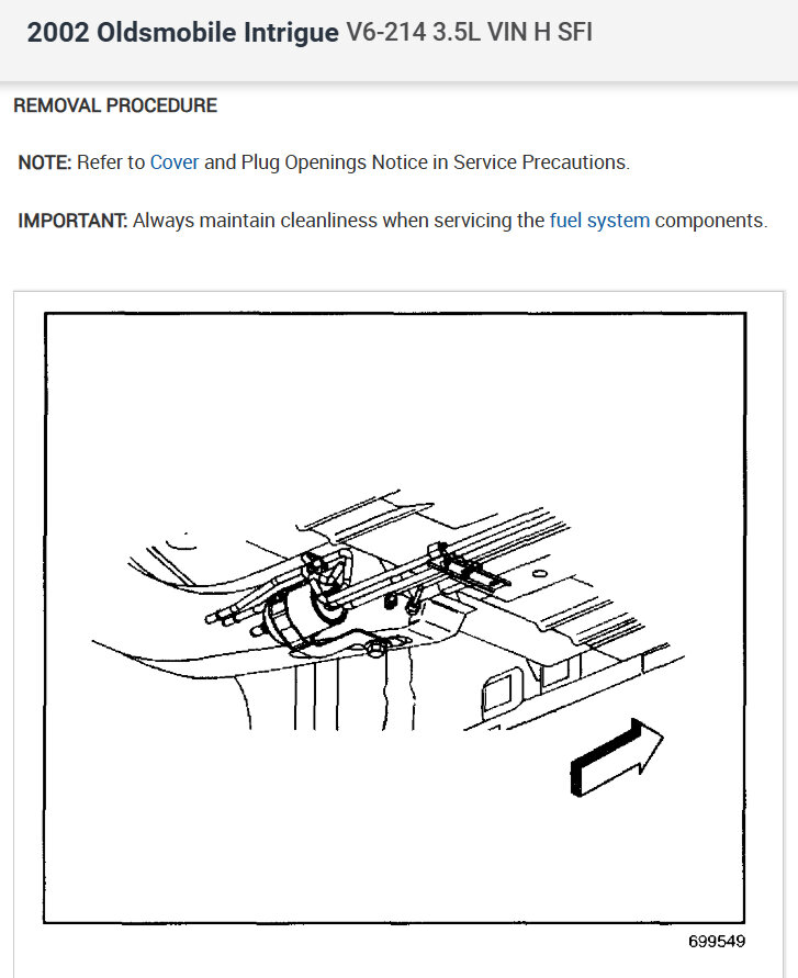

Just replaced crankshaft position sensor and running under 2,000 RPMs and a little hesitation still.
Feb 14, 2025 at 10:02 PM
Experienced Mechanic
55,721 POSTS

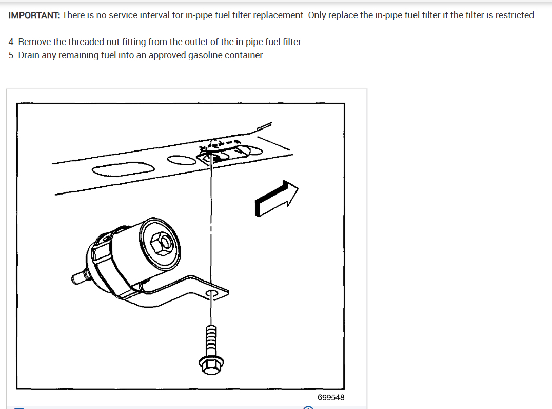

Do you have a check engine light on? If so, let's run the codes to see if any are stored.
Also, there is a fuel filter under the car which I would swap out. Here is the location and how to change it out. I have also seen a dirty throttle body cause this issue as well.
https://www.2carpros.com/articles/engine-hesitates
