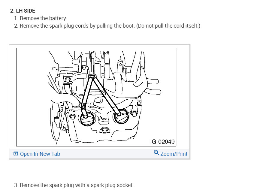

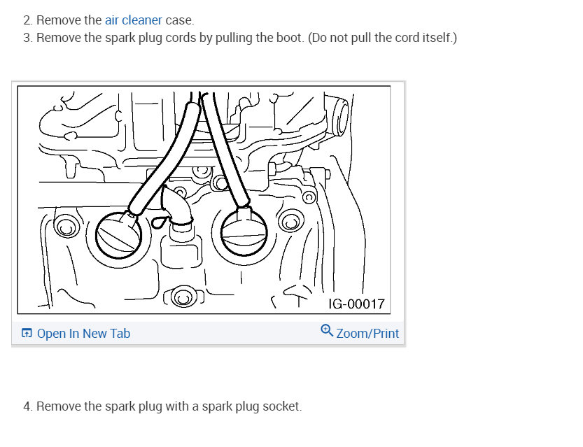

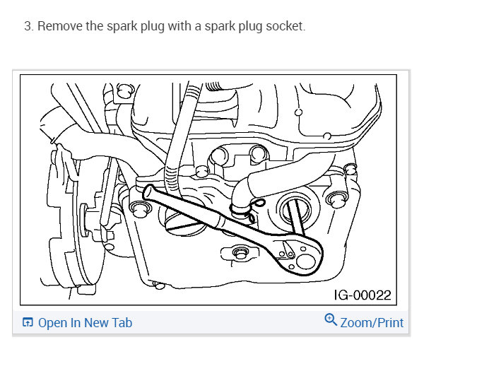

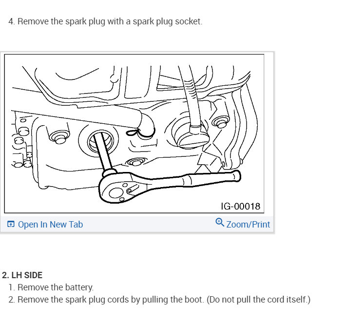

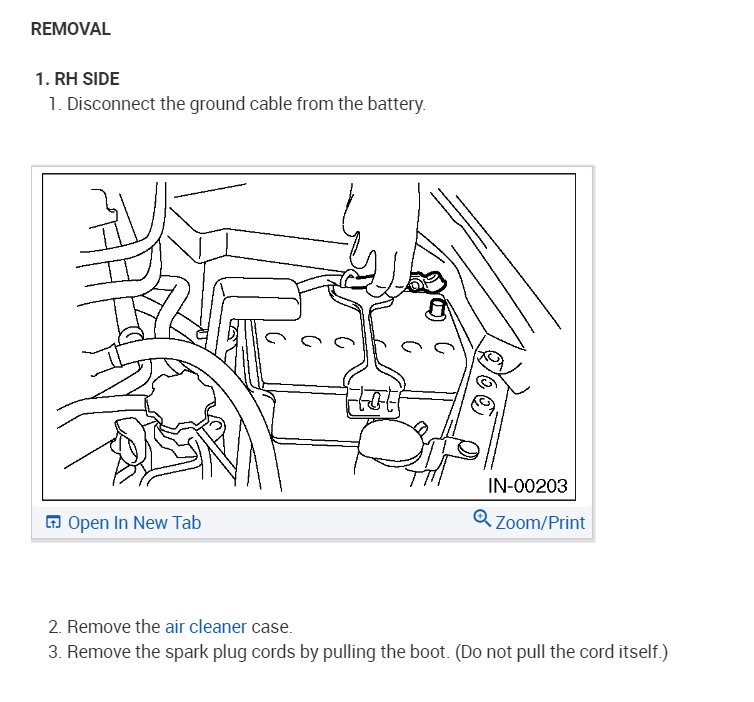

This will tell you which cylinder is having the issue. I have also included how to change out the spark plugs in the diagrams below.
