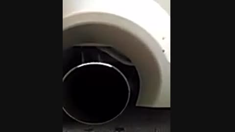

In the past it would backfire when I hit passing gear. Recently it has been hesitating when I accelerate. It also makes a rattling noise until I let off of the gas. It threw a code saying it was a faulty cam shaft position sensor bank2. I replaced the sensor but problem persists. I am going to change plugs and coils next weekend. Any ideas? Thanks in advance.

I tried to make a video while driving and one sitting idle after I got home. Quality probably is not the greatest. Thanks in advance for your time.

Thanks for the videos they really help. Because of the pulsing out of the exhaust pipe it sounds like you may have a burnt valve. From the first video right at the end I thought I heard a timing chain issue like a guide let go but will need more engine running video to be sure. (give it a quick rev)
I would first read the codes to see which cylinders are effected. Then remove the spark plugs to check their condition. Then I would roll a compression gauge into each for the cylinders and take readings.
