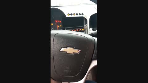

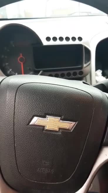

My car was slow to start up for a few days, the engine was taking longer to turn over. One day It didn't start, I got a jump, and it started. Went and had my battery, alternator, and starter tested. AutoZone and O'rielys said they were fine. My car wouldn't start again the next day. I waited until the day after to try and get a jump, but it wound up starting without a jump.

Good afternoon,
Can you upload a video for me to hear when it does not start?
I would also make sure the cables are clean and tight.

The cables look clean and tight. It seems to be happening on and off. I don't think the battery is drained but I'm not sure. It is cranking but will not always turn on. The lights and everything turn on still.
