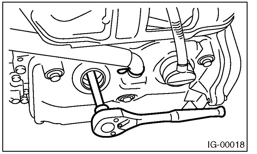

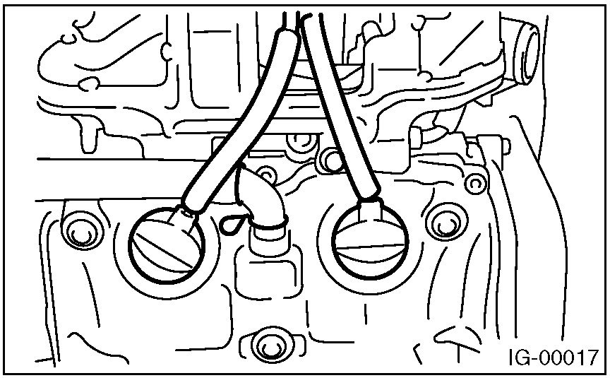

The car will crank and seems like it turns over fast enough to get going, but will not fire up in the cold under 20 degrees unless it is heated with a heater.

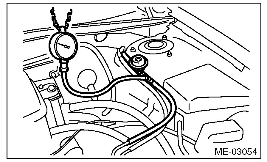

Okay, here is what I suggest. If you have a live data scanner (I noted beginner mechanic), check the ECT (engine coolant temp sensor) signal to confirm it is telling the computer the correct temperature.

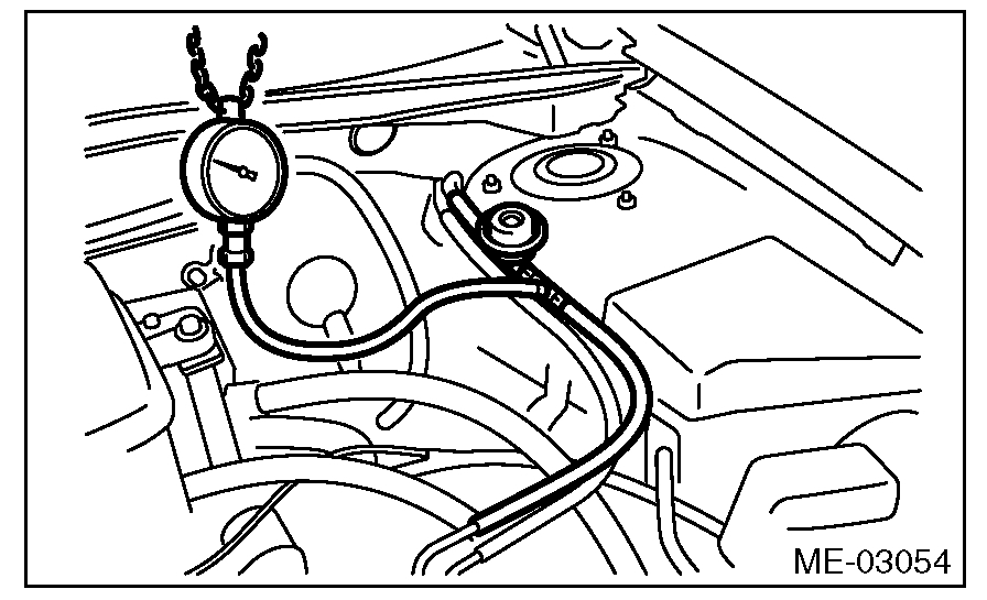

Next, if the ECT is correct, then I would confirm fuel pressure isn't weak. Here is a link that explains how to test it:
Here are the directions specific to your vehicle. The specs are included in the directions and picture 1 correlates with the directions.

1) Release the fuel pressure.
2) Open the fuel filler lid and remove the fuel filler cap.
3) Disconnect the fuel delivery hose from the fuel damper, and connect the fuel pressure gauge.
pic 1
4) Start the engine.
5) Measure the fuel pressure after warming up the engine.
NOTE:
The fuel pressure gauge registers 10 to 20 kPa (0.1 to 0.2 kg/cm2, 1 to 3 psi) higher than standard values during high-altitude operations.
Fuel pressure:
Standard
339.5 - 360.5 kPa (3.5 - 3.7 kg/cm2, 49 - 52 psi)

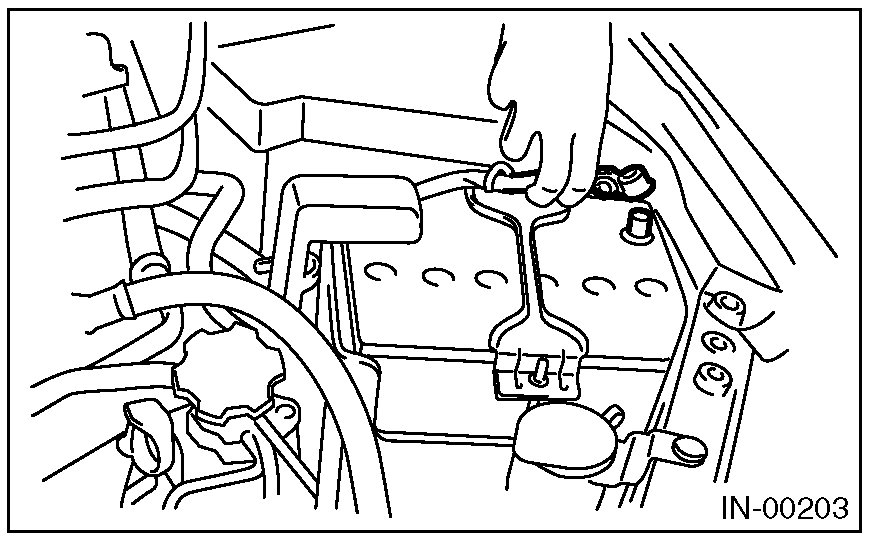

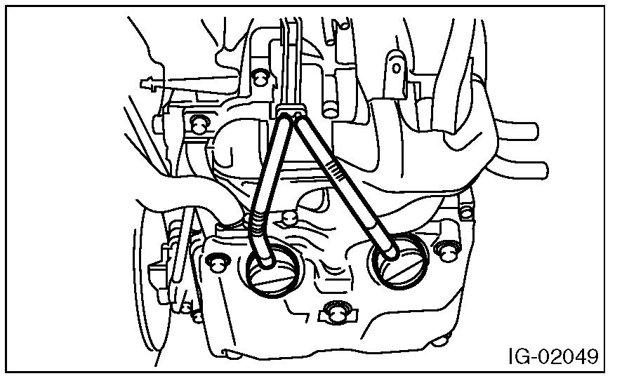

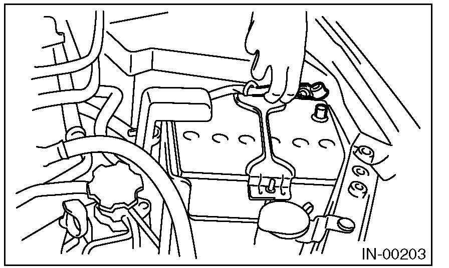

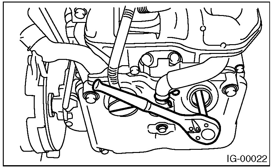

Let me know when the last tune up was. Also, you may want to remove a spark plug to check condition. Here are the directions for removal and replacement. I have to be honest, if it has been awhile, I would just replace them, but that is up to you.
The pics correlate with these directions.

Spark plug:
Refer to "SPECIFICATION" for the spark plug.
1. RH SIDE
1. Disconnect the ground cable from the battery.
pic 2
2. Remove the air cleaner case.
3. Remove the spark plug cords by pulling the boot. (Do not pull the cord itself.)
pic 3
4. Remove the spark plug with a spark plug socket.
pic 4
2. LH SIDE
1. Remove the battery.
2. Remove the spark plug cords by pulling the boot. (Do not pull the cord itself.)
pic 5
3. Remove the spark plug with a spark plug socket.
pic 6

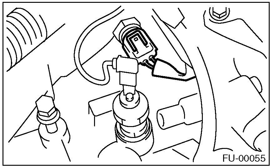

If you find the ECT is faulty, here are the directions for replacement.
2010 Subaru Impreza F4-2.5L SOHC
Removal and Replacement
Vehicle Powertrain Management Sensors and Switches - Powertrain Management Sensors and Switches - Computers and Control Systems Coolant Temperature Sensor/Switch (For Computer) Service and Repair Removal and Replacement
REMOVAL AND REPLACEMENT
Engine Coolant Temperature Sensor
REMOVAL
1. Disconnect the ground cable from battery.
pic 7
2. Remove the generator.
3. Drain engine coolant.
4. Disconnect the connectors from the engine coolant temperature sensor.
pic 8
