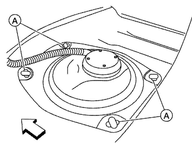

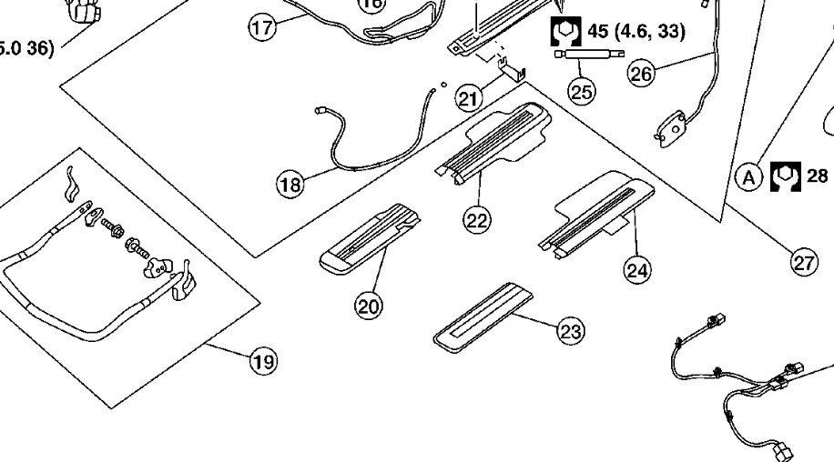

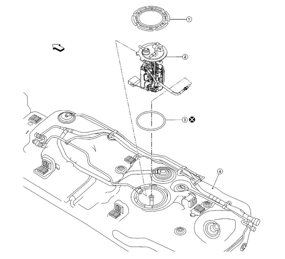

The low tank causing issues sounds like it has a cracked fuel line in the tank. Fuel gets below the split area and it sucks in air. The alcohol in the fuel seems to make the tubing brittle. The good thing is that you can access the pump from inside the vehicle. You remove the covers on the seat slides and move the second seat fully forward. Then move the carpet to get to the pump opening. Turn the locks and remove the cover. Then you disconnect the lines and power, remove the retainer ring and then the pump. Reverse the process with the new one.
