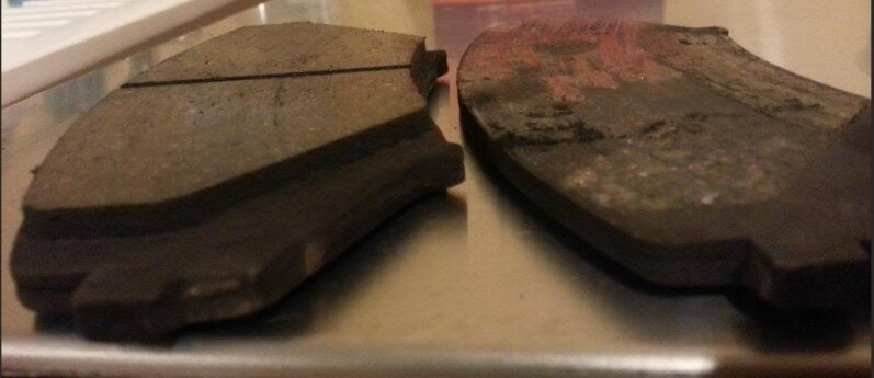

I have seen this before on a Subaru. On that vehicle, it had a seized caliper on one side in the front. I suspect you are having the same issue.
The brake caliper may be seized or partially seized so the scraping noise is one of the brake pads has worn down to nothing because the caliper isn't moving.

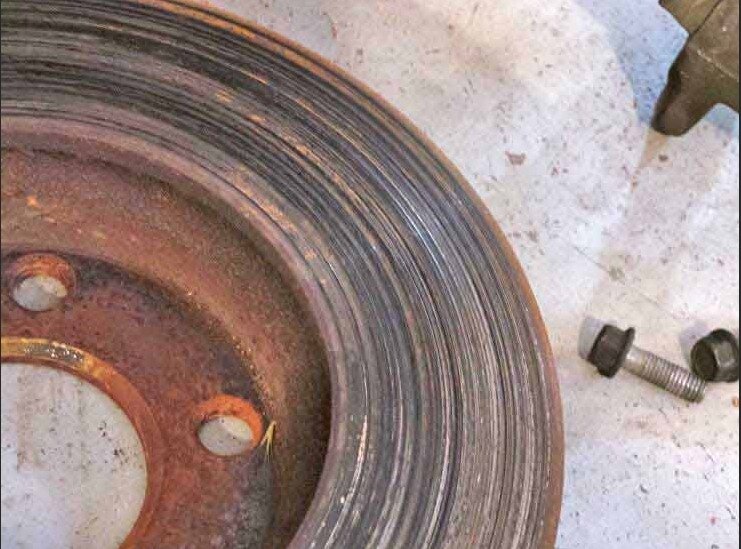

I would chock the rear wheels, loosen the lug nuts, jack the vehicle up, put it on jackstands and remove the front tires and inspect the brakes. You may have to remove the caliper to get a good view, or you might see it immediately as excessive wear on the rotor. It should be the inside pad. One side of the car's front brakes should have one pad that is worn down more than the other.

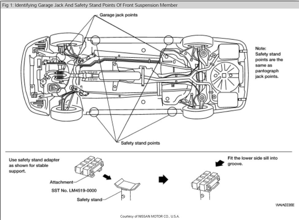

I am adding some information on how to safely lift the vehicle.

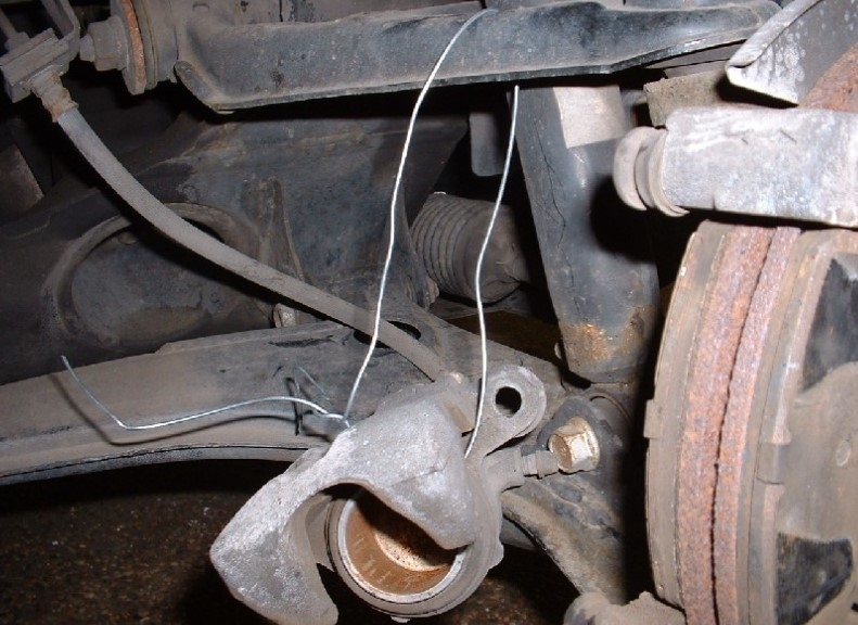

Also, if you do end up removing the caliper, hang it from the strut with some wire or a bungee cord to prevent damage to the brake line.
