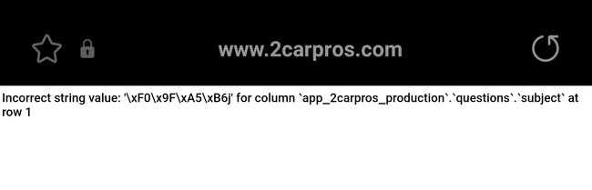

Hey guys, I was trying to ask a question about my heater, but it won't let me submit the question. I attached a picture of the message it is giving me.
Dec 19, 2021 at 5:37 PM
Okay. I know we were having some issues with the submission portion, and they were working on it, but I will find out if they are finished and we can try again.
I will send you a direct message when we should be good to go. Thanks
