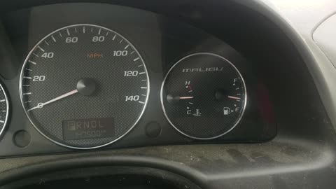

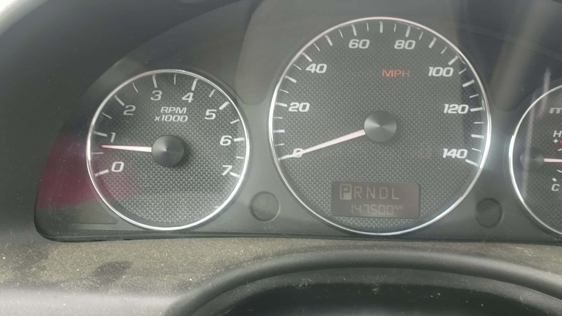

So was driving the car the other day and all of a sudden my radio came across with the message maintenance power steering, then my traction control light came on, and then the alarm set off light came on as well on the dash turned the car off and back on and nothin everything went off. now today I am going to town and my oil light keeps dinging at me. i just changed the oil, replaced the filter and the drain plug and just now checked the oil and it's fine. What in the world is going on with this car? Oh, and I forgot one more crazy thing; my gas mileage reads on my radio and for some odd reason it is going up in the amount of miles I have to go until empty about 10 MPG and then will jump down about 4 and back and forth like that! Help!

Gauges and radio seem to be working fine. I was thinking more of a fuse going bad, a wire grounding out somewhere that going to the computer maybe.
Sep 5, 2021 at 4:44 PM
Just to make sure we are on the same page. What lights are coming on now if the gauges and radio are operating?
Still the traction control light and the oil change minder?
Can you get a video of the lights that are coming on so that we can see exactly what the verbiage is for each?
Also, we need to load test the battery because if that is weak then we can have all sorts of issues.
Then we need to scan for codes as I suspect we are going to have some codes that will point us in the right direction.
Basically we need to start with this and go from there because just a traction control light and oil change are not related so it could be a number of issues.

It started with the maintenance electric power steering message coming across the radio (that's where my check engine light messages read at) and then the traction control message on the radio and light came on the cluster. I can't get a video at the moment because all of the lights and messages went away. Also my seat belt light and airbag lights and warning sounds have been going off randomly, along with the gas mileage counter going haywire.

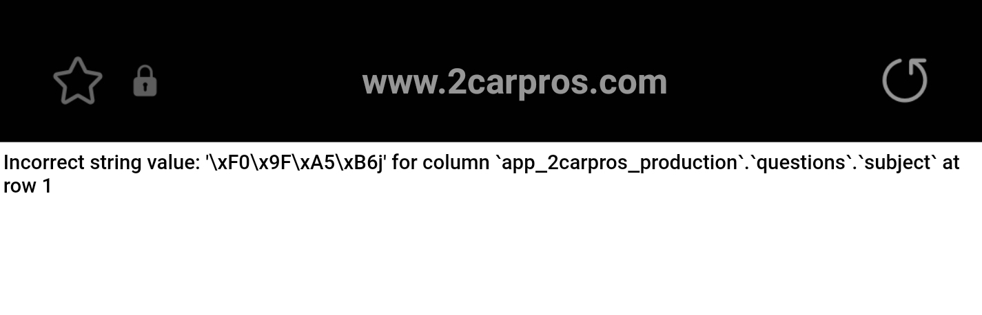

Hey guys, I was trying to ask a question about my heater, but it won't let me submit the question. I attached a picture of the message it is giving me.
Dec 20, 2021 at 1:37 AM
Okay. I know we were having some issues with the submission portion, and they were working on it, but I will find out if they are finished and we can try again.
I will send you a direct message when we should be good to go. Thanks
