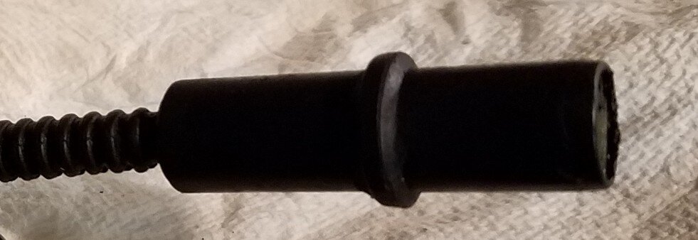

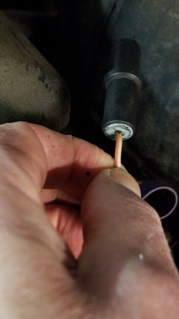

Car Check Engine Light (CEL) came on and car went into limp mode a few week ago. I checked the car: fluid levels normal, hose clamps tight, electrical connections tight. However, a single wire (tan or white with red stripe) with a plastic female connector was hanging between the firewall and the engine in the engine compartment. Mechanic and Ford service folks could not identify it. (see attached picture) After sitting overnight, the car started normally and ran fine for about 5 minutes, then CEL and limp mode again. I took it to an independent garage and they were unable to pull any error codes from the PCM (powertrain control module) using an OBD1 tester. The Ford dealership could not pull any codes either. I bought an Inova OBD1 reader and tried pulling codes. With key on engine off (koeo) I got a 111 code (all relays working?) and 10 (continue with next test?). With key on engine running (koer) the OBD1 produced no codes and the PCM appeared to lockup (radiator fan came on and ran continuously, CEL plus Battery light and Oil light on Dash). Had to disconnect battery to unlock. Incidence of limp mode is happening sooner and sooner as time goes on. Fuel line pressure seems normal ~40 PSI. I'm waiting for delivery of a refurbished PCM, but hope is fading. Help! suggestions appreciated. . .

The images are hard to tell what the the part is, it might be added aftermarket? I want to ask how you know the car is going into limp mode? This car is not like newer car which lose almost all engine power.
Code 111 - “System OK”
Code 10 - "The computer is moving from one test phase to the next"
So the PCM might be shorting out intermittently. To me if the engine suddenly loses power it can be the fuel pump/filter, or you may have a catalytic converter that has come apart internally, if you can upload s short video of the problem I can help you better. Also, additional images of the mystery part will help as well. Ken

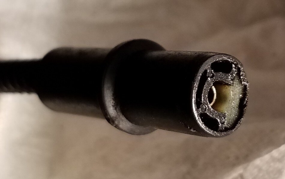

Here are a couple more pictures of the mystery part. In the tilted image, the brass female connector may partially be seen at the center of the connector tip, kind of like a half-moon image. The single wire attached to the plastic connector appears to be either tan colored with a red stripe or dirty-white colored with a red stripe. The Ford technician who looked at the mystery part thought it was 'part of the wiring harness.'

Yep, I would raise the car up and tap (rubber mallet) on the exhaust system and catalytic converter to see if you can hear pieces inside the letting you know the cat has come part internal and is blocking the outlet which will cause the small and the low engine power/check engine light. Next can you show me the other end of the mystery part, it kind of looks like the it goes into the transmission. This video will help you raise the car up.

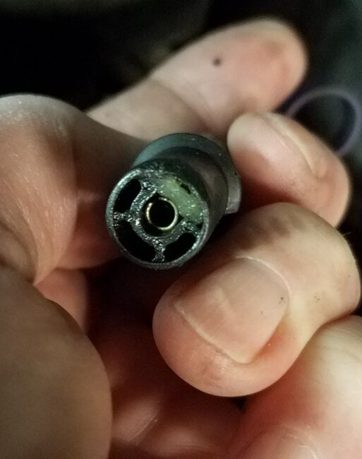

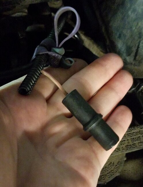

Hi Ken, I didn’t put the car on jacks but I did reach under and bang on the exhaust system and catalytic converters with a rubber mallet. I did not hear anything rattling around. Also, wouldn’t the exhaust smell like rotten eggs (sulfur) if the cats were bad? The exhaust is stinky but not like sulfur.
I’ve added some pictures of the "mystery part" for you to look at. I hope they help.

There is no reduced power "limp mode" for this car in 1995. So it will be the fuel pump or catalytic converter. That connector goes the instrument cluster, there must be a female connector in plugs into, I would use a flashlight and look around for it.
