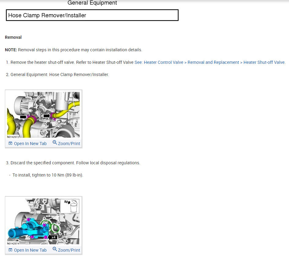

If your coolant level is good I suggest replacing the thermostat as this is what controls the engine temperature. I attached the procedure below for you to view.
https://www.2carpros.com/articles/how-an-engine-thermostat-works
https://www.2carpros.com/articles/coolant-flush-and-refill-all-cars
