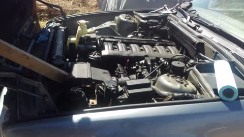

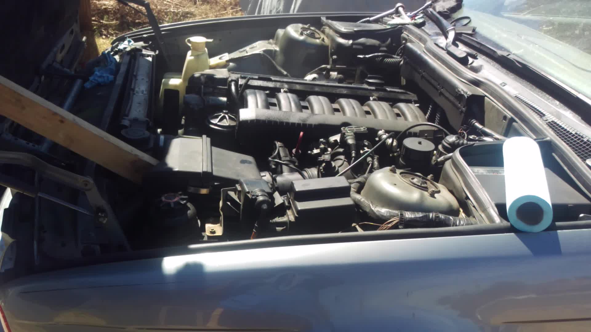

My car engine cranks and only stays started when continuously given gas. Once I take my foot off the gas, the engine just shuts off. I have replaced and checked the spark plugs for a spark and they all produced a spark of some sort. The old plugs were blackened.
I have replaced the fuel injectors and checked the fuel pump. There is fuel making it to the injector rail.
There was a lot of oil in the spark plug wells, but i cleaned out most/all of it before removing the plugs. I have fixed that leak.
When the car is kept started, there are misfires.
Anyways, what should I try to get my car running again?

You can get the car scanned for any fault codes. also, check for vacuum leaks and get a compression teat done. the scan may be the best place to start as if there is a code set. this will have to be rectified before anything else is looked at.

My car is a 94. An OBD2 scanner cannot be hooked up to it.

you will have to get a generic BMW scanner to read the codes, check vacuum leaks as this will be a primary concern and also test the coolant temp sensor as well.
