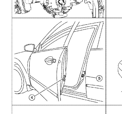

The problem started when first my driver's side, then my passenger side both wouldn’t close because of the cold. So, I closed the door and locked it and now it won’t unlock or open on either side. What should I do? I’m thinking of going to an auto body shop because I can’t fix this.

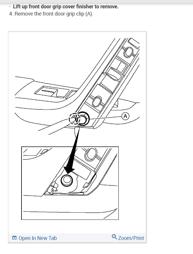

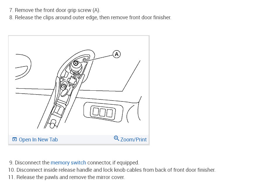

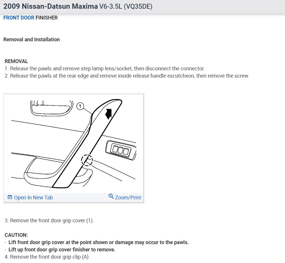

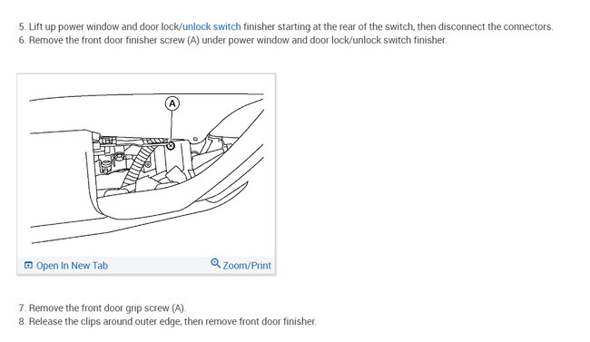

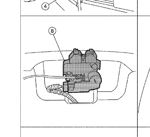

I would try to remove the inner door panels to see if the lock rods have fallen off the door latches, it just seems strange they would do this at the same time. You will need to remove the front seats to get at the panels. Check out the images (below). Let us know what happens and please upload pictures or videos of the problem.
