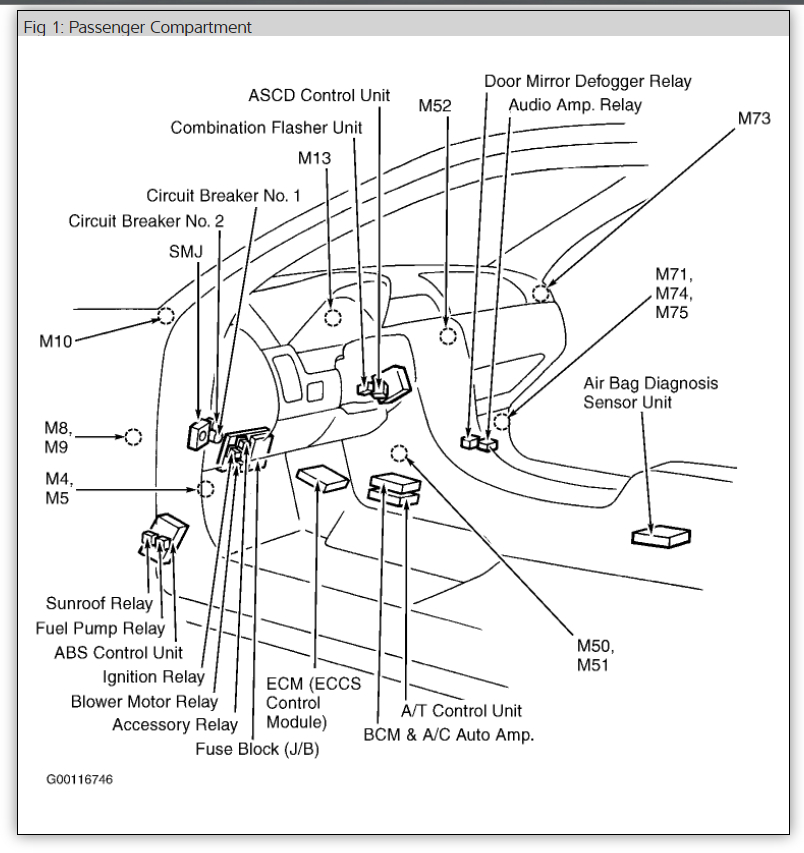

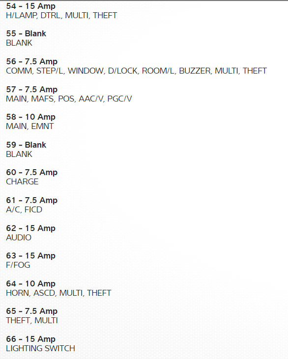

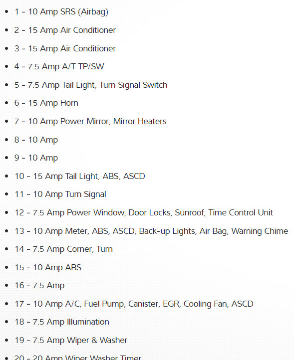

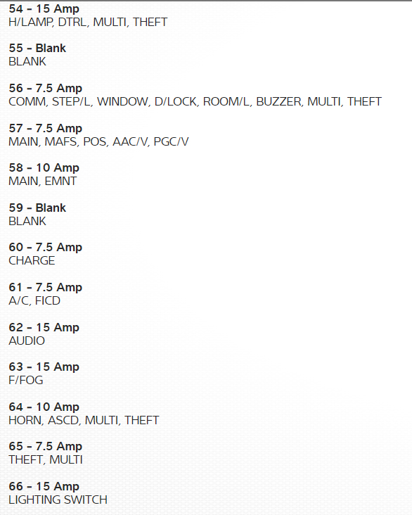

I was trying to clean the socket for the pointer and the door automatically locked with light flashes but unfortunately I put an iron in between the positive and negative of the socket. as the door locked and the flashes on, little spark of light occurred and since then, the left (driver side) light will not go on when door open both the front and the back light. However, when I traffic, the turn lights on perfectly. What do I do please?
Jul 29, 2017 at 8:46 PM
  • 55,433 POSTS

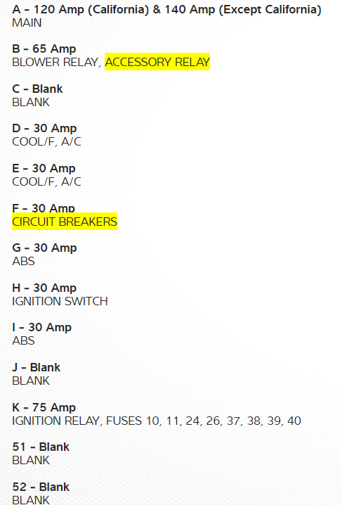

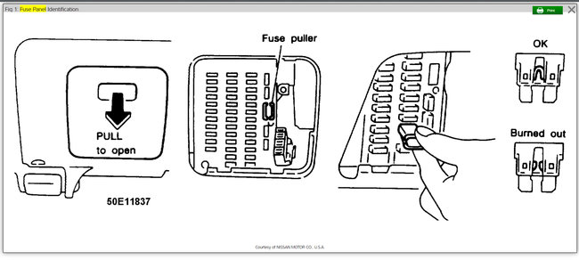

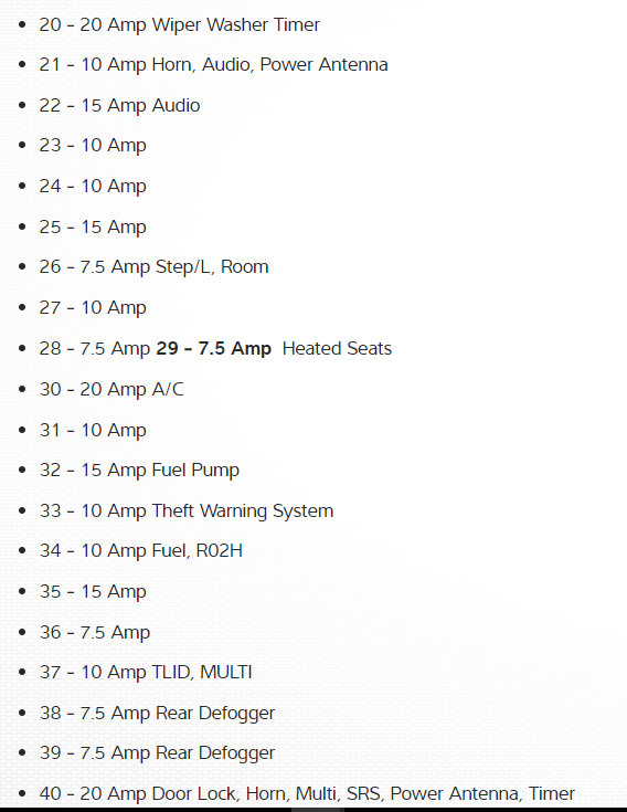

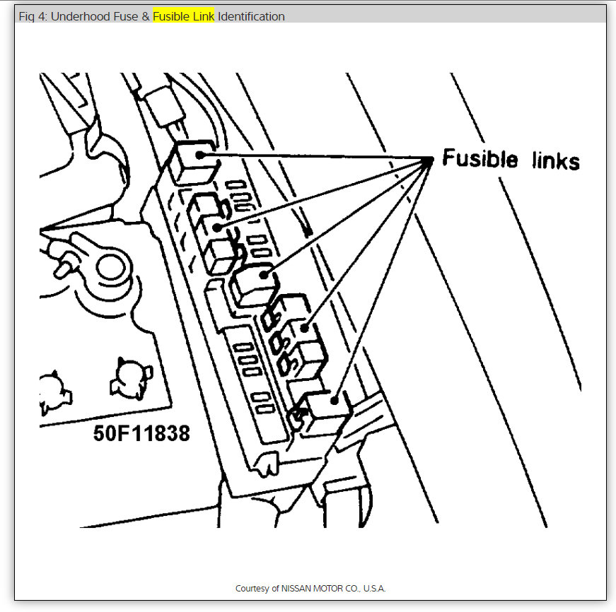

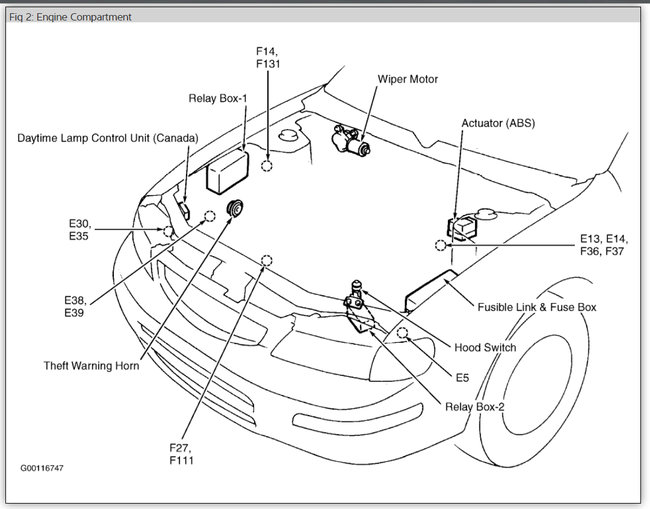

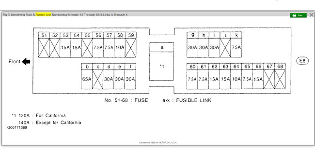

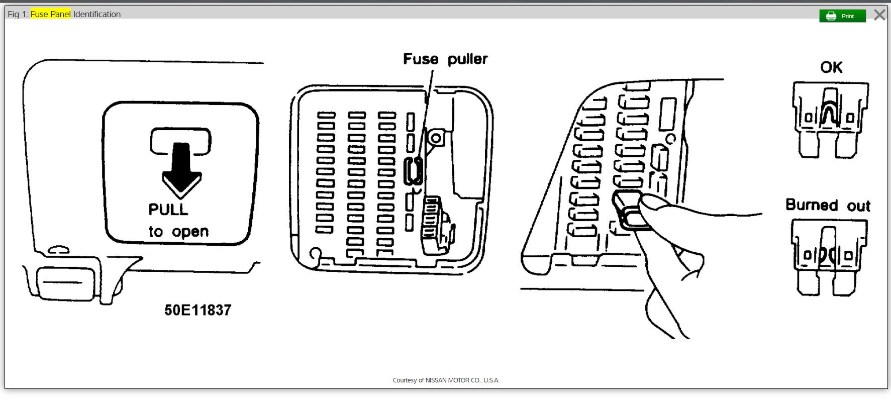

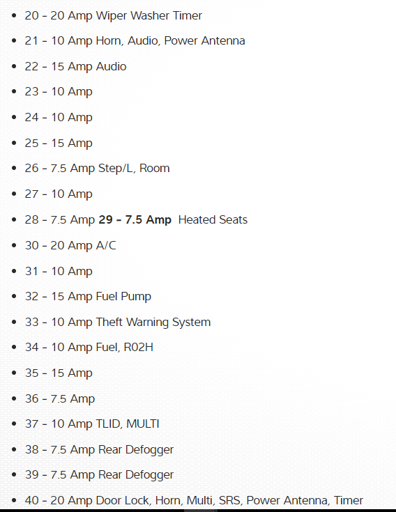

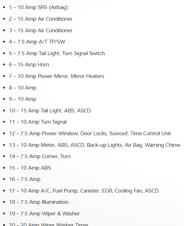

It sounds like you popped a fuse. Here is a guide to help you check the fuse and some diagrams (below) on where the fuses are.
Please run this test and get back to us we are interested to see what it is.
Jul 30, 2017 at 12:23 PM
SOYINKA OLADIPUPO
Thanks Ken, I am sure I have popped a fuse just as you have said. I will try and do what you have said and will get back to you. Thanks again
Jul 30, 2017 at 4:20 PM
  • 55,433 POSTS
Jul 31, 2017 at 5:13 AM
SOYINKA OLADIPUPO

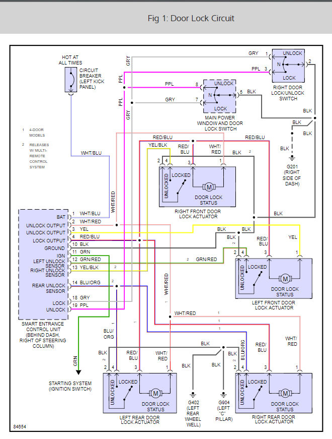

Hey, have checked it all. They are all fine and in good condition
Aug 20, 2017 at 2:41 PM
  • 55,433 POSTS
There is a smart door lock module that sounds like it has gone out, here is a wiring diagram to help you do some testing
