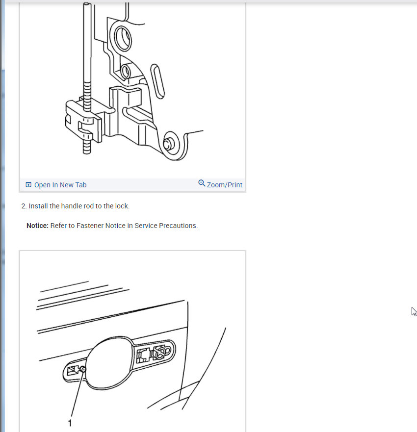

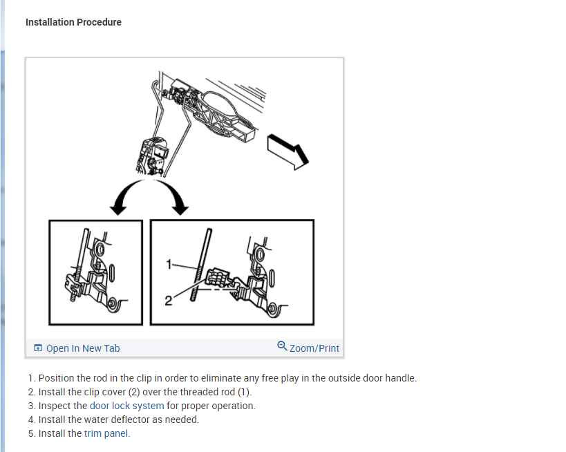

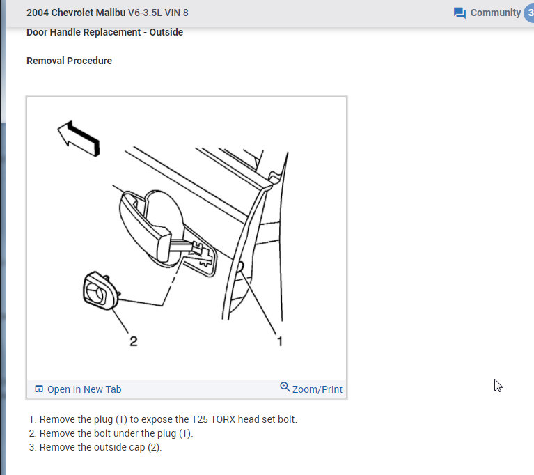

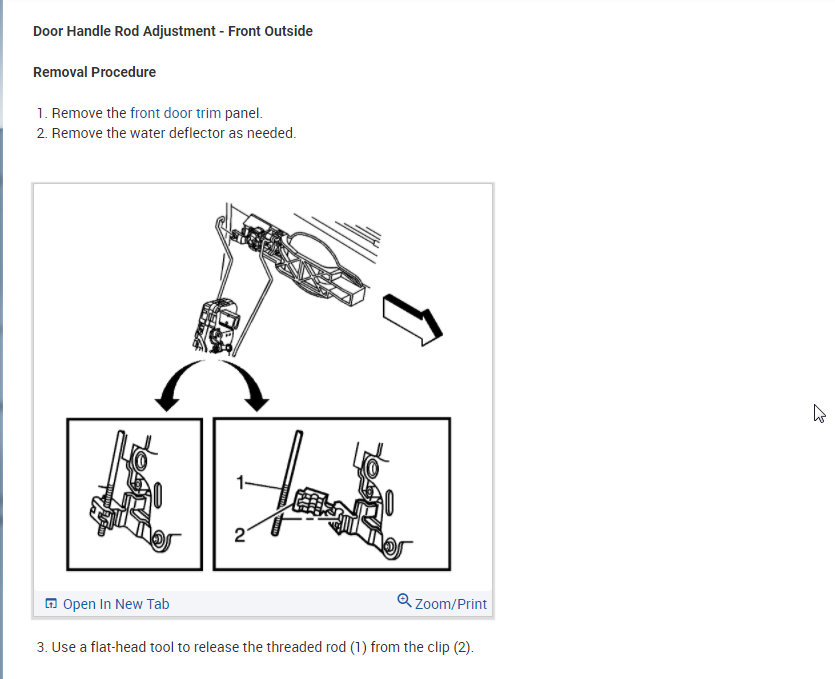

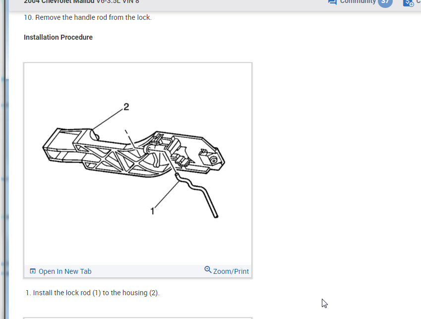

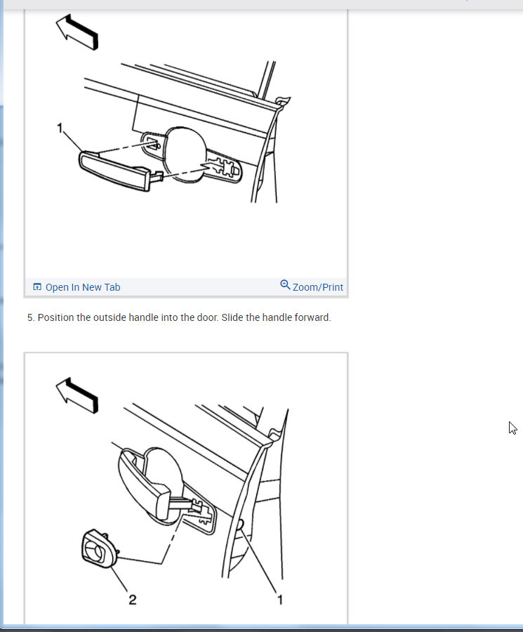

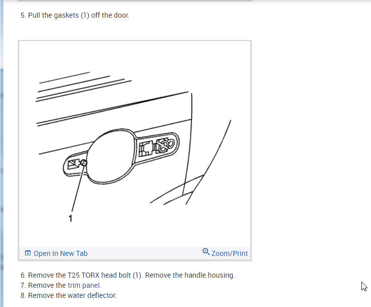

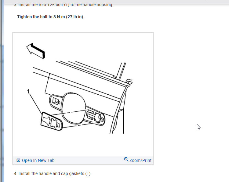

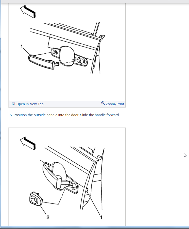

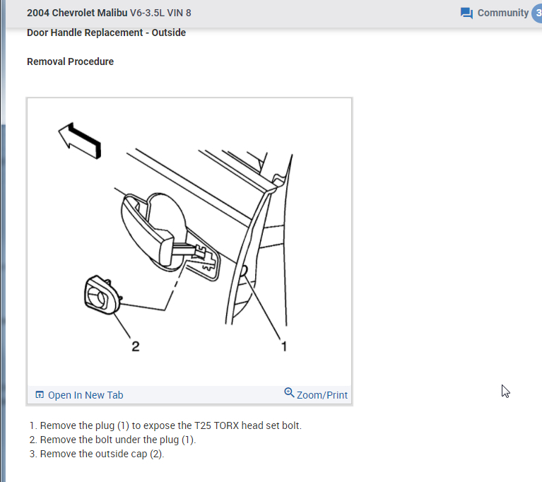

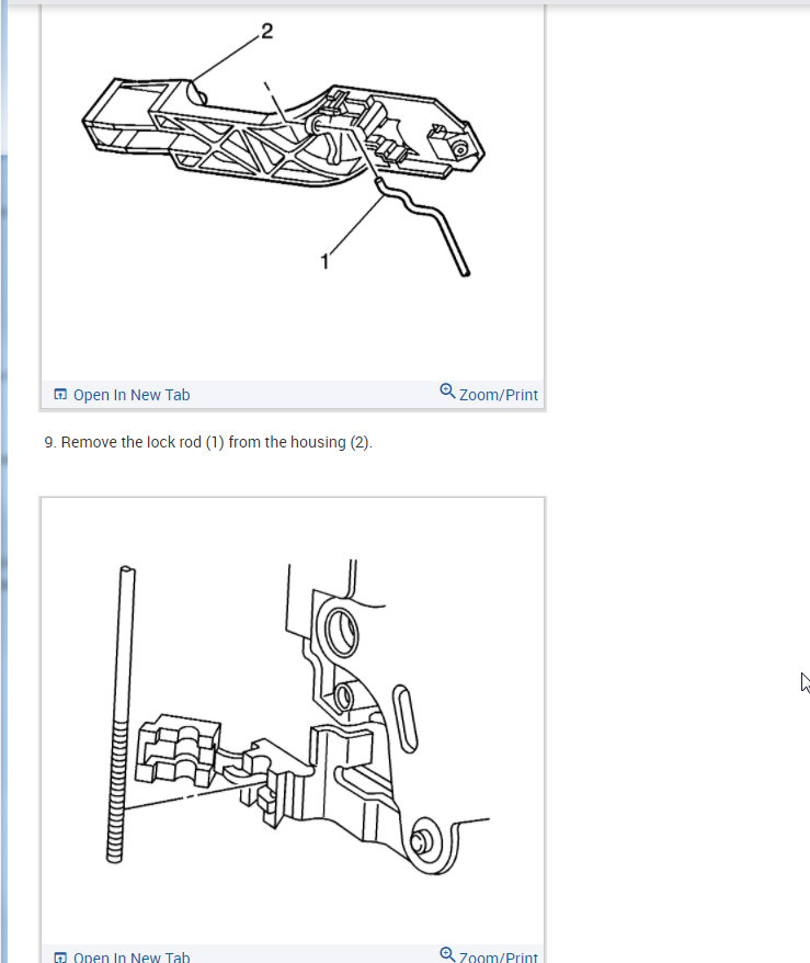

driver side door will not open from the outside
2004 CHEVROLET MALIBU
195,000 MILES • 2WD • AUTOMATIC
LYDIA LASAS

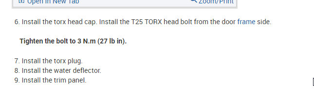

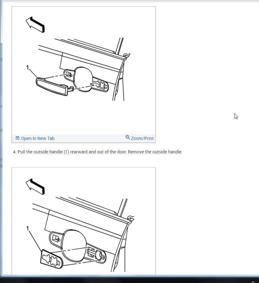

Do I need a new door?
Nov 17, 2020 at 3:42 AM

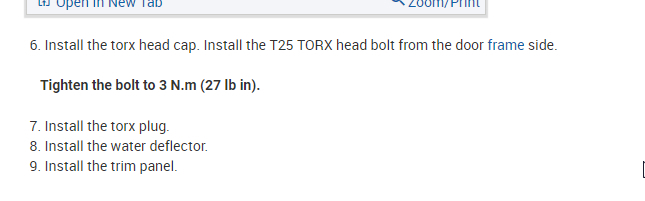

You do not need a new door. Your handle either needs to be replaced or the rod needs to be adjusted. Either way you need to access the door handle to find out what happened. I included the entire procedure. Most of the time the rod just slips and needs to be adjusted. However, if the clip that holds the rod breaks then you need to replace the handle.
Let me know what questions you have.
