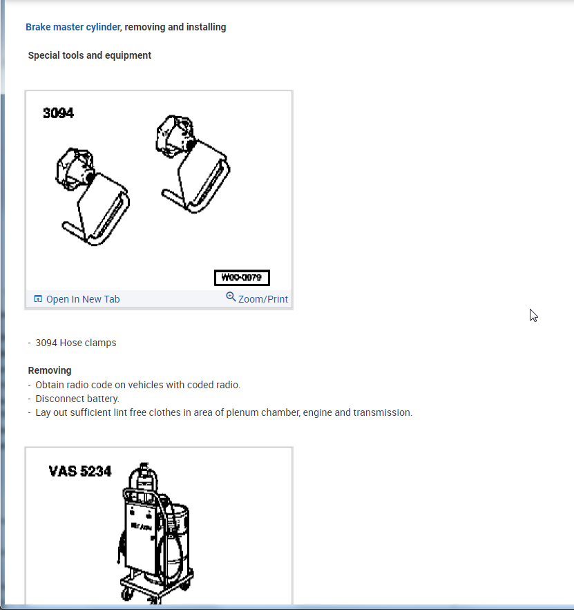

I can't give brakes they go to the floor what kinda problem
2004 VOLKSWAGEN POLO
179,000 MILES
TAJPOLO
I tow it home and discovered I can't give brakes they go to the floor what kinda problem am I looking
May 31, 2013 at 5:29 AM

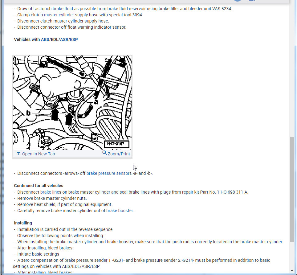

More then likely this is the master cylinder. Here are the master cylinder installation instruction you have requested. Here is a guide to help you step by step with instructions in the diagrams below to show you how on your car.
https://youtu.be/WDxvEQrMkBg
and
https://youtu.be/w7gUsj2us0U
and
https://www.2carpros.com/articles/how-to-replace-a-brake-master-cylinder
Below you will find the process on how to replace this from the manual. Please run through this material and let us know what questions you have.
