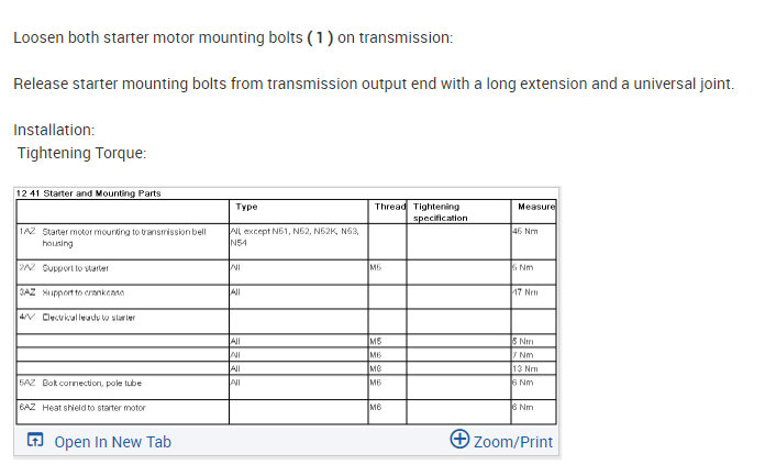

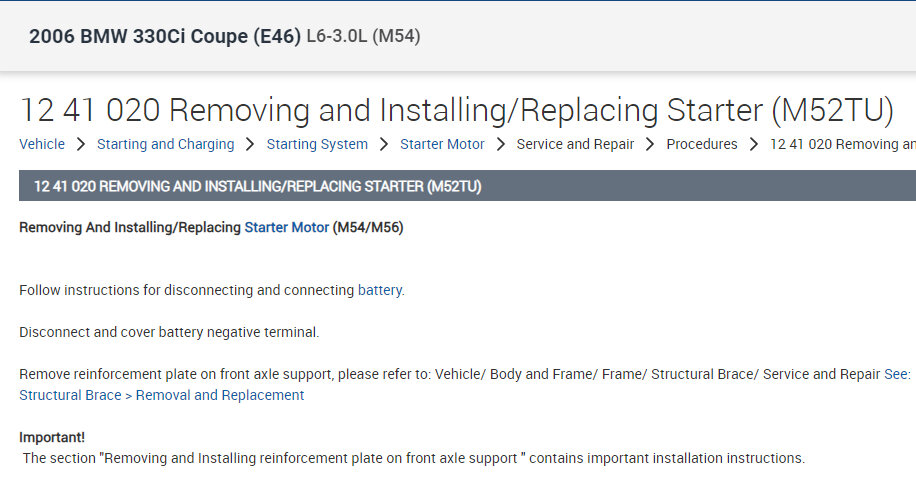

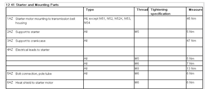

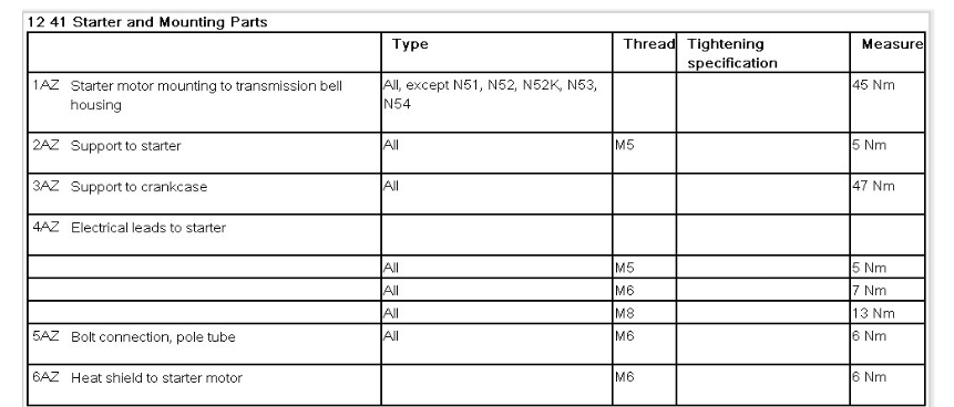

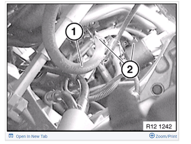

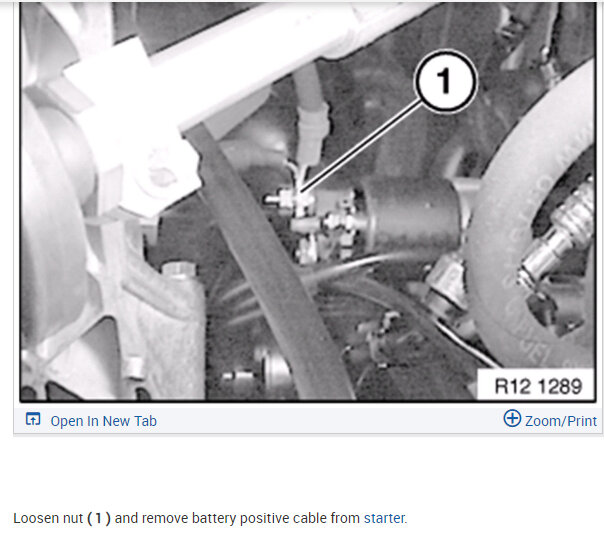

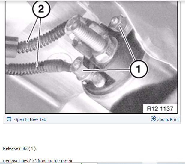

Regardless, I attached the directions below for replacing the starter motor. If you decide to replace it, make sure the battery is disconnected prior to starting the procedure.

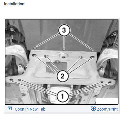

From which position does one remove the starter motor? From underneath the vehicle?
I have watched YouTube videos and all of them show removing a whole heap of stuff from the top of the engine like the inlet manifold and tons of hoses, sensors, fuel lines, etc. Your instructions have very few steps in comparison so just I'm asking whether this is done from underneath.

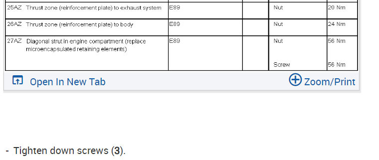

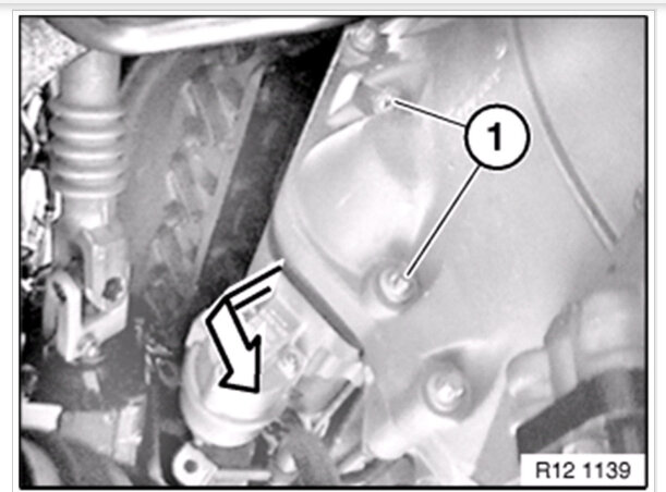

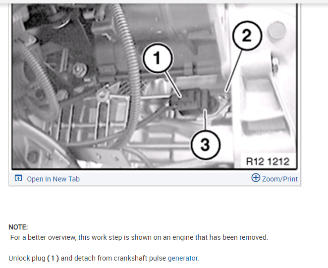

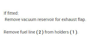

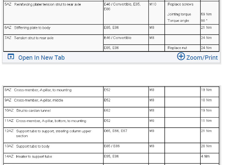

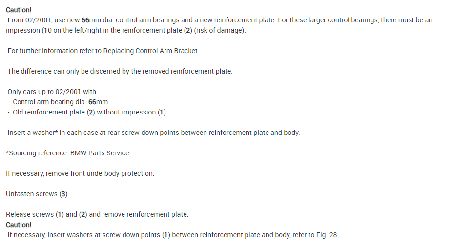

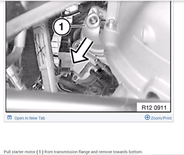

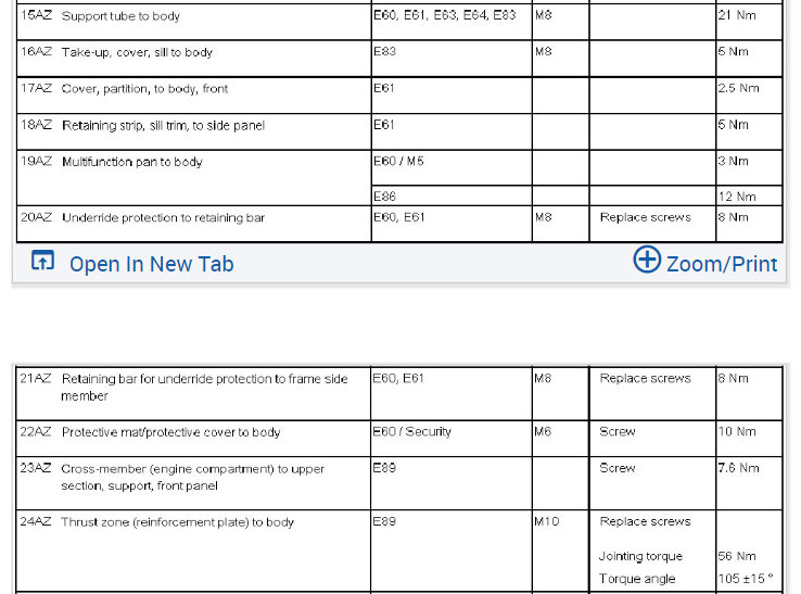

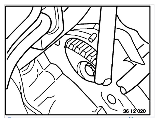

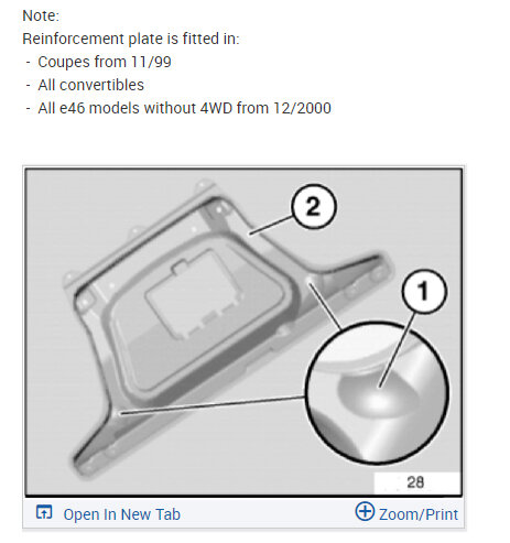

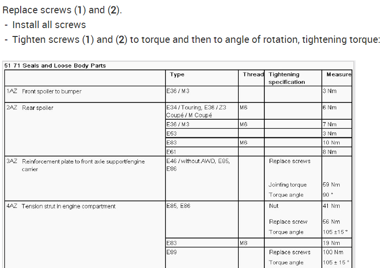

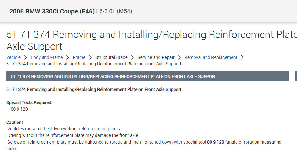

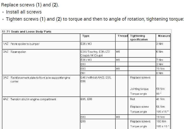

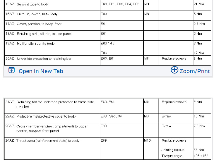

It sounds odd for sure. My first suspect is the starter motor. As far as replacing it, there is a support under the vehicle that needs to be removed.
I attached that information below for you. Let me know if you have questions.
