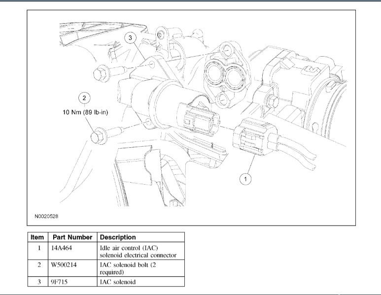

There is an idle air control motor that is responsible for maintaining the engine idle. It is a common failure for just this issue.
https://www.2carpros.com/articles/how-to-replace-an-idle-speed-control-motor-iac
Removal and Installation
1. Disconnect the battery ground cable.
2. Disconnect the idle air control (IAC) solenoid electrical connector.
3. Remove the 2 bolts and the IAC solenoid.
To install, tighten to 10 Nm (89 lb-in).
4. To install, reverse the removal procedure

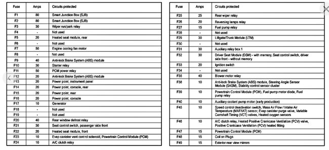

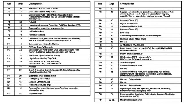

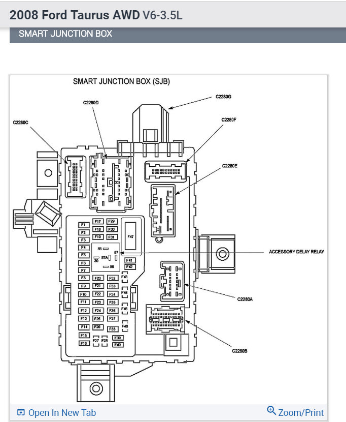

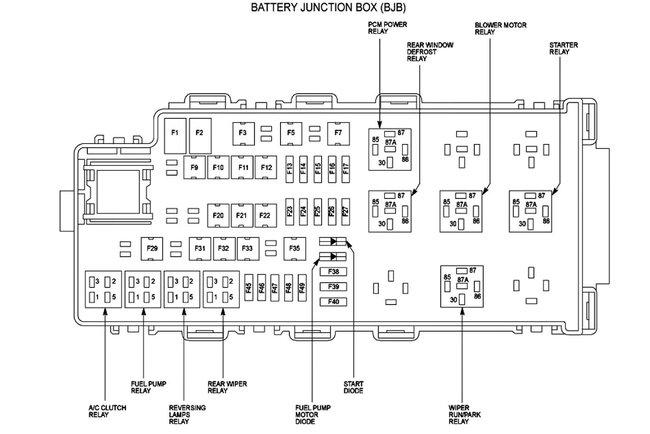

Let's check the fuses under the hood. This guide can help with the fuse location below.
Jun 8, 2021 at 7:09 AM
BIGEZ103
So I Googled the code and saw a video with the same problem and it was a blown fuse under the hood. I checked the fuse and found it blown. Replaced and it idles fine. I appreciate your time and recommendations. Thank you
