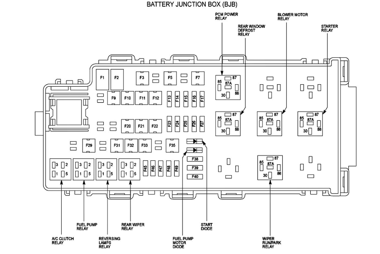

Car was driving fine then suddenly quit running in an intersection. Car starts fine but will not idle without giving it gas. Battery checked out but he said voltage was bouncing all around when he checked the alternator. Check engine light is on and the code was keep alive low voltage?

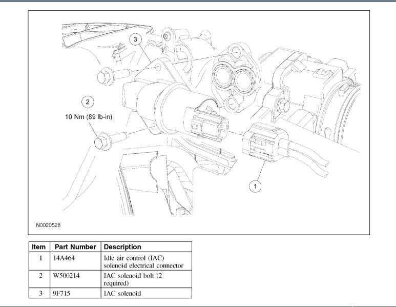

There is an idle air control motor that is responsible for maintaining the engine idle. It is a common failure for just this issue.
https://www.2carpros.com/articles/how-to-replace-an-idle-speed-control-motor-iac
Removal and Installation
1. Disconnect the battery ground cable.
2. Disconnect the idle air control (IAC) solenoid electrical connector.
3. Remove the 2 bolts and the IAC solenoid.
To install, tighten to 10 Nm (89 lb-in).
4. To install, reverse the removal procedure

The code is P1633.

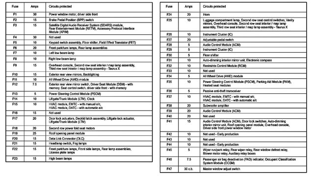

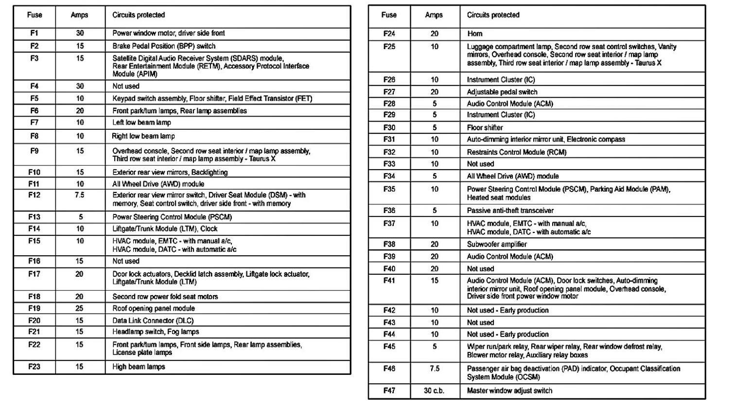

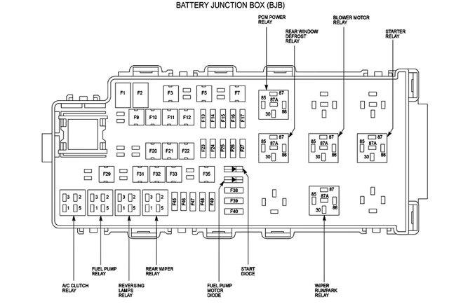

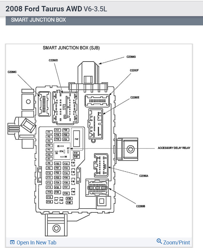

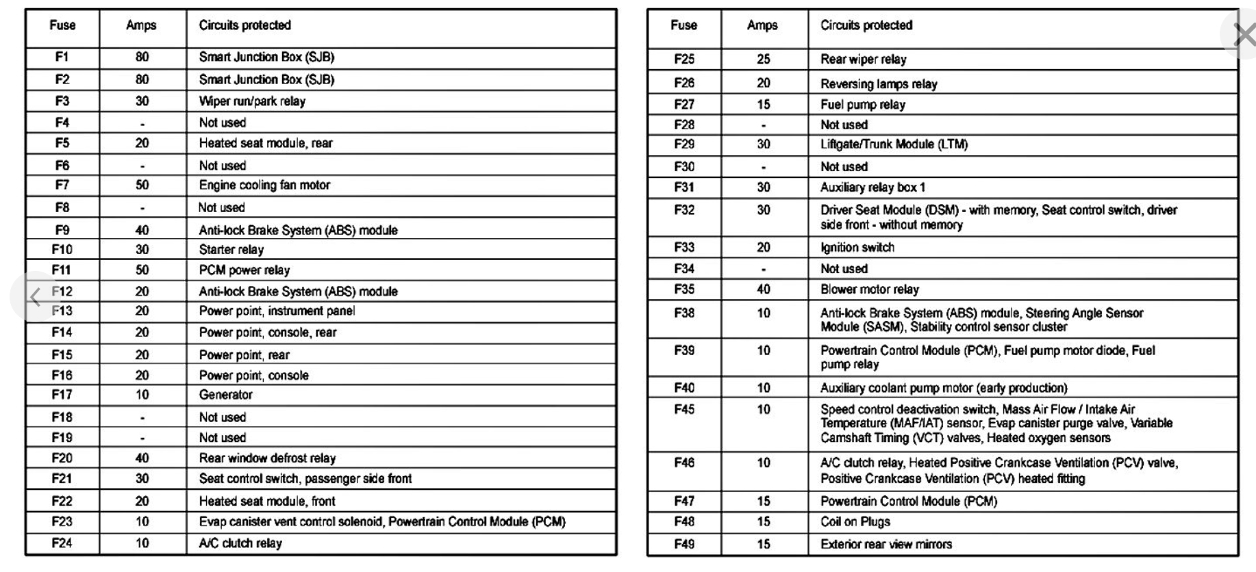

Let's check the fuses under the hood. This guide can help with the fuse location below.
Jun 8, 2021 at 7:09 AM
BIGEZ103
So I Googled the code and saw a video with the same problem and it was a blown fuse under the hood. I checked the fuse and found it blown. Replaced and it idles fine. I appreciate your time and recommendations. Thank you
