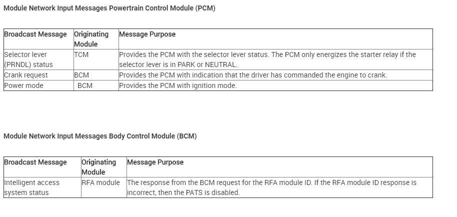

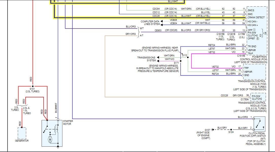

I replaced BCM and the car refused to start or even crank . It shows on the dashboard service engine and transmission now.
Feb 6, 2020 at 1:52 AM
Good morning,
Did it start prior to the replacement?
Did you have it programmed to your vin?
What are the codes that are set? You can have a parts store or get a reader and check the codes.

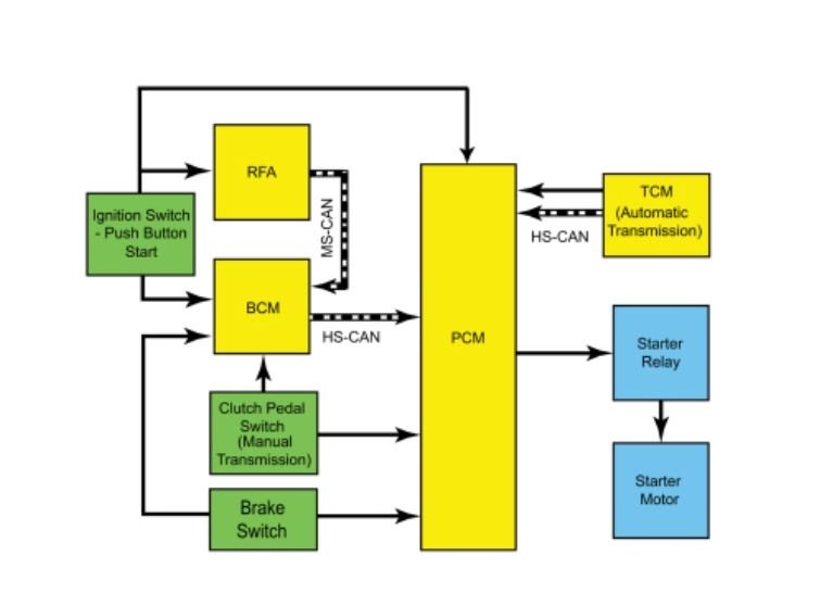

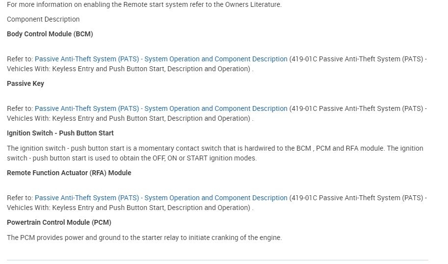

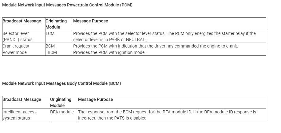

starting requires input from several modules before starting will be enabled. That is why I asked if you had the BCM programmed.
Feb 6, 2020 at 7:00 AM
ALI MOHAMMED BUKAR
No, it has not been programmed to the VIN.
Feb 6, 2020 at 10:32 AM
That is where I would start. You need someone with the scan tool and access to the factory technical information to download the module.
