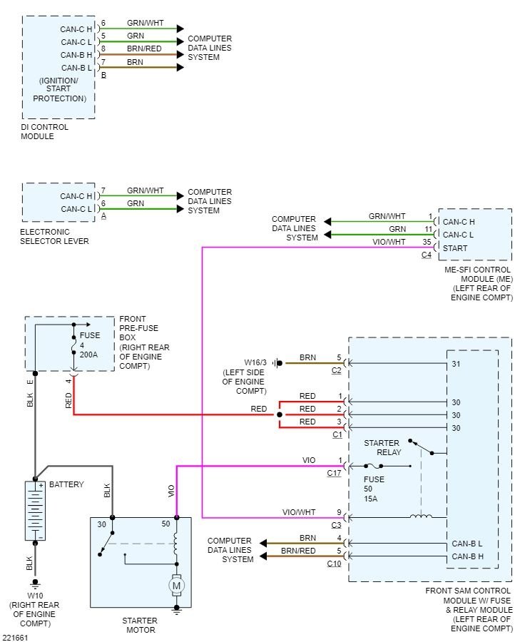

Okay, Does the security light come on and go out when you turn the key? Mercedes systems usually include intrusion detectors that can trip the system, the breaking glass may have triggered that and shut the starting system off. For that you will need a good scan tool to access and disarm it if that is the case.

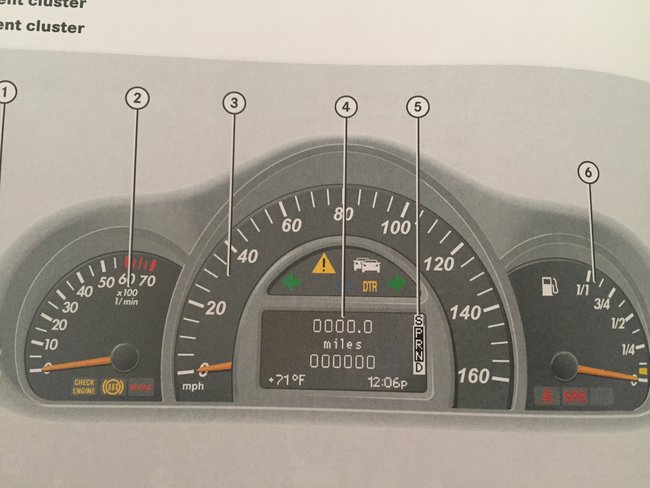

Sir, on my instrument cluster does not show any security light.The following is the image of my dashboard when I turn the key.
Jul 10, 2019 at 8:32 PM
STEVE W.
  • 15,421 POSTS
HMM, usually it will show a message if there is a problem, as it doesn't then it may not be security related. When you replaced the sunroof, which parts did you replace? There is a control module for it that has data lines for the computer, if those wires were damaged it could tie up the computer and cause a no-start. To verify that it isn't something in the starter circuit a simple test would be to jump battery voltage to the 50 amp fuse. One side powers the starter on when it gets battery voltage. If you use a heavy wire and jump the fuse terminal to the battery the started should engage, that would verify it isn't on that side of the system. From there you would need to use a Mercedes scan tool to test the network and verify what parts of the system are working.

Okay, that shouldn't have caused any problem. However it could be in the wiring, although you said that when you were done the car started. I would try the test I listed above first. That would verify that the starter, battery and that part of the system is good. It won't hurt to verify the wiring though. Also if you have any different keys or fobs try those.

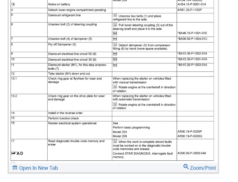

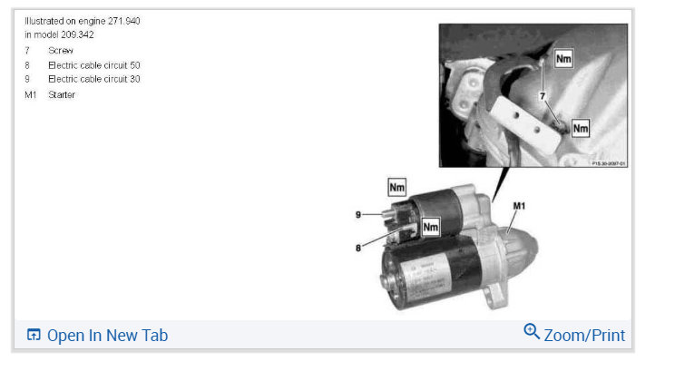

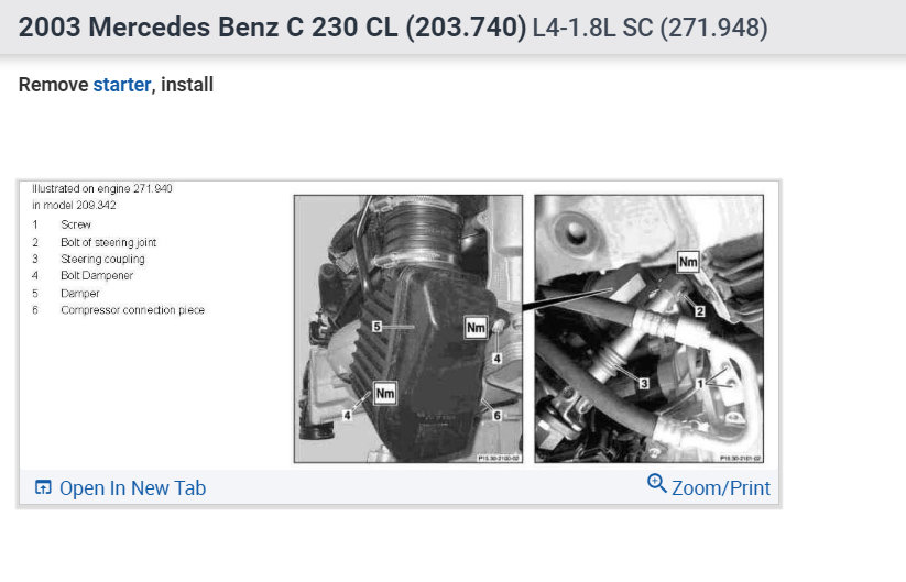

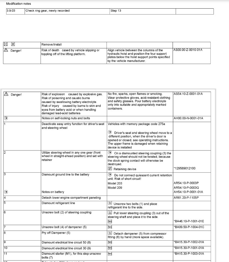

I had this problem with my wife's car it was the starter motor. Here is a guide to walk you through the steps and diagrams below to show you how to change it out:

Hi, I received a call today from the dealer saying that the starter motor has to be changed.Please can you help me with that.
Jul 22, 2019 at 3:50 AM
  • 55,797 POSTS
Thanks for letting us know what happened. I show you how to change the starter out in my first post. Please let us know if you need anything else to get the problem fixed.
