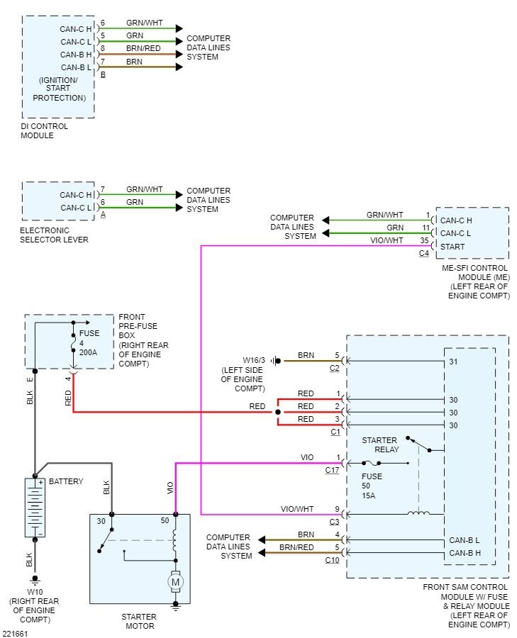

HMM, usually it will show a message if there is a problem, as it doesn't then it may not be security related. When you replaced the sunroof, which parts did you replace? There is a control module for it that has data lines for the computer, if those wires were damaged it could tie up the computer and cause a no-start. To verify that it isn't something in the starter circuit a simple test would be to jump battery voltage to the 50 amp fuse. One side powers the starter on when it gets battery voltage. If you use a heavy wire and jump the fuse terminal to the battery the started should engage, that would verify it isn't on that side of the system. From there you would need to use a Mercedes scan tool to test the network and verify what parts of the system are working.

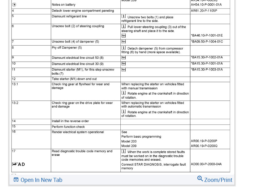

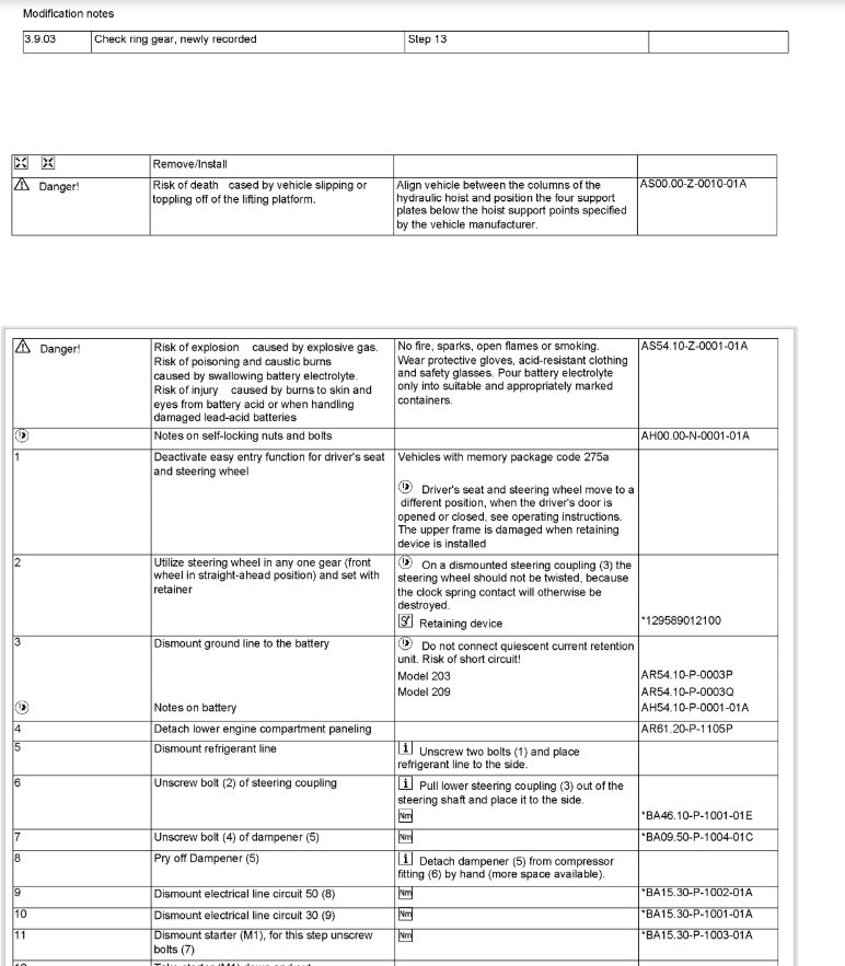

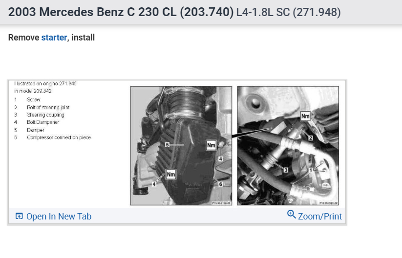

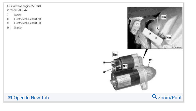

I had this problem with my wife's car it was the starter motor. Here is a guide to walk you through the steps and diagrams below to show you how to change it out:

Hi, I received a call today from the dealer saying that the starter motor has to be changed.Please can you help me with that.
Jul 22, 2019 at 3:50 AM
  • 55,433 POSTS
Thanks for letting us know what happened. I show you how to change the starter out in my first post. Please let us know if you need anything else to get the problem fixed.
