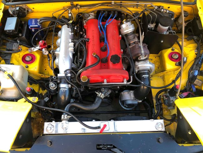

Turbo has poor idle on startup, but will usually clear up after a couple minutes of idling. Will occasionally shut off upon coming to a stop, but will start back up after pumping gas pedal.

Engine bay.

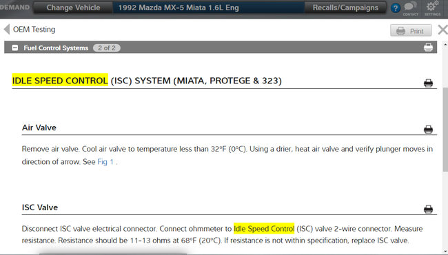

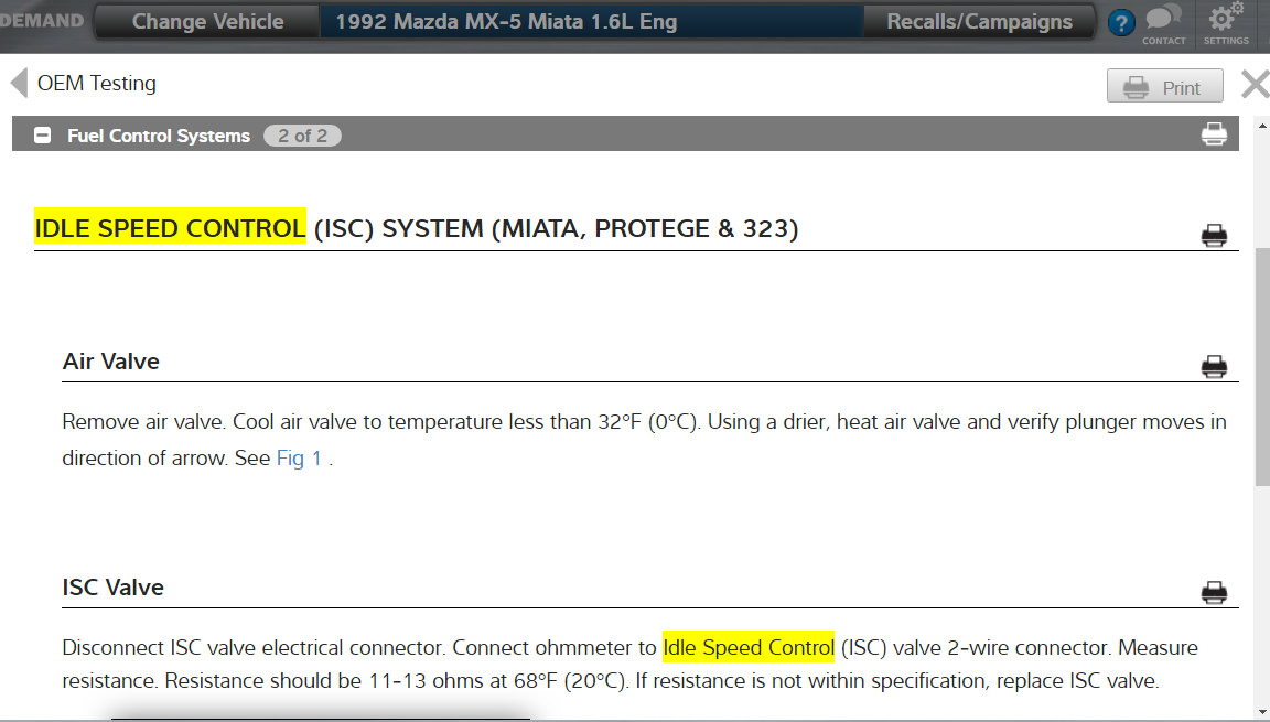

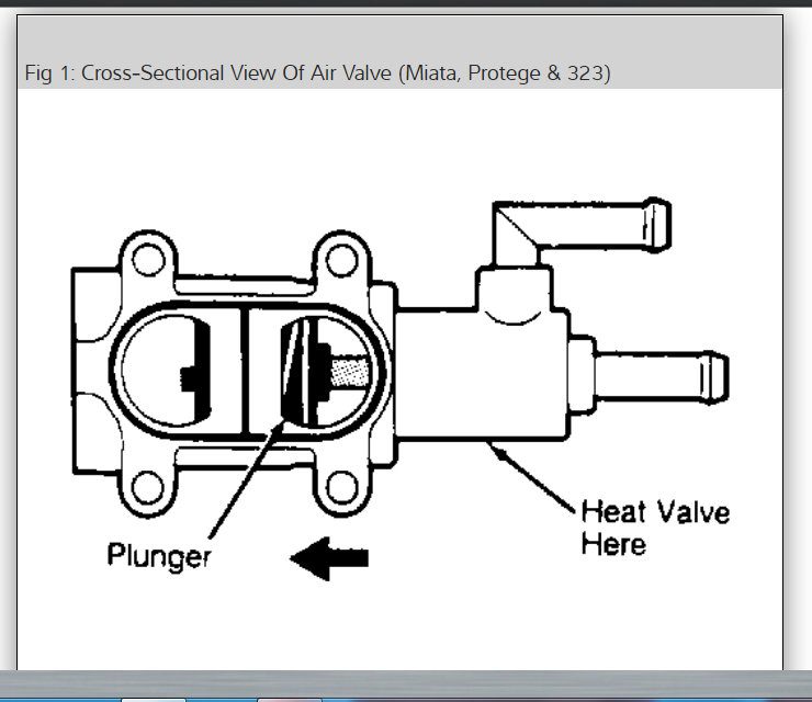

Very nice. This could be a problem with your vehicle's Idle Air Control Valve (IAC). In the diagrams down below I have included troubleshooting directions for the IAC for your vehicle. Please go through the guide and get back to us with what you are able to find out.

Alright, I'll try that in the morning.
