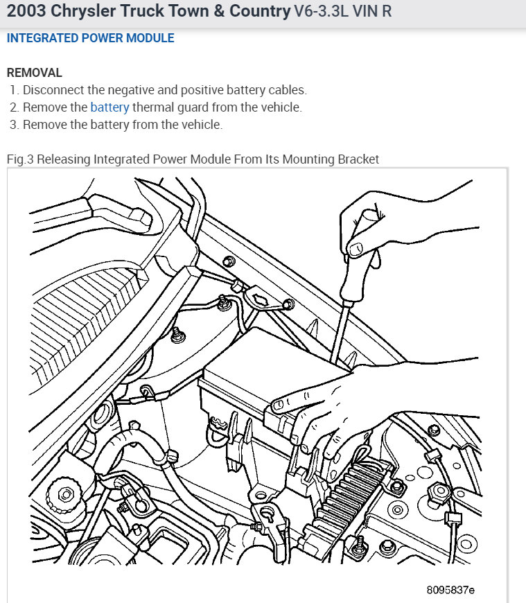

Shuts off while driving and sometimes after idling for several minutes?
2003 CHRYSLER TOWN AND COUNTRY
251,000 MILES • 2WD • AUTOMATIC
GERRY WARD
Will not turn back on for 15 to 20 minutes, there is no clicking or sound when attempting to ignite. When sufficient time has passed it starts with no problem. There is no check engine light, but the check engine light has been coming on and going off occasionally for the last few weeks, not flashing.
Oct 3, 2023 at 2:53 AM
  • 55,456 POSTS

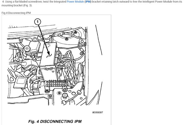

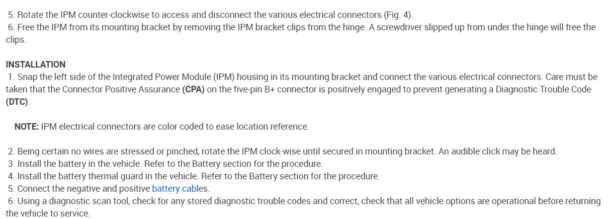

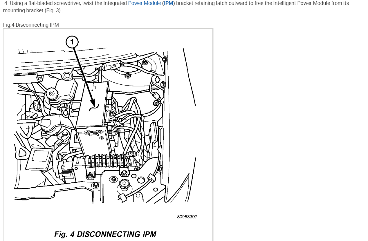

We should run the codes to see what codes are stored, this guide can help:
To me it sounds like the IPM has gone out which is super common for these vehicles. It is easy to replace because it-self learns and no programming is needed. Here is the location of the IPM and how to replace it. Check out the images (below). Please let us know what happens.
Oct 3, 2023 at 4:40 AM
