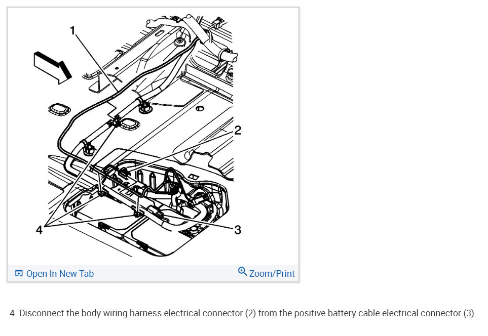

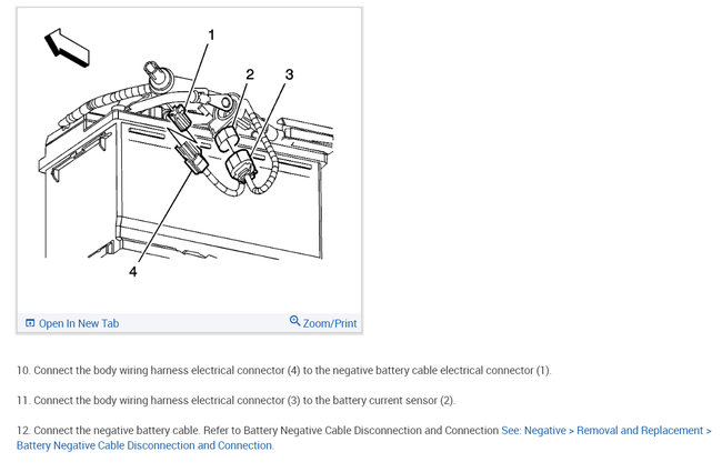

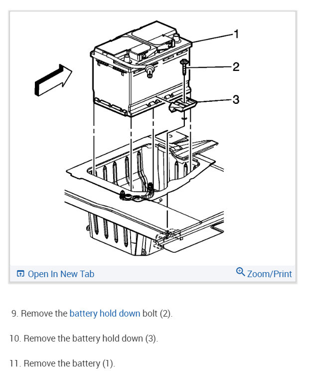

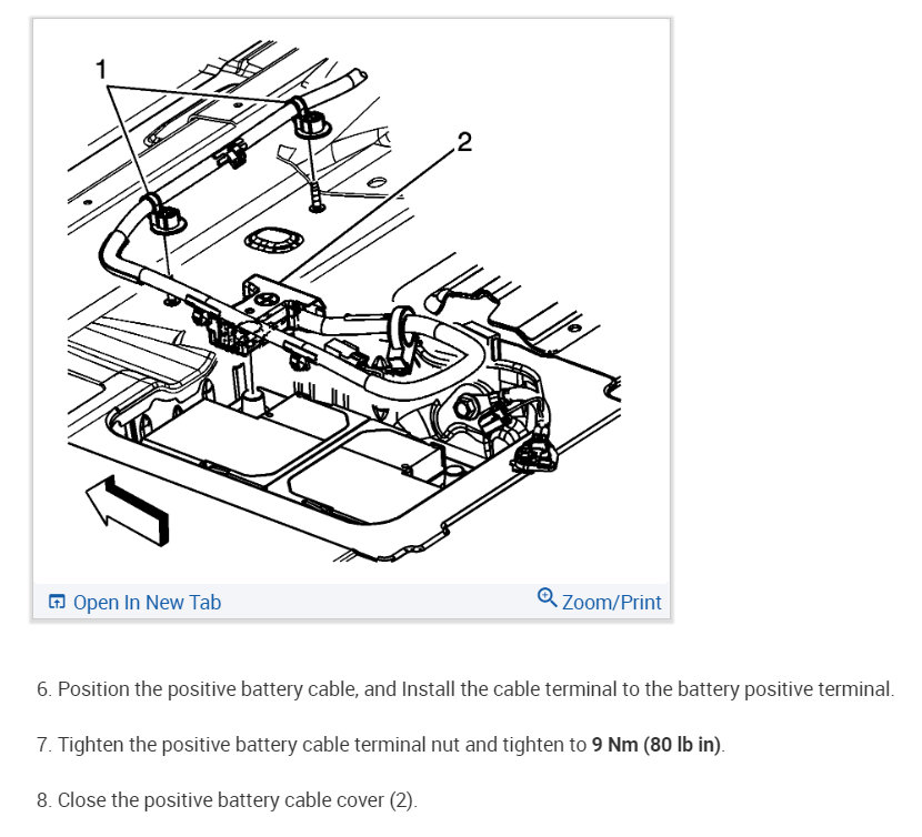

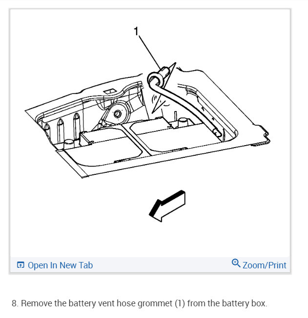

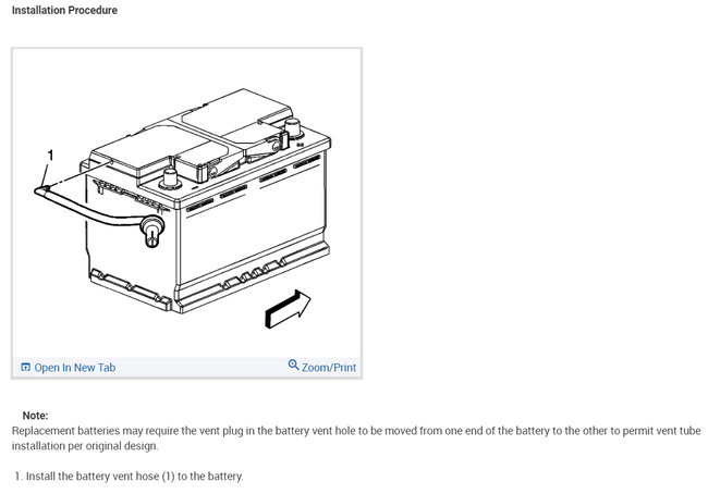

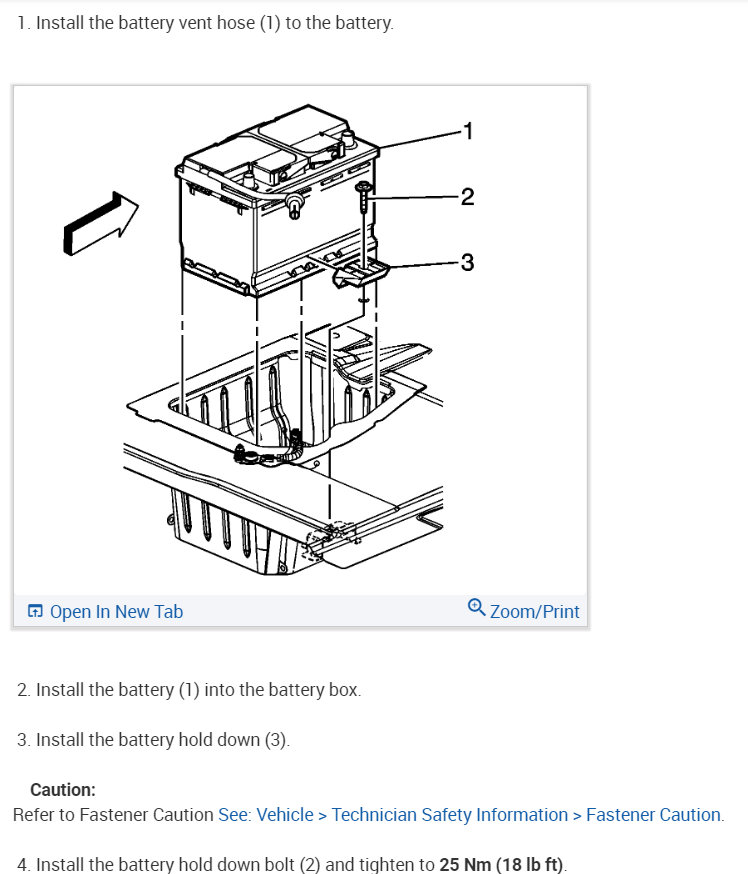

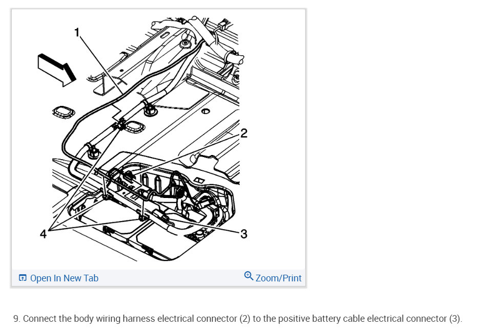

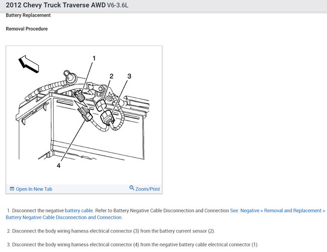

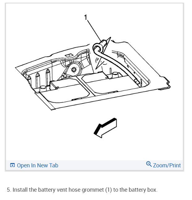

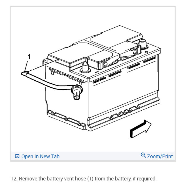

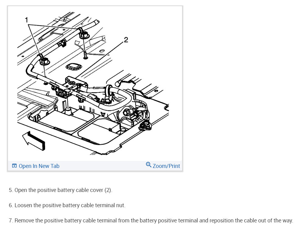

It sounds like the battery shorted out inside, try turning the headlights on, if dim or out replace the battery with a new unit. here is a guide to help walk you through the steps and diagrams and instructions below to show you how on your car. When a battery goes bad like that a jump will not help it.
https://www.2carpros.com/articles/how-to-replace-a-car-battery
Try to get an AC Delco replacement battery. Check out the diagrams (below). Please let us know what happens.
