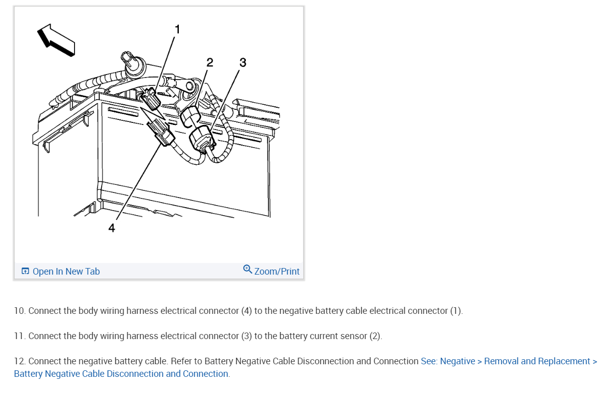

The car shut off while driving down the road. tried to restart it and all electric went out. Turn switch to off then tried to restart again, same result. I got a jump when I hit the ignition the starter engaged and kept turning even after I released the key for a second or two. Didn't start. Towed home waited a few hours went out try to start again it fired up but wasn't running on all cylinders and it was tapping real bad. shut it off waiting for some advice.

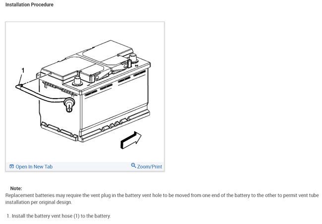

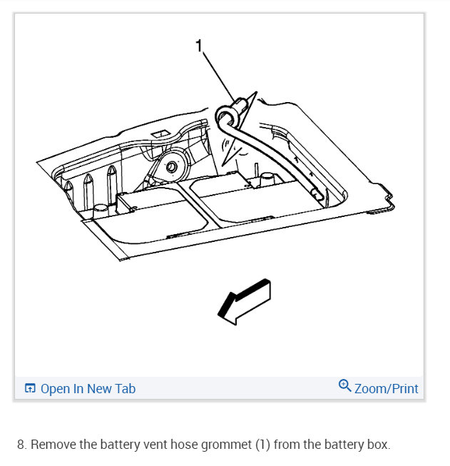

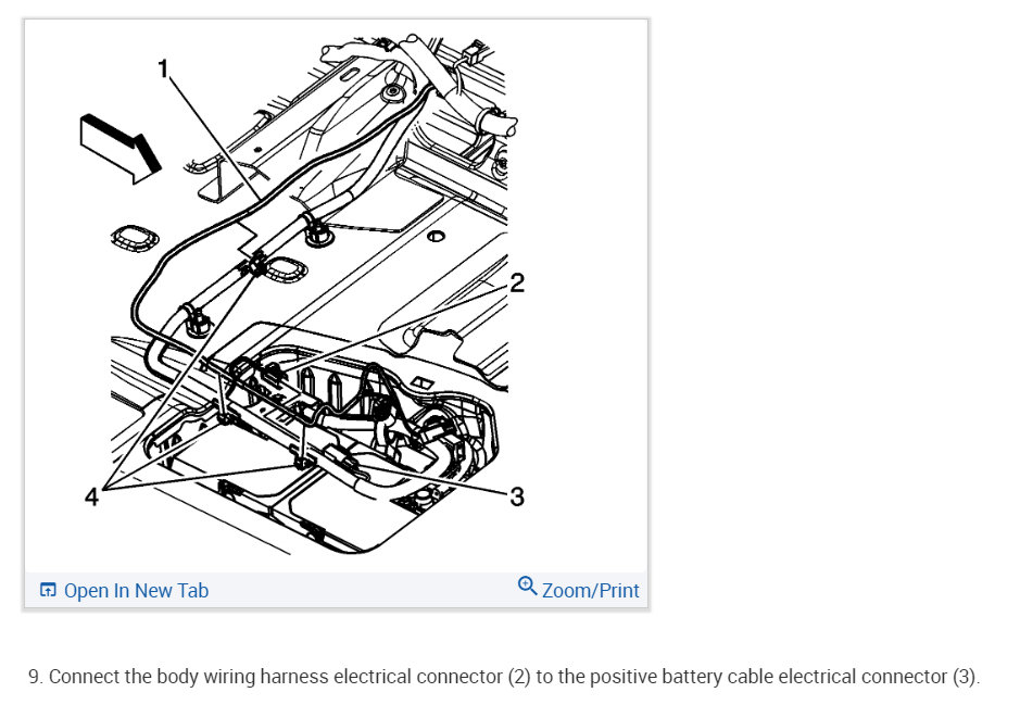

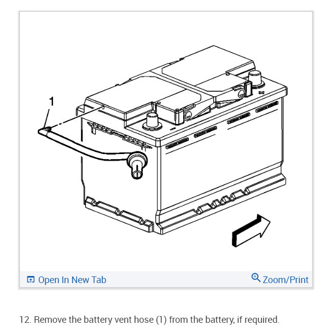

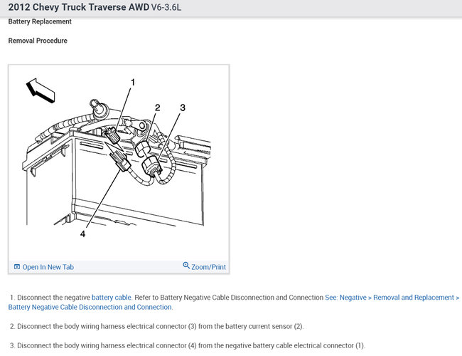

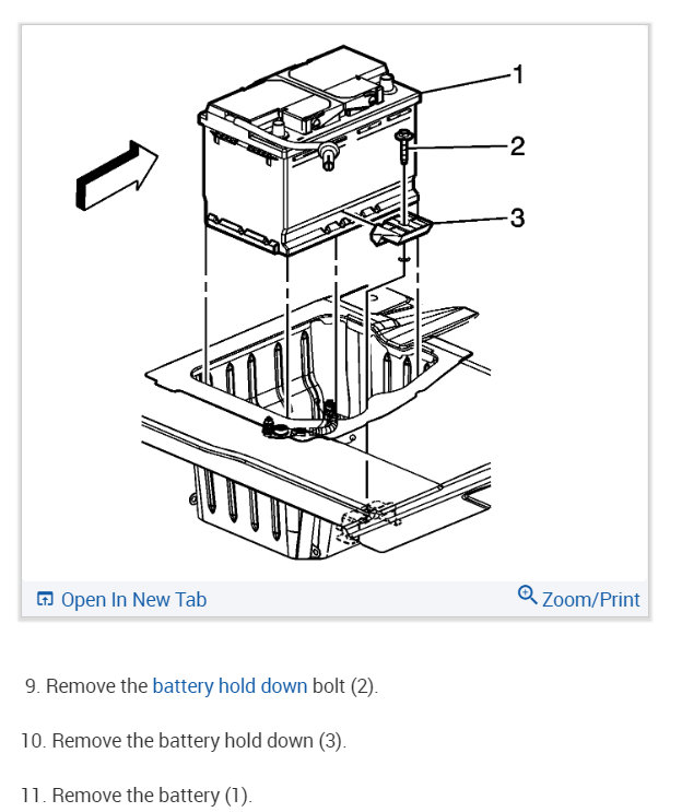

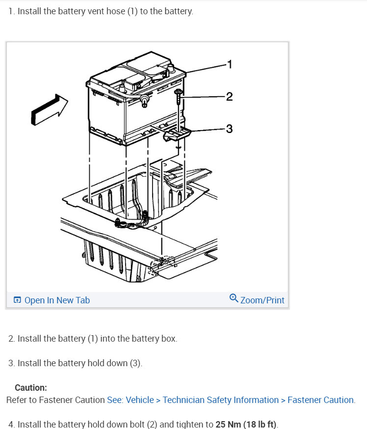

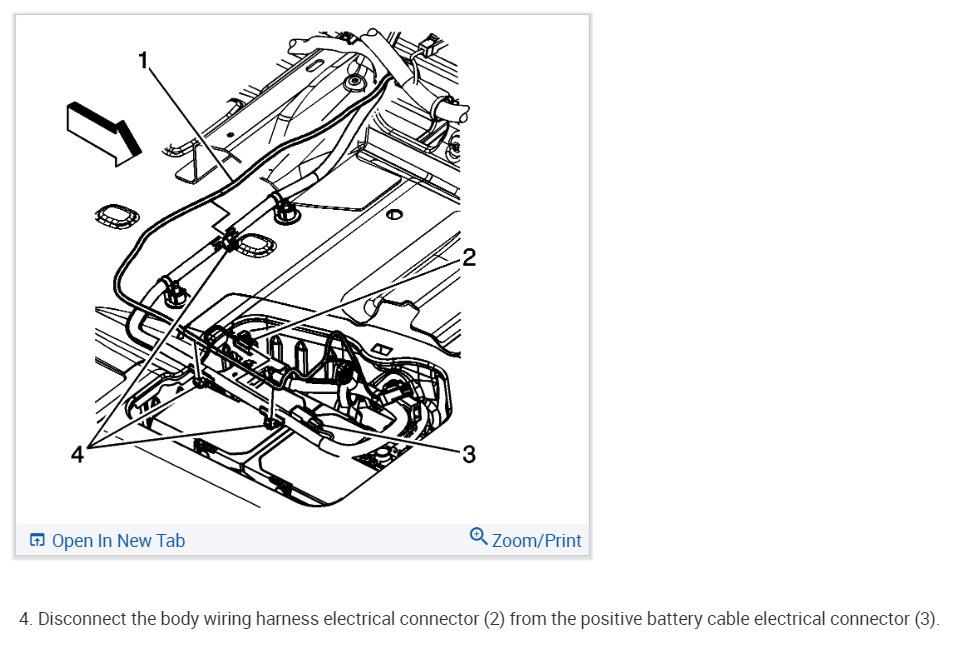

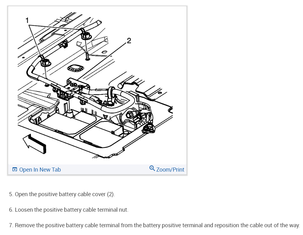

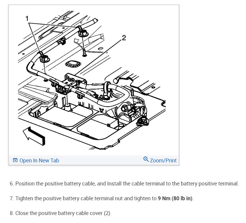

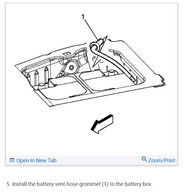

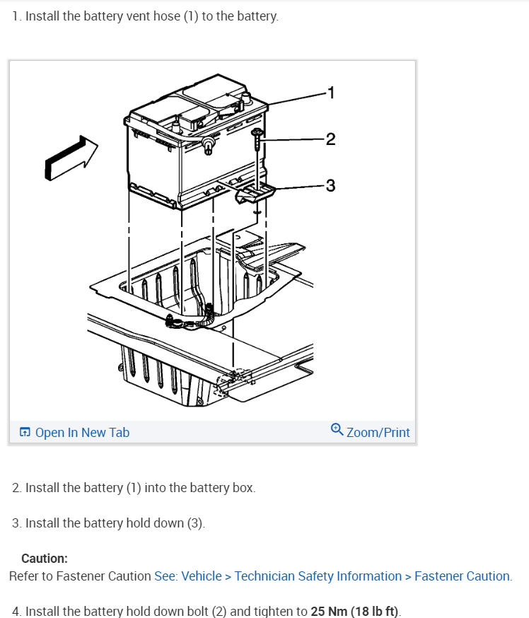

It sounds like the battery shorted out inside, try turning the headlights on, if dim or out replace the battery with a new unit. here is a guide to help walk you through the steps and diagrams and instructions below to show you how on your car. When a battery goes bad like that a jump will not help it.
https://www.2carpros.com/articles/how-to-replace-a-car-battery
Try to get an AC Delco replacement battery. Check out the diagrams (below). Please let us know what happens.

I replaced the battery yesterday, it cranks over fine but it won't start. I plugged in a code reader it doesn't have any codes.
